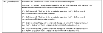

This seems reasonable. From the manual it sounds possible that the modem may be hijacking and redirecting all DNS requests.

If you're needing tricks to bring up the menu, it's likely that the router doesn't fully support the static dns even if you do set it (potentially custom firmware from ISP in place). There is a good chance it is still operating in its default "DNS Proxy" mode, but using your Pi-hole as the destination. All requests from your Pi-hole would then go in a loop.
