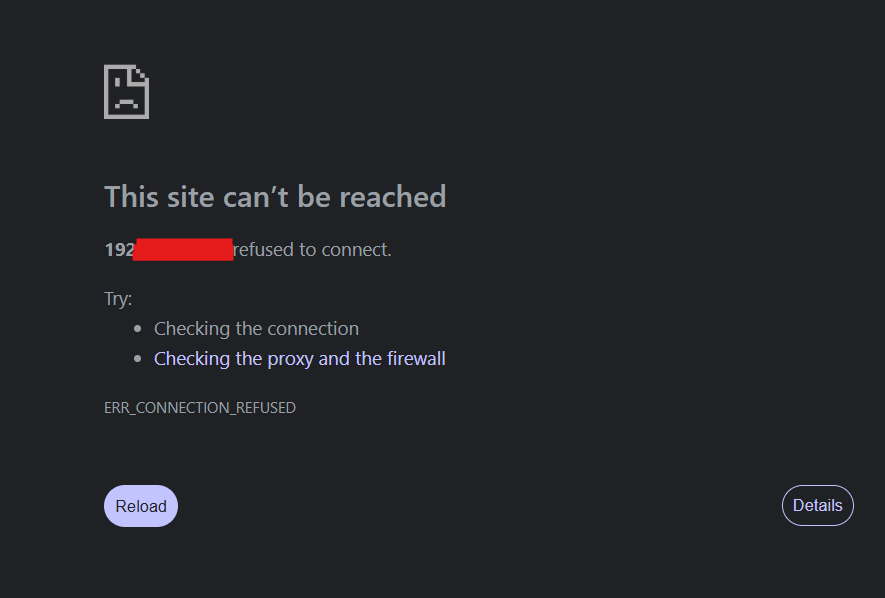

I cant seem to log into pihole, I keep getting:
This site can’t be reached
192.xxx.x.xxx refused to connect.
Try:
Checking the connection
Checking the proxy and the firewall
ERR_CONNECTION_REFUSED

I open a browser and type the url http://192.xxx.x.xxx:8080/admin and then I get this page and I don't know how to fix it. Can anyone help?
Your container doesn't seem to have DNS resolution.
Let's try to fix that adding dns: option to your compose file:
services:
  pihole:
    container_name: pihole
    image: pihole/pihole:latest
    dns: 8.8.8.8  # Set the container DNS. This is different Pi-hole Upstream server option
    ports:
Then, generate a debug log executing the following command on the Ugreen NAS terminal:
docker exec -it pihole pihole -d
When asked to upload, answer Y, then copy the Token and post it here.
