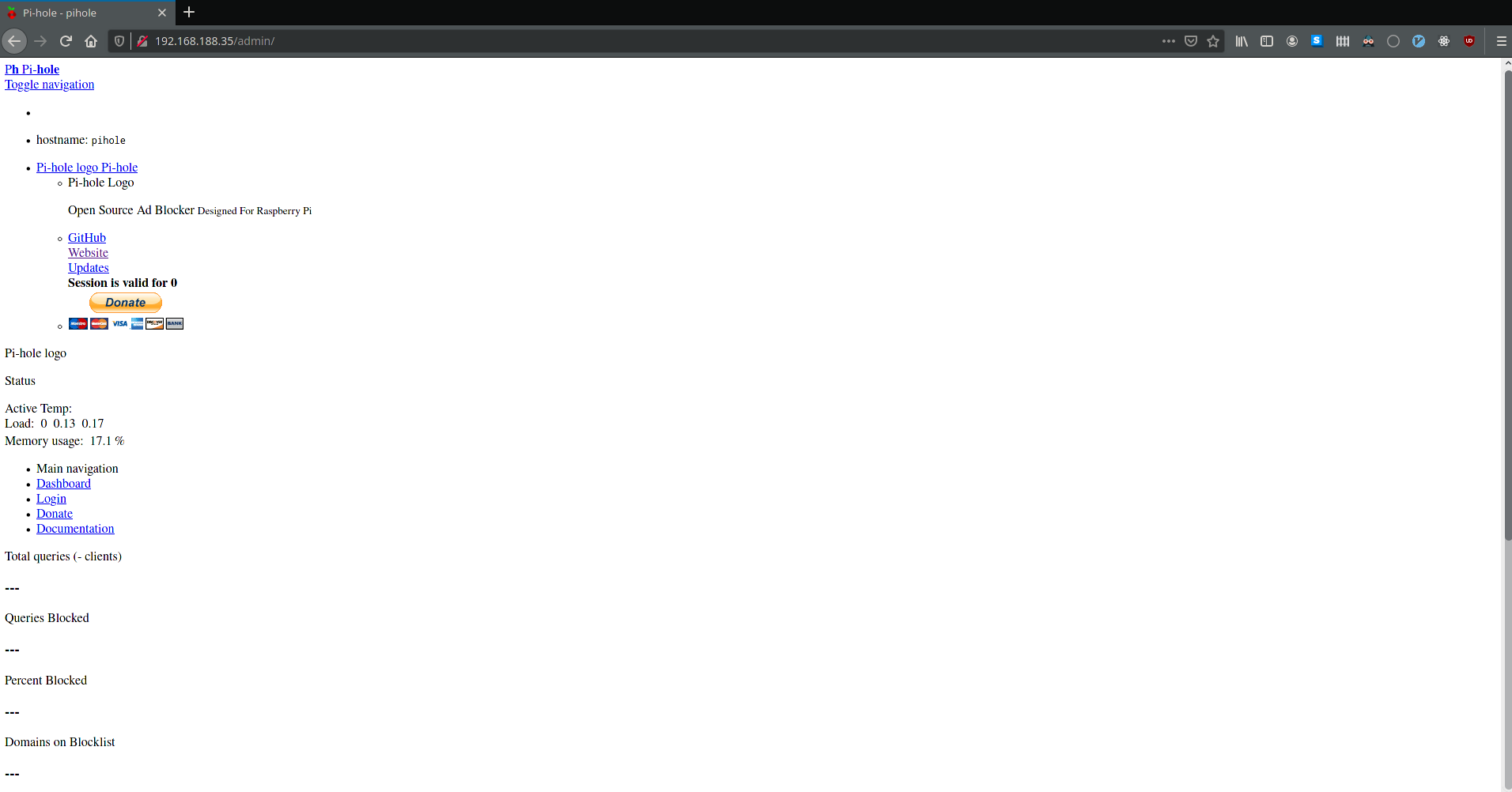

fresh install on pi 3b. Everything installed correctly. add blocking is working. web interface loads and I would expect to see the standard admin dashboard. This did occur when booted into the graphical session of the PI itself.
but anywhere else on the network the web interface loads, but shows no styling or other content:

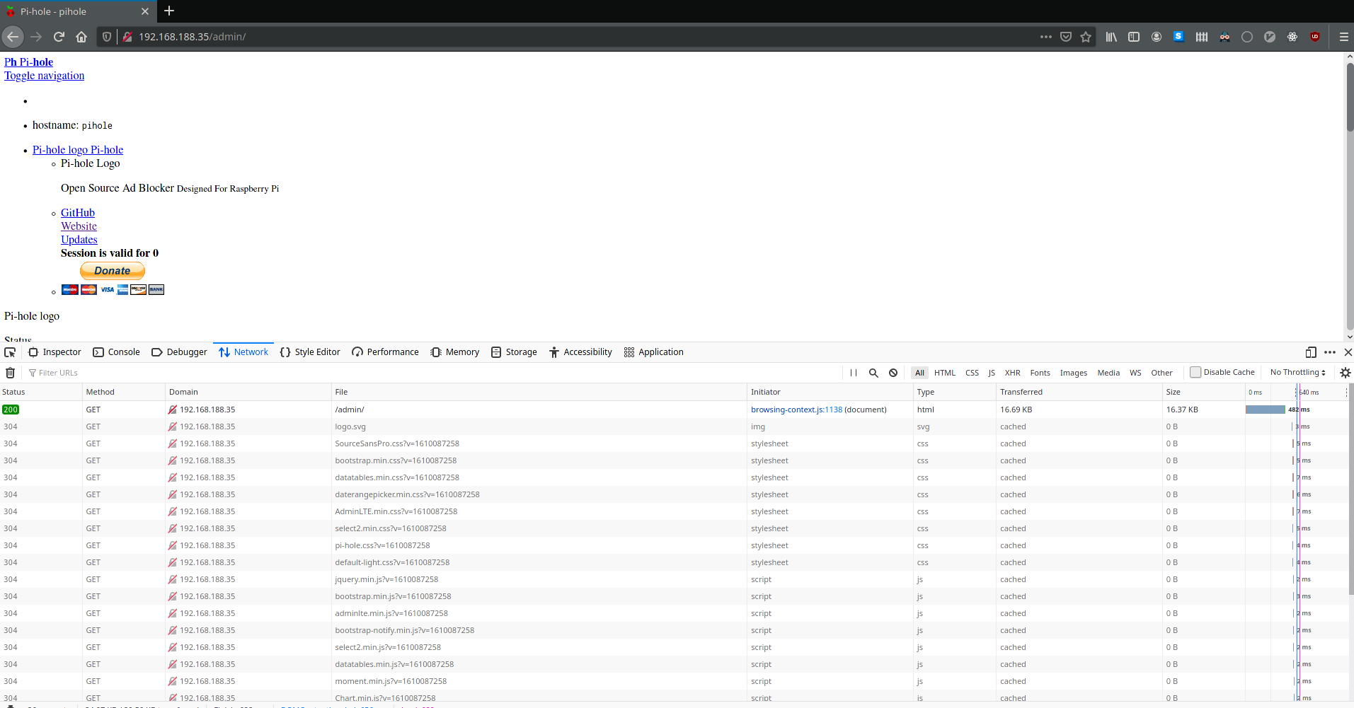

The only thing that I think is out of the ordinary is all the assets are getting a 304 on request, but I have no idea where they would be cached from.

Your debug log suggests a very different configuration:
Pi-hole is not your DHCP server, as it is not offering a DHCP lease - instead, your router is still acting as DHCP server, and it is still distributing its own IP as DNS server.
   * Received 548 bytes from eth0:192.168.188.1
     DHCP options:
      Message type: DHCPOFFER (2)
      server-identifier: 192.168.188.1
      lease-time: 864000 ( 10d )
      router: 192.168.188.1
      dns-server: 192.168.188.1
      --- end of options ---
If your clients aren't using Pi-hole as DNS server, they won't be able to succesfully resolve pi.hole as a hostname.
You may have configured Pi-hole as your router's upstream DNS server (an Internet section setting in a FritzBox). It would be preferable to configure your FB to distribute Pi-hole as local DNS server via DHCP (a Home Network section setting).
