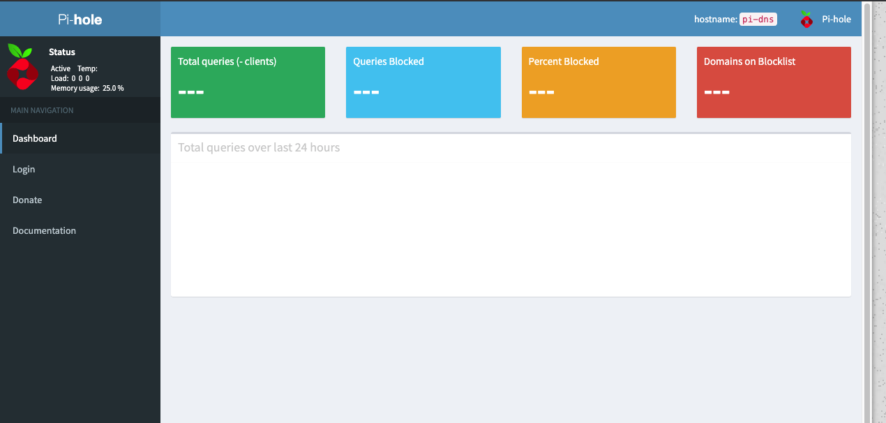

Web interface does not work on clean buster install Mac OS various browsers
This is a clean install on a new buster and new pi-hole
web interface shows stats.
what I see is similar to

What OS and browser are you using to view the web admin interface? Please post a screen shot of what you see in the web admin interface from this browser (not the web inspector part).
I have tried this on Mac Firefox, safari, and Chrome (where the debugger was running). The image was identical to the older post I cited

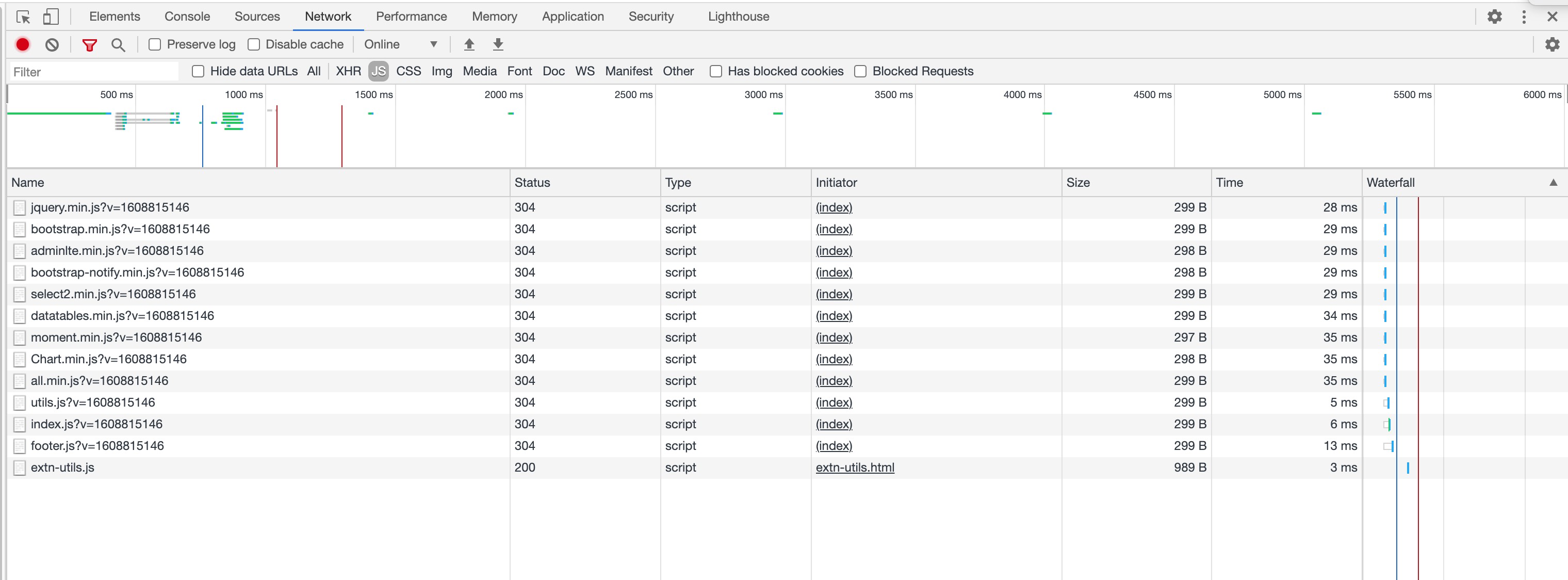

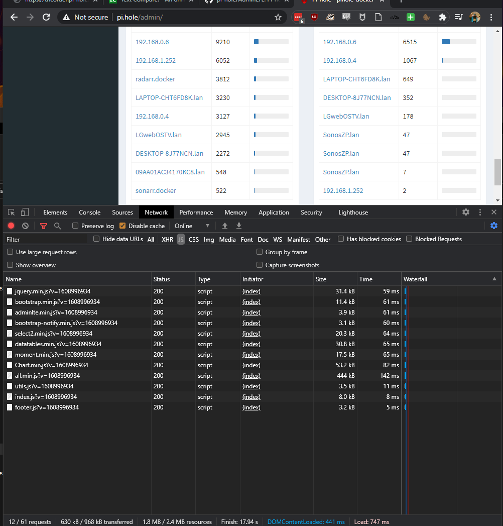

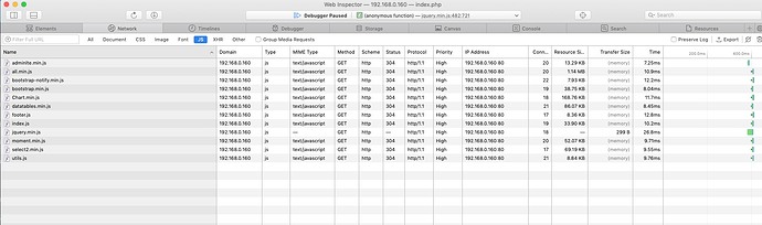

What does your network tab look like in chrome devtools with cache disabled and JS selected (per my screenshot)

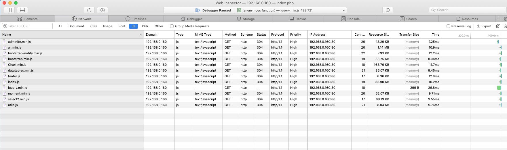

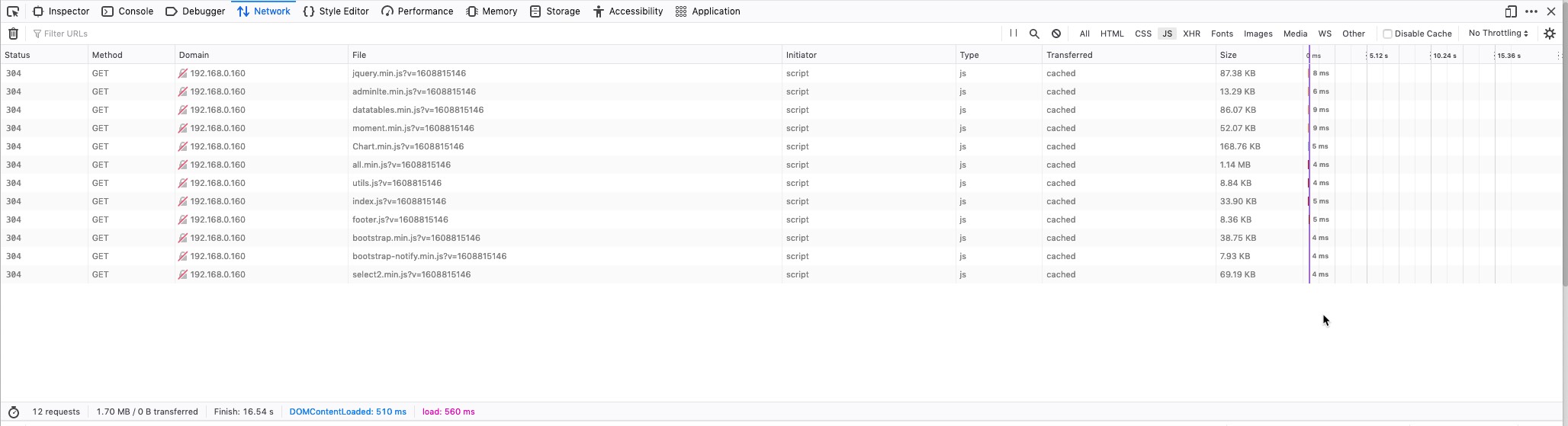

For comparison only, MacOS Mojave (I don't have problems on either Catalina or Big Sur, I just happen to be sitting at this Mac with Mojave):
Firefox latest:
Safari latest:
Chrome latest:

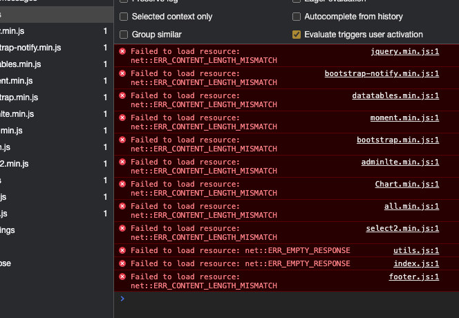

in the chrome debugger I get fails on several of the files.
I now suspect there is some interaction with the virus software on the system (however I run Norton on both the PC and mac). I need to go offline to research that.
