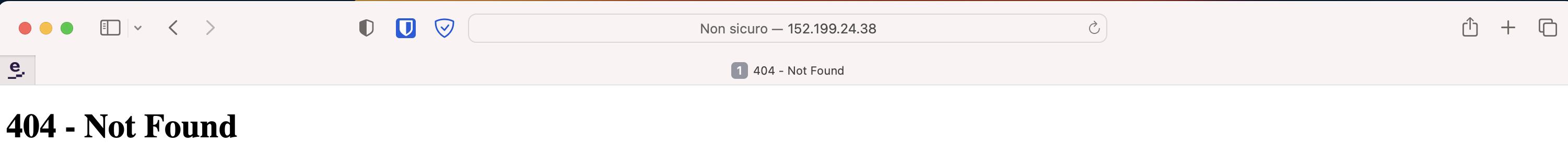

But even on the browser web in my pc the IP results in 404 :
But it answers to wget:

Same ip, same port, same everything else

indeed it seems to be dumb error, possibly typo somewhere...
try running unbound-anchor with -F flag and see if it helps.
regards,
r.
