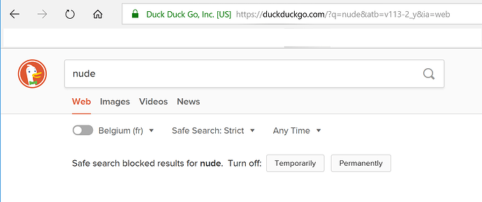

I use edge, just typed 'nude' in the address bar, this is the result:
I have no idea how to remove the possibility to turn off the option to disable the safe search. Anybody?

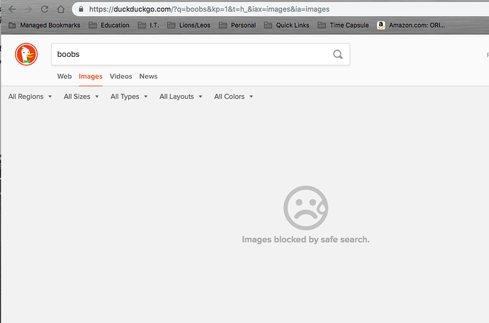

And when I try to turn safesearch off, it stays on! DuckDuckGo must have recently added this functionality as it did not work earlier this year (May/June)
You will never see it using forcesafesearch.google.com or safe.duckduckgo.com in the web browser, DNS does that behind the scenes. That is because it is a CNAME record. I may have mislead you, I attempted to to it in May/June but it did not work. Now it does work. This has been an open feature request with duckduckgo for some time now.
As you can see below, it is working for me:
