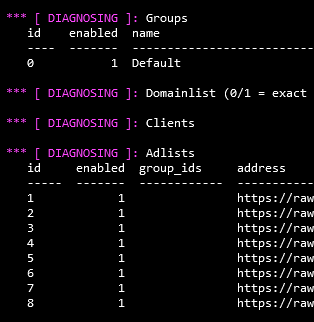

https://tricorder.pi-hole.net/db6YOT2x/
Your lists are not assigned to any groups. This means Pi-hole is not using them and nothing will be blocked.
The group_ids column is empty:

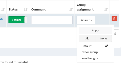

Every list should be assigned to at least one group if you want to use them. You only have one group (Default - ID=0).
On the web interface, go to Lists page and assign each list to Default group:
Thank you so much. this has completely fixed my problem! When I added the lists, i chose the Group Assignment to "Default" group, not sure why it didnt assign after clicking "Add Blocklist".
