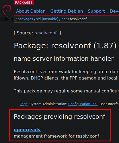

Plain Debian (jessie to sid) uses openresolv: Debian -- Details of package resolvconf in sid
Does Raspbian/DietPi really use something else? If so, do you know where the source code is?
Maybe this one?
https://salsa.debian.org/debian/resolvconf/-/blob/master/bin/resolvconf

You misinterprete what the "Packages providing" on Debian package pages means:
  • The resolvconf package is an own package with own source, see the "Source: resolvconf" link at the top of the page.
  • The dedicated openresolv package has a "Provides: resolvconf" entry in its control file, which means that packages which depend on resolvconf (have a "Depends: resolvconf" entry on their control file) are satisfied as well when openresolv is installed instead.
  • The packages listed at the Debian pages as "Packages providing" are hence additional/alternative packages that can be installed to satisfy the same dependency.
So there are dedicated sources, and they are identical on Debian, Raspbian, hence DietPi and Ubuntu. I'll have a look.
EDIT: Salsa is Debian's Gitlab instance, so those sources are probably correct, but not necessarily. Often I see packages released which do not match any of the branches there. Theoretically the "Vcs-*" entry on the control file should tell, but that isn't always correct either. But the package web page has original source and Debian patches+controls linked as tarballs.
EDIT2: I checked the resolvconf sources linked at the Buster suite package page, which match exactly the debian/1.79 branch on Salsa.
And grep -r 'unbound' has as only results the README where it is mentioned to support resolvconf, and a changelog entry about this README entry, so it's a behaviour dedicated to openresolv :slightly_smiling_face:.
So apt install resolvconf should hence solve the issue, while I cannot say something about other impacts. Basically both implementations do the same, but openresolv tries to do some more magic, not only with Unbound but with e.g. dnsmasq as well, as it has a dedicated file to handle it. From the filelist:
