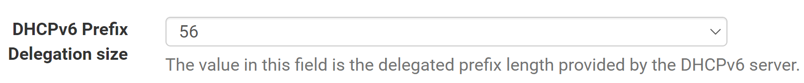

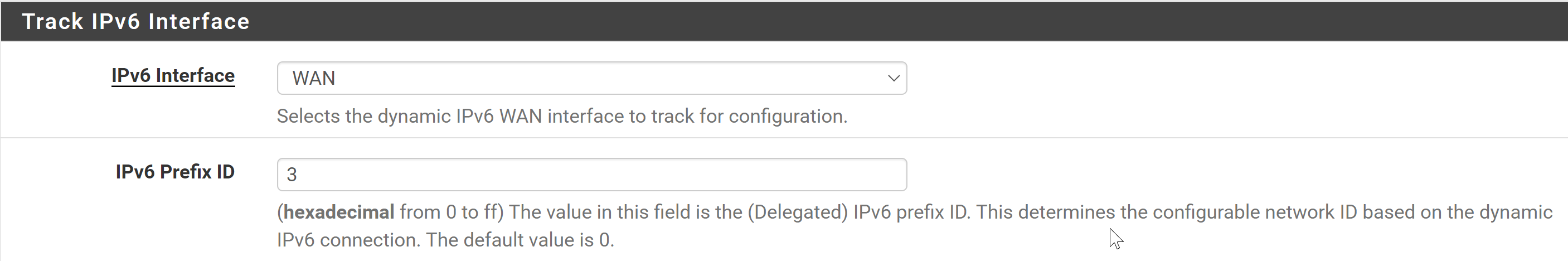

  • IPv6 addresses GUA are distributed in the network, using pfsense 'track interface'.
on the WAN interface:
on the LAN interface
  • The IPv6 addresses on the devices never change, unless the ISP kicks the modem, in which case the WAN IPv6 changes, thus all tracked addresses (if the prefix changes).

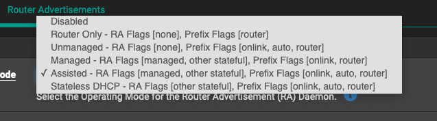

The one set in pfsense for that device was my idea. But to be true, I'm not sure if it will then stop respecting RAs or simply have one IPv6 address more :thinking:. I'm also not 100% familiar with IPv6.
Basically there are min tree types of addresses assigned: the MAC-based autoconfigured SLAAC addresses, the ULAs (unique local addresses), advertised by the router and the GUAs (global unicast addresses), also advertised by the router, required if you want to access a device within LAN from www without NAT. And in theory there is DHCPv6, which is rarely used. For a usual home network, IPv4 is totally sufficient and an IPv6 address on each client only required for them to connect to remote IPv6 hosts. For that SLAAC is sufficient and can be used as well to connect via IPv6 to LAN clients. SLAAC is always used immediately by every network adapter/interface where IPv6 is enabled, no router or anything else needs to trigger that. So in your case, choosing "Disabled" should be fine and reduce a bit overhead and a bit more possible confusion in your home network :slight_smile:.
EDIT: What I forgot about is the IPv6 default route/gateway that relies on the RA as well, when not statically set. Not sure if "Disabled" means that the router won't send any RAs or only that is won't send ULAs and GUAs :thinking:. When curl -6 google.com suddenly fails with "No route to host", we'll know.
If I disabled the pi from accepting ipv6 RA with net.ipv6.conf.all.disable_ipv6 = 1 in /etc/sysctl.conf will this prevent it from restarting unbound?
