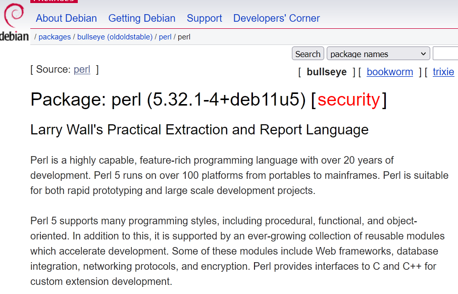

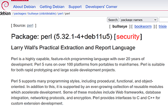

I've run in to a glitch with Debian 11 that fails because git depends on perl and there are no valid candidates for perl anymore.
If OP is on Deb 11, then a check of apt policy perl would show if this ticket is related to that glitch.
Blast, I have Bookworm, Buster and even an old Stretch but no Bullseye to tinker.
Missing Perl is a serious one bc that is a "required" one:
$ apt list ~prequired
Listing... Done
perl-base/oldstable,now 5.36.0-7+deb12u3 amd64 [installed]
Bullseye is perl 5.32.1

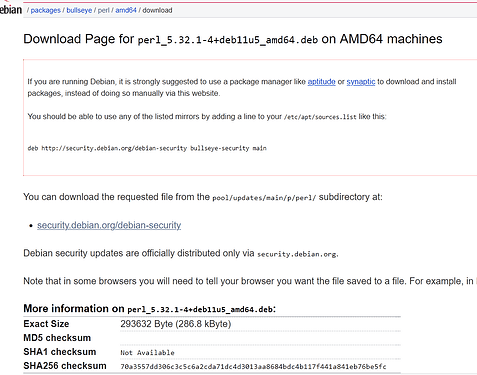

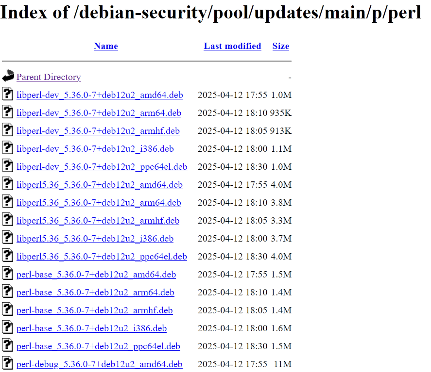

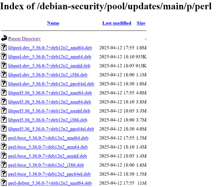

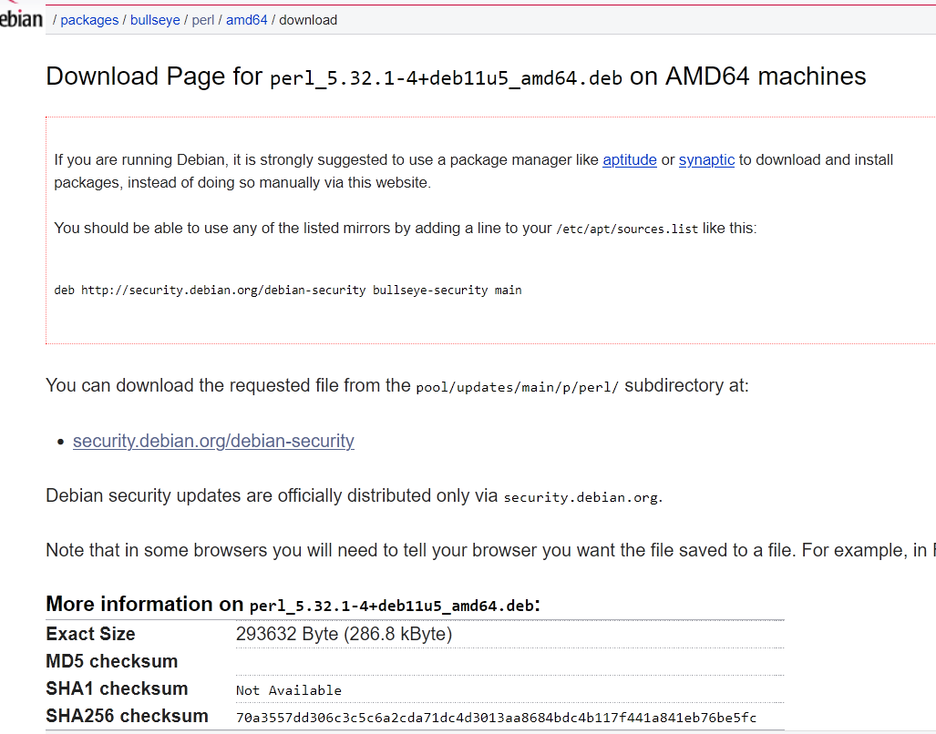

But that package doesn't exist:
The URL is: http://security.debian.org/debian-security/pool/updates/main/p/perl/perl_5.32.1-4+deb11u5_amd64.deb
That's a 404.
The repo doesn't go beyond Deb 12
Linking Improve gravity.db schema by DL6ER · Pull Request #6575 · pi-hole/pi-hole · GitHub because Debian 11 is also a topic there
This file can be found on the archive.debian.org domain, but I'm not sure if this will work: http://archive.debian.org/debian/pool/main/p/perl/perl-base_5.32.1-4+deb11u3_amd64.deb
Is it possible to change the apt repos to use archive.debian.org?
Sure, you can set sources.list (or equivalent) to what ever repo you'd like. The problem would then be that deb11u3 will not satisfy deb11u5 as apt requests. apt will still get a 404 because it does not know to look for alternatives. And deb11u3 is missing the security patches that u4 and u5 applied.
