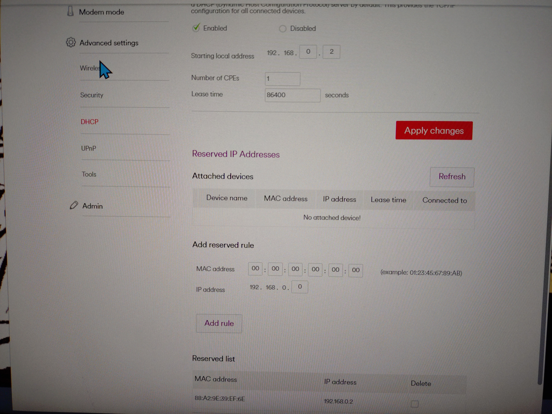

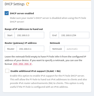

Just to check before I turn router DHCP off again, pi should look like this?
And the hub this?

In the router I've given the pi Mac address the permanent IP of .2 ?
hub reservation alone wont keep .2 alive once hub dhcp is off. the pi still needs a static set on the raspberry itself before you kill hub dhcp.

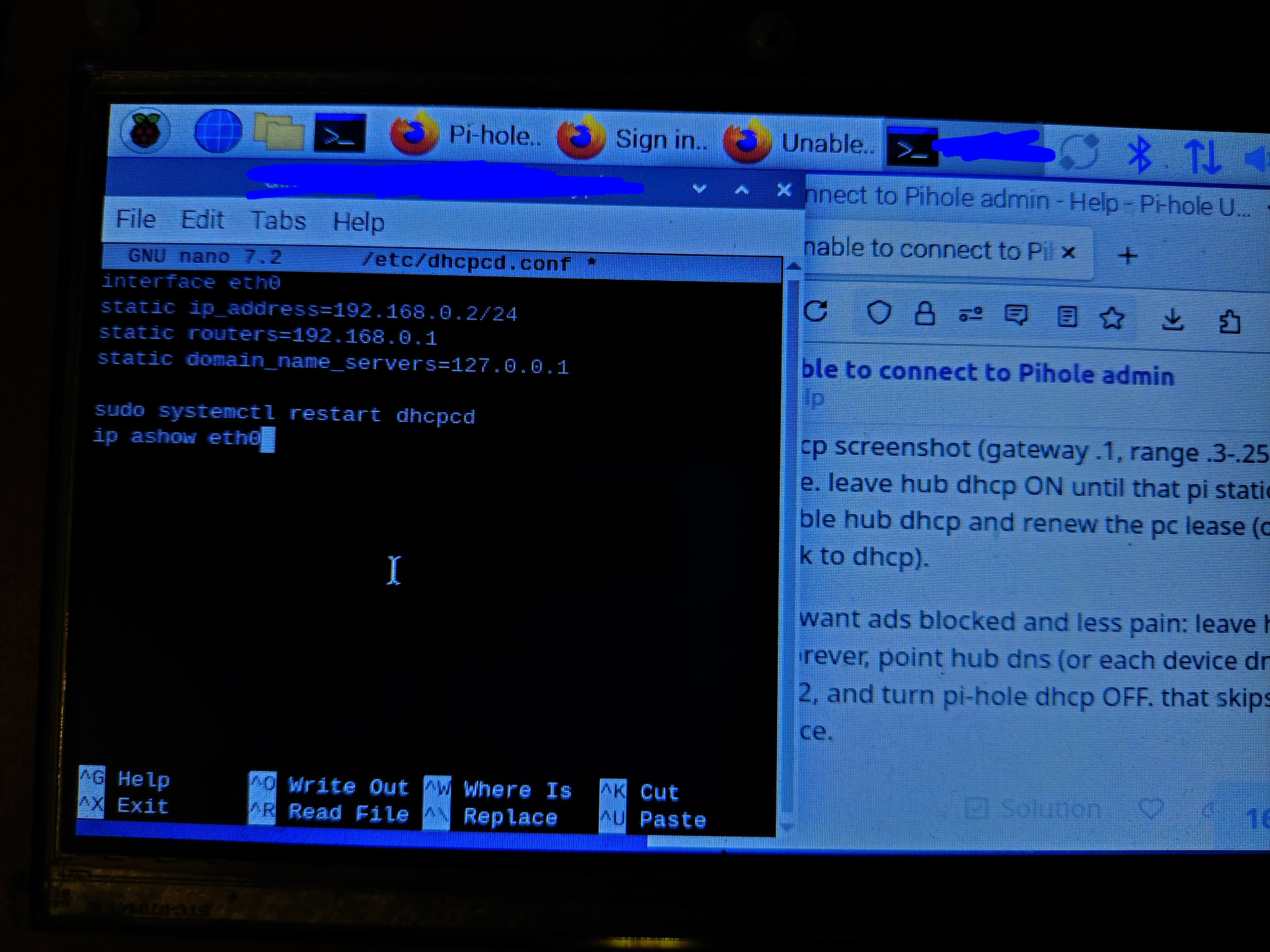

on the pi (while hub dhcp is still on and you can ssh or use a keyboard):
most pi-hole kits use dhcpcd:
sudo nano /etc/dhcpcd.conf
add near the bottom:
interface eth0
static ip_address=192.168.0.2/24
static routers=192.168.0.1
then:
sudo systemctl restart dhcpcd
ip a show eth0
your pi dhcp screenshot (gateway .1, range .3-.254) is the right shape. leave hub dhcp ON until that pi static sticks, THEN disable hub dhcp and renew the pc lease (or set the pc back to dhcp).

I did the first bit and got an empty black box. I added what you said but I'm not sure what to now do with it?

Before you edit config files, you can validate if dhcpcd is installed when run below one:
apt policy dhcpcd
See if its enabled:
systemctl is-enabled dhcpcd.service
