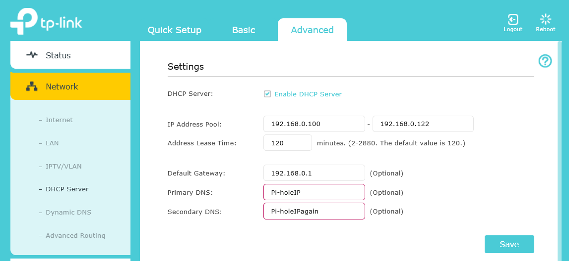

I think you are trying to modify the wrong DNS server option.
Do not change the "Internet" DNS server (keep using the original ISP server, or Google, or any other public DNS server).
Go to Advanced settings, open the Network > DHCP Server page.
Then set Pi-hole as both DNS servers:
Important: If you set this option, you need to disable Pi-hole DHCP server and enable the router DHCP server.
Note:
Your router may show different pages/options in the web interface.
I used the TP-Link emulator for Archer C6 as a reference, but you need to find the correct option in your own router interface.

Didn't know that. I still got two hours before I leave, so I'll try now.
Clients connect! And it appears to work! Thank you!
