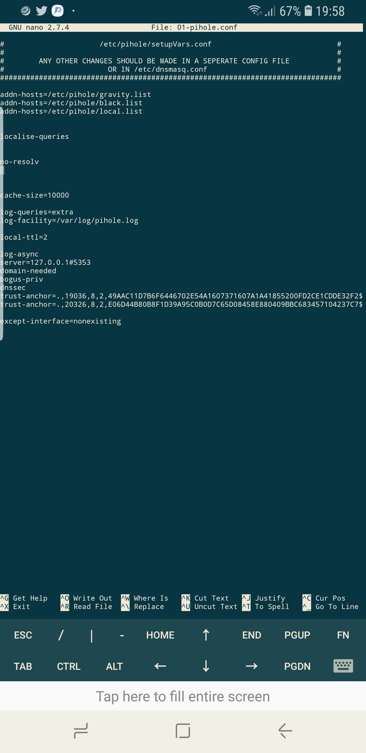

You are running unbound on port 5353 but you are not requesting DNS resolutions via unbound.
Your /etc/dnsmasq.d/01-pihole.conf has only:
server=127.0.0.1
Should be:
server=127.0.0.1#5353
You can edit that file via CLI (by editing the file directly) or from the /admin/ interface.
Make sure you specify the port 5353 (the one currently configured in your unbound) in the interface.
I have just checked the file and it has the correct address 127.0.0.1#5353
See screenshot.

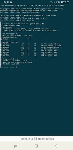

Try dig github.com -p 5353 to check the next step on the resolver chain. FTLDNS is giving you a response, but that response is empty as it's not getting any answer from its upstream resolver.
Well I have just added these two and still no luck. I don't think they are getting blocked because the log shows they are getting forwarded but for some reason the log says they couldn't find server for GitHub.com.
If I temporarily change dns to Google it all seems to work fine.
This is the output.

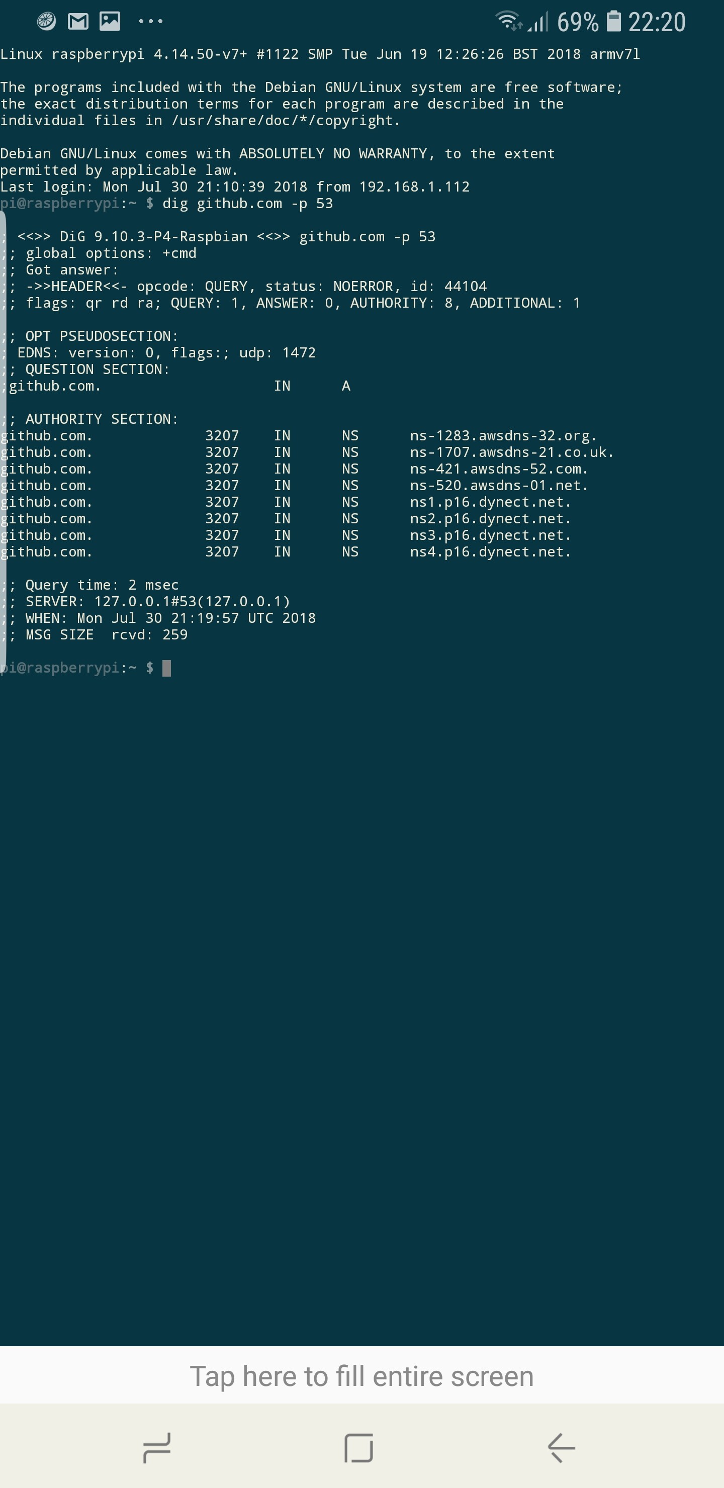

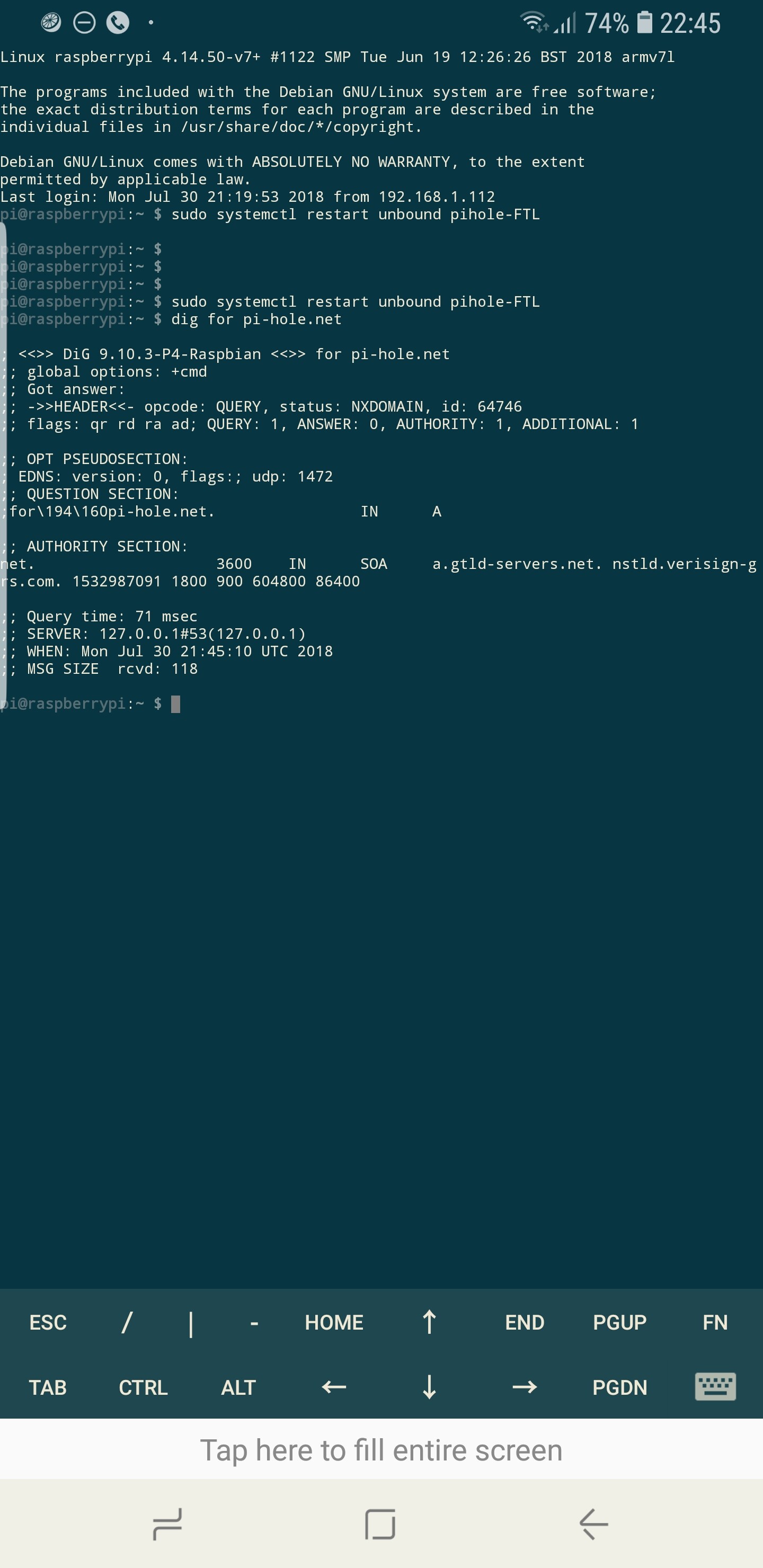

And one more dig github.com -p 53 to check and see if it was just a transient error that cleared please?
Here is the output
Here is the output of the command
It was only a few seconds to restart like 1 or 2 secs. Here is the output.

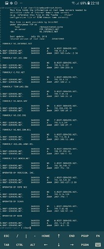

Here is the output of the file:
pi@raspberrypi:~ $ cat /etc/unbound/unbound.conf.d/pi-hole.conf

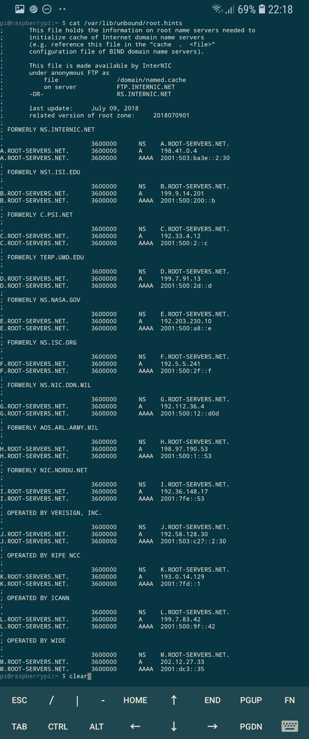

    root-hints: "/var/lib/unbound/root.hints"

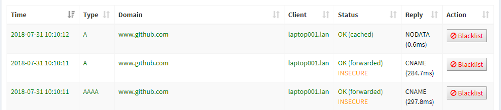

this is what the log shows on pihole interface.
