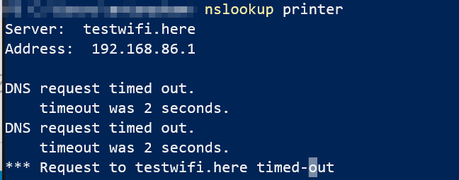

From a client connected to Pi-Hole, what is returned following this command:
nslookup printer
