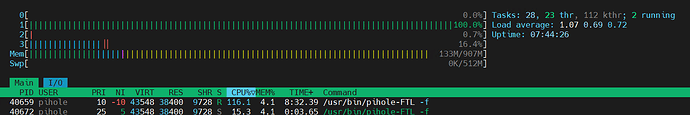

hm interesting.
I let the disabled timer, time out and re-enable blocking and once again the CPU climbed and the DNS could not resolve any nslookups
Back to high usage.
Suppose I will downgrade the instance and see if it helps due as I am unable to pinpoint the concern.
