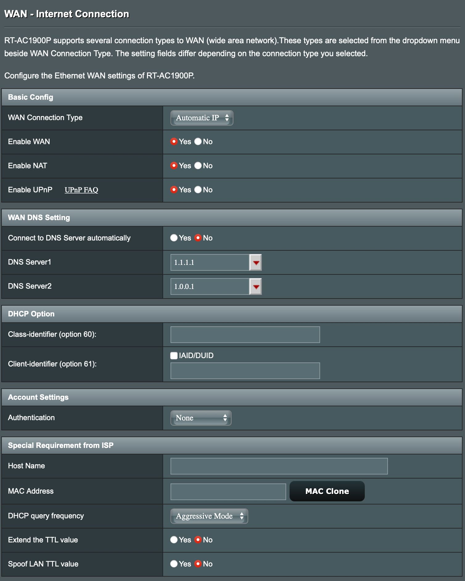

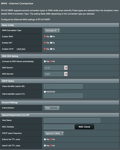

You are in the WAN settings and you have really good option.
It is asking you If you want to use the WAN for practically, anything.
Disabe NAT
Disable UPnP
See what options you have under DHCP query Frequency and try to shut that down.
I'm not sure about extending or spoofing the TTL because I do not know how to replace it.
Is that the whole screen?
Do not mark this as solved: someone else can answer the TTL questions.
Yeah, that's the whole screen. I'll look at the NAT and UPnP stuff — I think the TTL questions (and the whole "special requirement from ISP" section) is probably fine :thinking: but at the end of the day, I'm still not feeling any problems / issues with double-NAT'ing so I can disable NAT and pass-through to the Gateway's own NAT but as long as my P0w is connecting and behaving well, I'm probably good on my end!
E.g. I'd also be concerned that disabling NAT will push DHCP requests (and DNS requests?) up to the Gateway, which would bypass the PiHole entirely anyway :thinking:
I'm pretty sure that page is asking if you want to use the gateway/WAN for those settings.

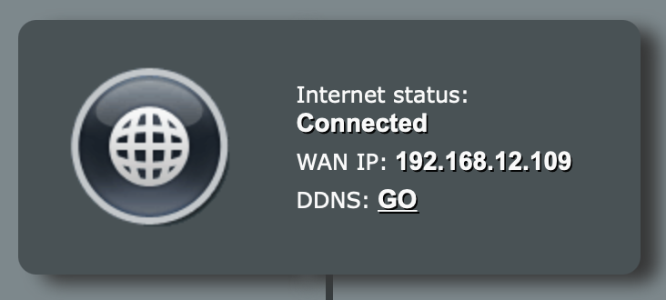

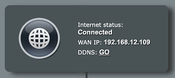

To be fair I guess I may not totally understand what "double NAT'd" truly means but given that my LAN from my router is the 192.168.1.1/24 then the router is getting its upstream IP from the gateway also as a NAT'd LAN on 192.168.12.1/24 (shown below)

Your gateway is giving the router a WAN address from its DHCP server in its "12.XXX" address range.

Right, exactly — the Gateway is assigned a public address (which, now that I think about it, may also be another layer of NAT in the cellular layer itself)
My public address is actually 172.58.1.1/16 (anonymized heavily), though now that I think about it there may be even another NAT setup in the cellular layer too.. But if we assume that the Gateway is 172.58.1.1/16 then it assigning my router the address 192.168.12.109/24 represents a NAT layer happening, right? The gateway has a NAT'd LAN on 192.168.12.1/24. But then my router is doing its own NAT'd LAN on 192.168.1.1/24 (e.g. my laptop's LAN IP is 192.168.1.222). Isn't that a double-NAT'd setup? Or is that something totally else.
