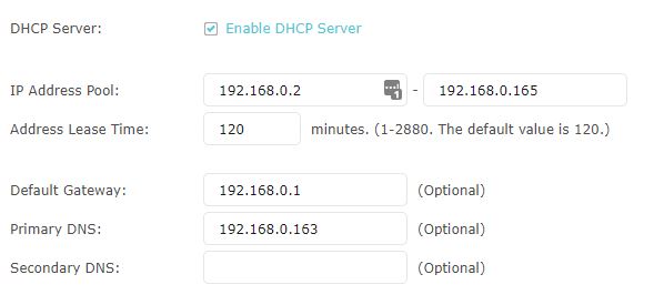

I have set up my router's DHCP to use Pi-hole as DNS server at 192.168.0.1.

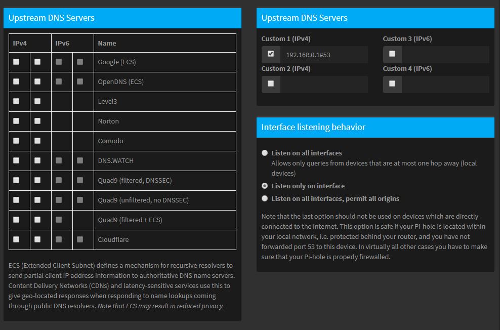

I have manually changed File /etc/resolv.conf to nameserver 8.8.8.8.

PIHOLE_DNS_1=192.168.0.163#53

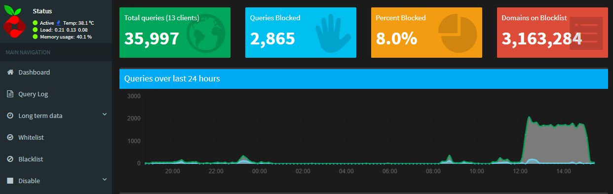

Now queries have status "OK (forwarded) UNKNOWN". It seams that nothing is filtered out. Gravity is updating the list. After restarting my router and pi-hole everything seems to be working.

You are absolutely right. No new REFUSED lines. Thank you so much for resolving all this issues for me. I have tried to do it by myself for days now.
