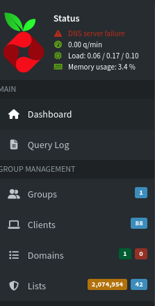

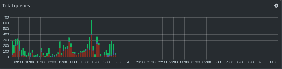

After updating, my Pi-hole no longer is receiving queries. The admin page shows the following:
I did not notice until this morning that I was having this issue:
I have verified that dnsmasq is not running
I have internet and can browse normally, it just appears that my ad blocking is broken at the moment.

Your debug log shows an issue with your settings and this is probably causing the DNS failure.
You added 2 dnsmasq settings:
     dnsmasq_lines = [
       "enable-tftp",
       "tftp-root=/srv/tftp"
     ] ### CHANGED, default = []
But port 69 (TFTP port) is already in use:
    udp:0.0.0.0:69 is in use by in.tftpd
    udp:*:69 is in use by in.tftpd
This is causing a dnsmasq failure:
   2026-09-02 13:07:03.374 BST [6914M] INFO: PID of FTL process: 6914
   2026-09-02 13:07:03.376 BST [6914M] CRIT: Error in dnsmasq configuration: failed to create listening socket for port 69: Address in use
After that, the debug log doesn't show the expected messages related to DNS start.
Suggestion:
As a test, disable in.tftpd or remove the misc.dnsmasq_lines.
If Pi-hole starts after that, the issue is related to the port conflict.
Removed those lines from my config and it immediately started working, thank you!
