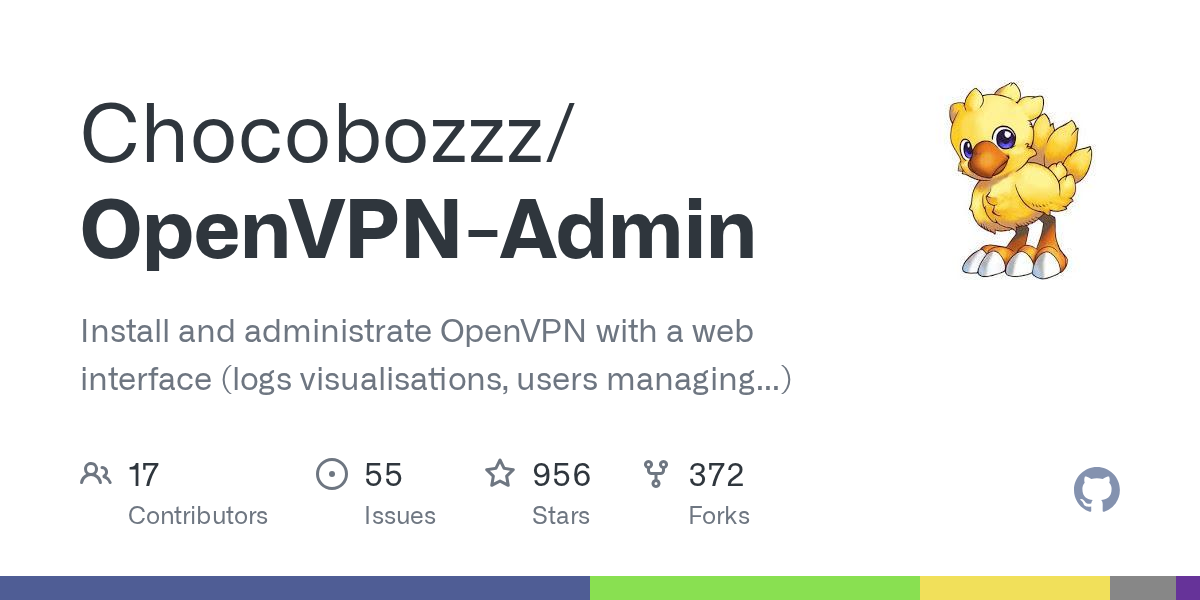

FWIW- here is an openvpn server implementation with password authentication:
https://github.com/Chocobozzz/OpenVPN-Admin
I'm currently running it on a regular Ubuntu 14.04 server but I don't see any reason why it should not install on a Raspberry Pi.
The installer is not quite as nice as Pihole's/PiVPN's but It comes with a nifty web UI for managing openvpn users and downloading openvpn client config files. I'm going to attempt to get this running in harmony with Pihole tonight and will report back.
