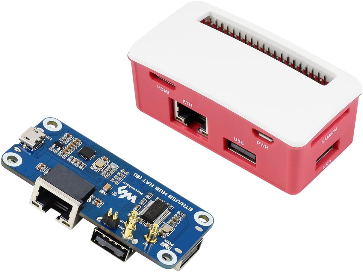

I have a USB to Ethernet adapter but that seemed to cumbersome in my messy little "server" room ..so I got the ethernet "hats" that came with nice little cases

My Ethernet adapter arrived today, I plugged it in, and it ran fine for 5 hours but still got disconnected.
