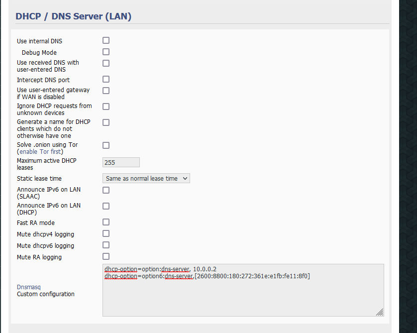

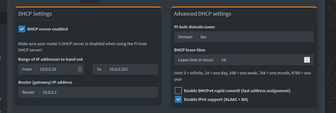

So this might be part of the issue. I disabled RA via SLAAC on my router, as I literally cannot find a way to remove it's ipv6 address from the RDNSS broadcast (it seems to be hardcoded into the program somewhere, I am in the process of digging through the source code). I thought that enabling SLAAC+RA on the pihole would completely take over from what the router was doing, but you are implying that it does not.

Here is the settings I have configured on my pi-hole
Here is my router's DNS/DHCP settings.
I found that if I do not uncheck the Announce IPv6 on LAN (SLAAC) option, no matter what I do, my router will provide itself as an IPv6 DNS server, in addition to the custom dnsmasq configuration settings that I have set into it.
