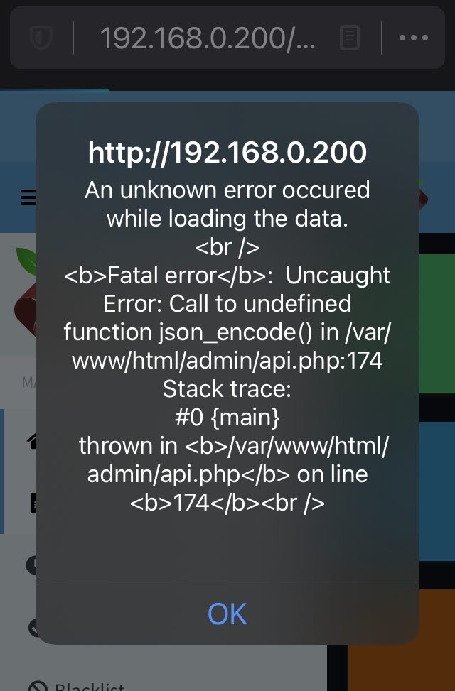

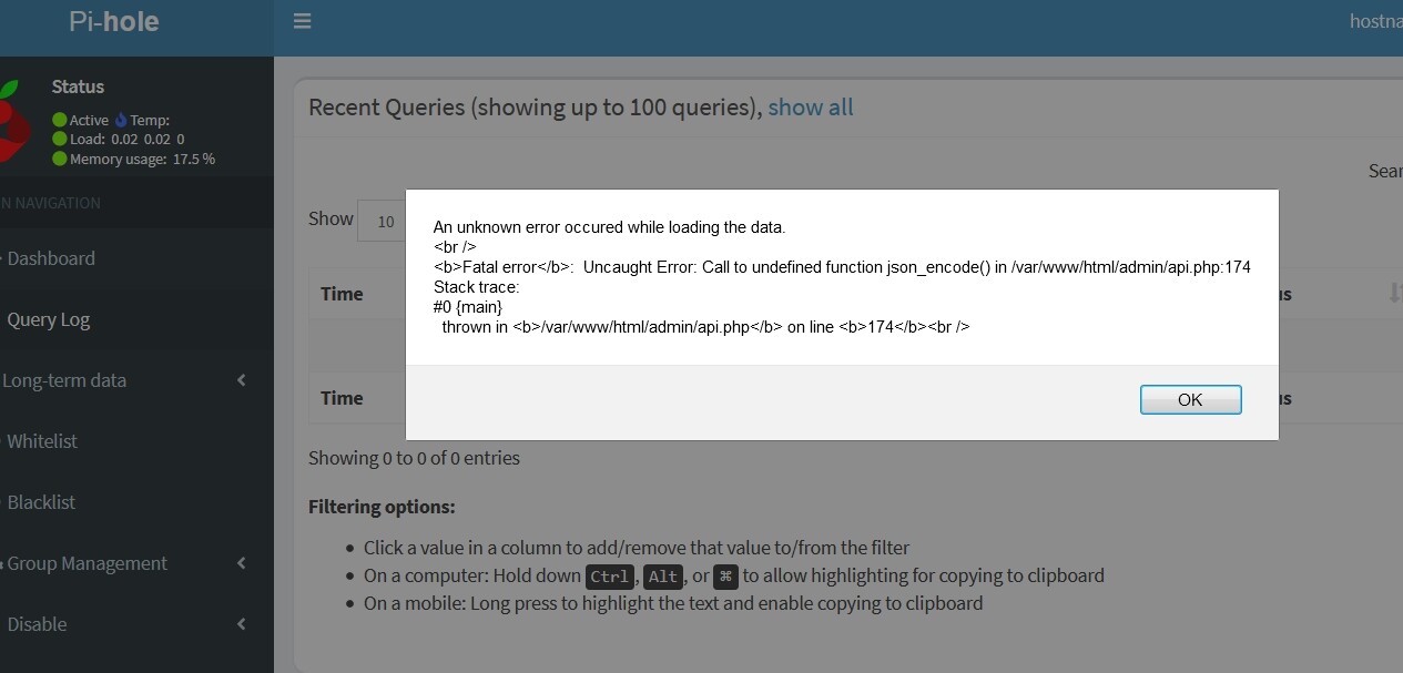

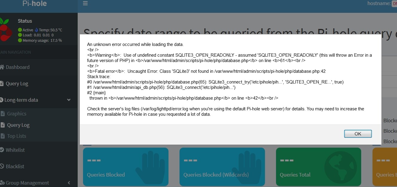

Pihole no stats via web interface
screen shots attached. hope they shed light on the problem.

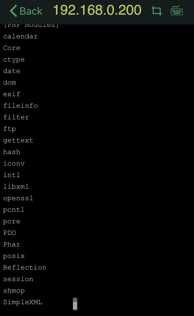

And post outcome for below one just to be sure ?
php -m

Output for below one was missing though but output for that one seems irrelevant now:
I cant see anything wrong from the output.
Only thing wrong is the output for the php -m command doesnt list those two installed PHP modules json & sqlite3.

Í'm out of ideas except one.
Uninstall/purge them all with below and start fresh:
sudo apt purge javascript-common lighttpd php-cgi php-common php-intl php-json php-sqlite3 php-xml php7.3-cgi php7.3-cli php7.3-common php7.3-intl php7.3-json php7.3-opcache php7.3-readline php7.3-sqlite3 php7.3-xml
When purging, take note of any files or folders not being removed for some reason and post them here!
If you run below one afterwards and select repair, Pi-hole will try reinstall the lighttpd & PHP dependencies again and configure them for use:
pihole -r
dpkg: warning: while removing lighttpd, directory '/var/www/html' not empty so not removed
Purging configuration files for javascript-common (11) ...
dpkg: warning: while removing javascript-common, directory '/etc/lighttpd' not empty so not removed
Purging configuration files for php-common (2:69) ...
Purging configuration files for php7.3-sqlite3 (7.3.27-1~deb10u1) ...
Purging configuration files for php7.3-json (7.3.27-1~deb10u1) ...
Purging configuration files for php7.3-readline (7.3.27-1~deb10u1) ...
Purging configuration files for php7.3-common (7.3.27-1~deb10u1) ...
dpkg: warning: while removing php7.3-common, directory '/etc/php/7.3/mods-available' not empty so not removed
Purging configuration files for php7.3-intl (7.3.27-1~deb10u1) ...
Purging configuration files for php7.3-xml (7.3.27-1~deb10u1) ...
Purging configuration files for php7.3-cli (7.3.27-1~deb10u1) ...
dpkg: warning: while removing php7.3-cli, directory '/etc/php/7.3' not empty so not removed
Purging configuration files for php7.3-opcache (7.3.27-1~deb10u1) ...
Processing triggers for systemd (241-7~deb10u6+rpi1) ...
ran pihole -r and VOILA ! I have the web gui working. wonderful graphs etc. so pleased, many thanks for your help :slight_smile:
