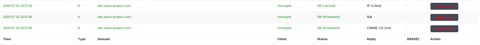

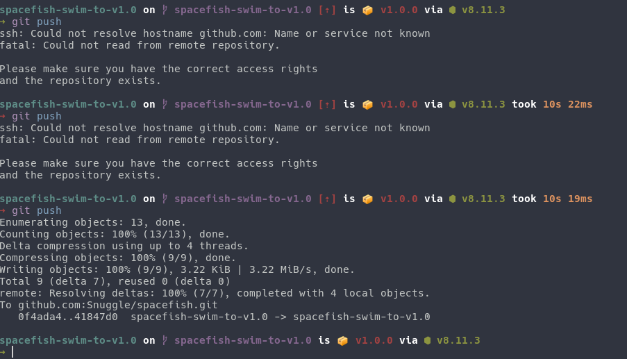

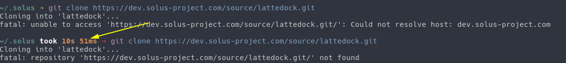

It specifically seems like it's taking ~10 seconds to time out. Do you know if 10 seconds is a common timeout period for DNS or...? Hmm.
It seems like it's failing on CNAME + N/A, and then resolves correctly once it's cached.
I don't know if 10 secs is a common DNS timeout period, I haven't seen delays of this magnitude on my PiHoles. They are pretty snappy all around. Even with my local DNS resolver (unbound) having to go all over the internet to put together a new address not in cache, it's typically a few hundred msecs to get the address, and the PiHole gets it to the client immediately. Never multiple seconds.
Your data shows that the PiHole is resolving the DNS in a timely manner, yet it's not getting to the client quickly. See what effect the remaining troubleshooting steps have on the performance.

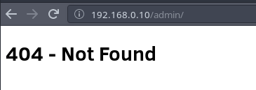

I can't even connect to the web interface, yet I can ping the Raspberry Pi. Something very odd is going on.

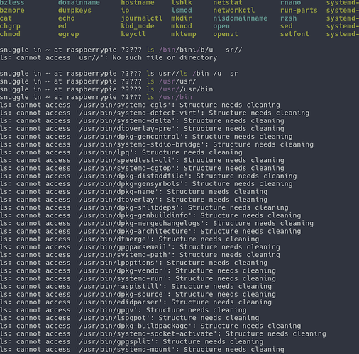

[Edit]

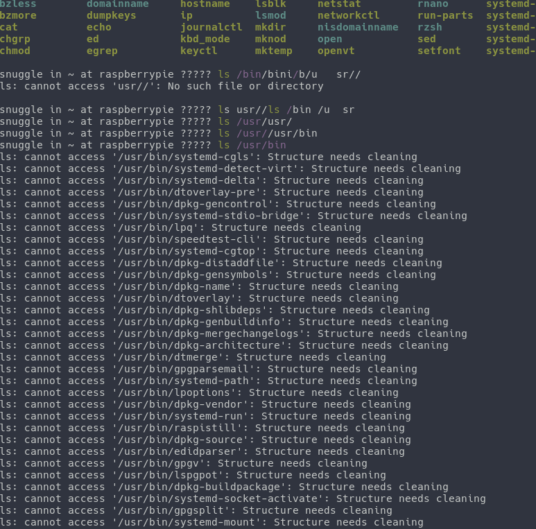

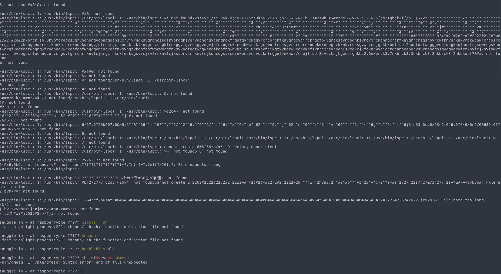

It appears the cause could potentially be due to some form of growing mass-filesystem corruption. The Raspberry Pi was not messed up like this yesterday, and I made 100% sure to shutdown the system cleanly before changing the power supply + Ethernet.
Could the filesystem be messed up due to the lack of a sufficient power supply? :thinking:
Welp. Apologies. I think I need to reformat this Raspberry Pi's SD card and try and buy a better power supply.

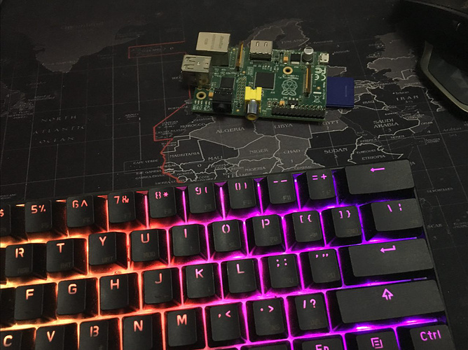

[Edit] A sad view of a dead PiHole. R.I.P.

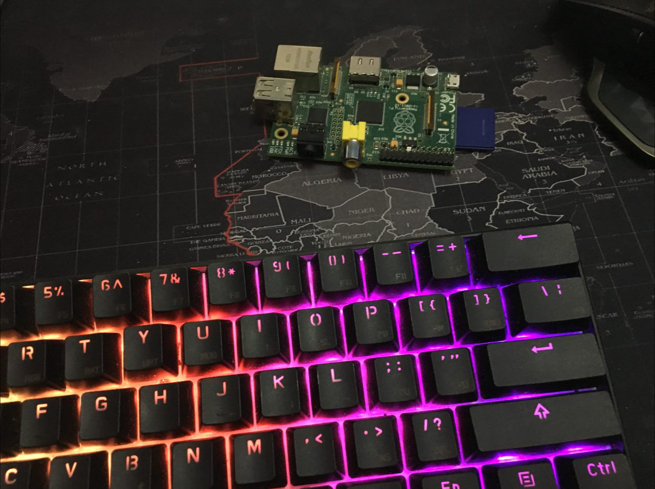

Incremental Update: My Raspberry stopped booting at all. Any power supply, any method of flashing the SD card or any image wouldn't work. NOOBs, Raspbian Headless, Etcher, dd, Copy/Paste NOOBs, nothing.

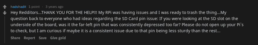

I then read the following Reddit thread and this comment in particular seemed odd, since my SD card port's left pin looked a fraction of a hair lower than the others. Barely noticeable and you wouldn't think anything of it, without a very close side-inspection with a flashlight.
I grabbed a pair of iFixit tweezers and gave a light tug/wiggle on each SD pin within the port, put the SD card in again and it boots. It appears this might be caused my a dodgy Raspi SD port. I'm going to try PiHole again and update this post if it works, to help anyone else who might have a similar issue with their PiHole/Raspi acting very strange for no reason.
