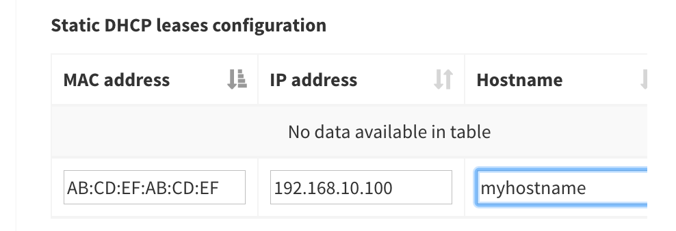

You can already set hostnames with the static leases, or am I misinterpreting your request?
 ![](https://discourse.pi-hole.net/uploads/default/original/2X/b/b29dae25befbf8a08e56a0df7c5e194586a74811.png)

Will test when I get home but to my knowledge this did not bring the hostnames into the webgui instead of ip's this feature request was based off of a troubleshooting thread from Reddit that I will link when not on mobile
