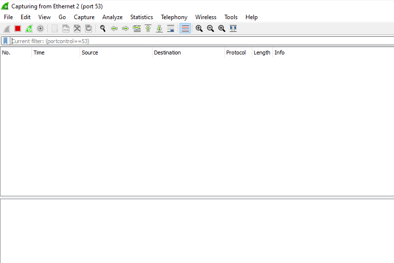

...and that's the end of the output. I did make sure it was running the test while it was capturing, as well. I also tried just using Wireshark from a VM I have (which I have verified does capture traffic from the entire network) and I also see nothing.
I assume this means my computer is getting this DNS for itself then?
I have to admit that I'm not sure at all that this means. At first glance, this means your computer was not sending any packet over port 53. Which seems wrong. Because it should have recorded at least the queries being sent to the Pi-hole (even when they are never replied to).
Do you have multiple interfaces? Maybe tcpdump happened to record on the wrong one.
Oops, my bad. Yeah I was listening on the wrong interface. I actually don't know why the Wireshark GUI doesn't show anything, I'm not too great with using it. Here's the tcpdump from my pi.

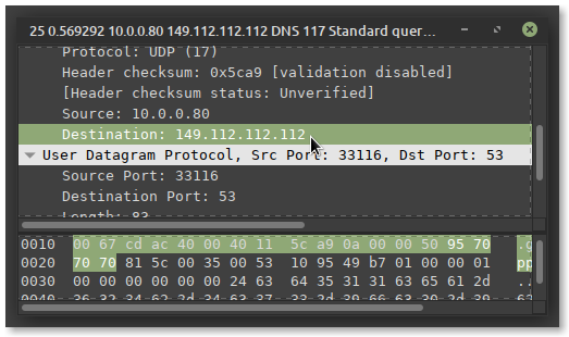

I found this, seems a little odd:
149.112.112.112.53 > 10.0.0.80.33116: [udp sum ok] 18871 ServFail q: AAAA? cd511cea-624b-4c73-9fc0-9ab27eaeff7d.test.dnsleaktest.com. 0/0/0 (75)
But this was with your Pi-hole ON :upside_down_face:
And your Pi-hole did ask this server so the response you saw didn't come out of the nothing.

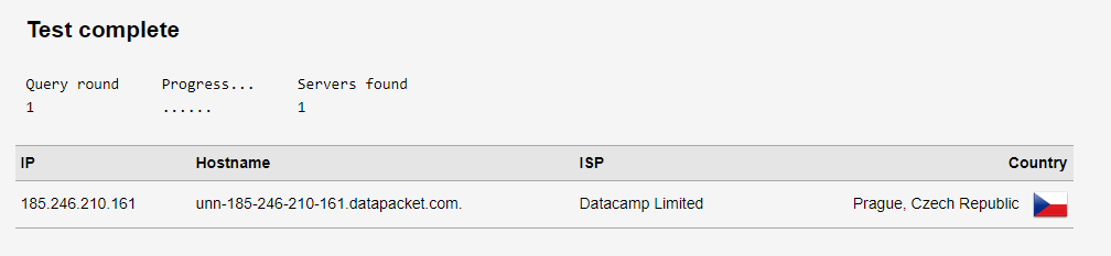

That's somewhat fascinating. There is neither a request to this IP in your file nor is there any response (from anywhere!) in there. So the query comes in from something else than standard DNS. Maybe DNS-over-TLS or something in your local browser.
Could you try recording again, this time without any filter (so a capture-all recording)?
sudo tcpdump -w /tmp/dns.pcap
The file may grow quickly. If it gets too large, you may want to check with the IP shown in the browser (seems to vary?):
sudo tcpdump -n -ttt -r /tmp/dns.pcap -vvv src 1.2.3.4 or dst 1.2.3.4
(replace 1.2.3.4 by the IP address revealed during the DNS leak test)
As things are getting bizarre, there is no guarantee this will be successful...

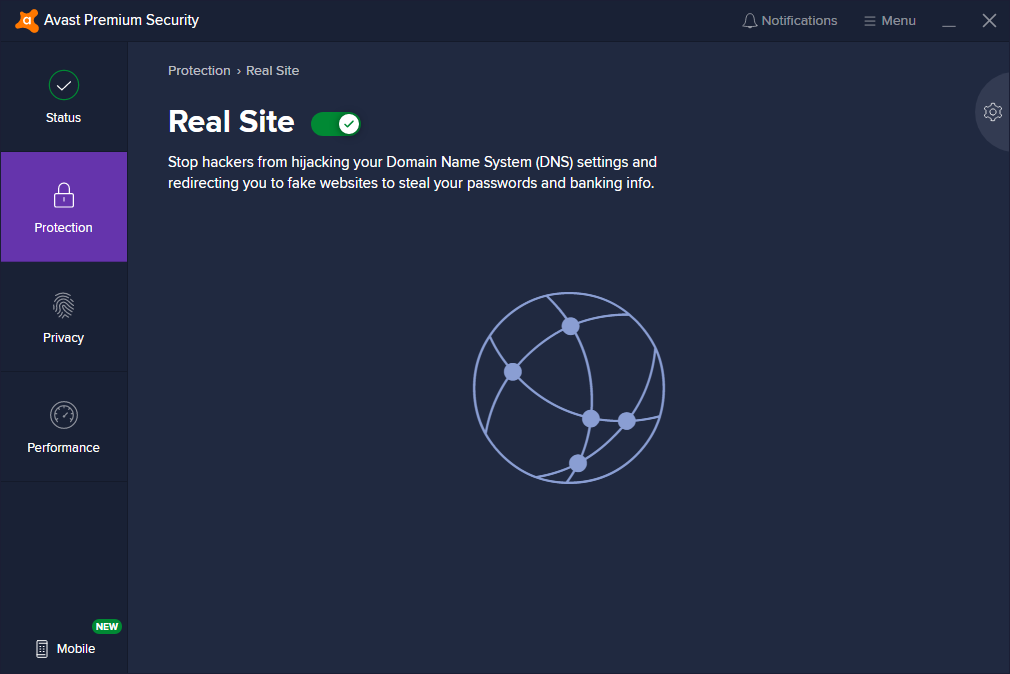

Just a thought:
Your devices wouldn't make use of additional DNS services as offered by anti-virus software, e.g. AVG Secure DNS or AVAST Real-Site?
Or perhaps you are running a VPN gateway on your network?
Wait a second here. Are you telling me that this is probably it?
Testing it now.
Wow.. wow. That seemed so random yet on the dot. That's exactly what the issue was, as far as I can tell. Now, effectively no internet when PiHole is off, and all ads blocked as expected when it's on. Thanks a lot to both of you guys, you've been really helpful. I won't close this topic for another day just to make sure everything is as expected.
