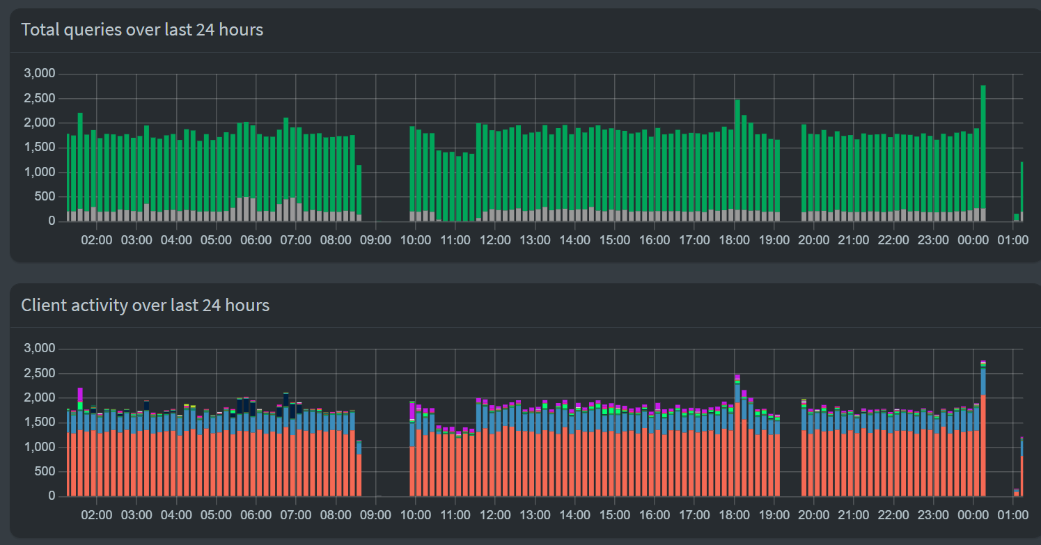

I have the Pi zero 2 W running unbound and pihole on its own and that's pretty much it. The most talkative device you see on the network is a Pi 4 8GB running 50 containers - in the past I had a 4GB pi pushed to its limits and when resources on that became low, obviously the network performance was impacted. so I split the realtime services needed and upgraded the 4GB. You will see by the sudden drops of traffic when the pizero goes down.

The gaps in that graph do not necessarily imply that the Zero goes down.
They rather indicate that your Pi-hole running on that Zero hasn't received any DNS requests at certain times.
If clients in your network would use another DNS server during those times, it may also explain why you wouldn't be able to access services by pi.hole's name.
That said, a sudden switch to another DNS server would be more likely if your router would serve as local DNS server, funneling all your clients' requests and using Pi-hole as one of its upstreams.
Your graph indicates otherwise, as there seem to be multiple clients using Pi-hole directly, and your debug log shows you are correctly distributing your Zero's IPv4 via DHCP only.
Still, as your debug log shows your network to have link-local IPv6 connectivity, that would leave your router advertising its own link-local IPv6 as DNS server as a possible by-pass.
You may want to check your router's DNS configuration for IPv6.
