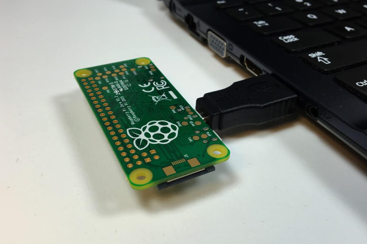

It appears to be possible to setup a Pi Zero W running Pi-Hole in USB Ethernet Gadget mode and connect it to an Asus Router with USB ports (RT-AC68U) running Merlin firmware. Unknown if this procedure works with non Merlin firmware ASUS routers or with other manufacturer routers. It does involve quite a bit of editing/creating files on both the Pi Zero W and the Asus router firmware. These directions assume one has knowledge of Linux commands, and using SSH (Putty and or WinSCP) Standard disclaimer: Proceed at your own risk!!! It is entirely possible one could brick their router or Pi Zero W by editing the firmware/OS files.

Power down the Pi Zero W and attach the USB cable from the router’s USB port to the Pi’s USB port (not the power port). Using SSH log into the router and issue the following two commands which should bring up the usb0 port and bind it to an IP address.

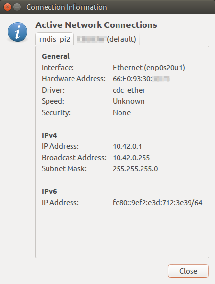

Using SSH, access the Pi Zero either by its new IP address assigned by the router or by its name (ex: raspberrypi.local). Once accessed, run the following command to create the /etc/modprobe.d/g_ether.conf file:
echo 'options g_ether host_addr='$(dmesg | awk '/: HOST MAC/{print $NF}')' dev_addr='$(dmesg | awk '/: MAC/{print $NF}') | sudo tee /etc/modprobe.d/g_ether.conf
While still using SSH to the Pi Zero W, edit the /etc/modprobe.d/g_ether.conf file and replace the dev_addr= Mac address with the MAC address for your Pi Zero W’s eth0 MAC you obtained previously. Make note of the host_addr= MAC address in the g_ether.conf as it will be needed later.
Note: If you do not use the Pi Zero eth0 MAC address you may have trouble at the end of this procedure accessing websites by their name.
