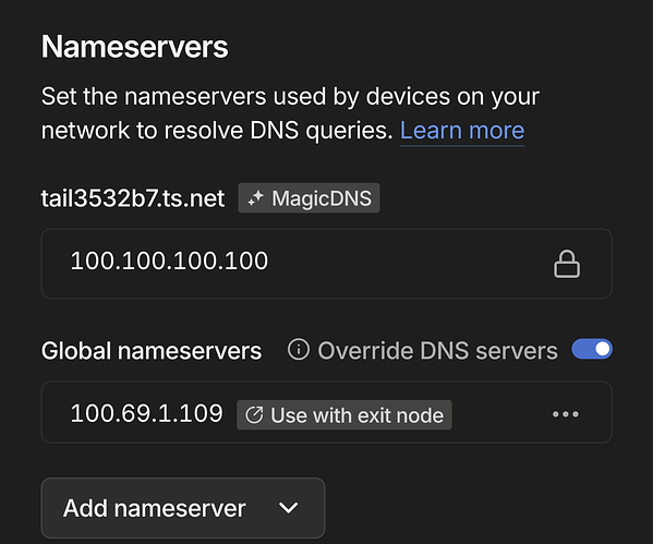

Additional notes: Tailscale is set to use the Pi-hole tailnet IPv4 as the only global nameserver, and is set to override local DNS and run on exit nodes. MagicDNS is enabled. Pi-hole is configured to permit all origins. The client device is configured to use TailscaleDNS. This setup was working seemingly without issue for several weeks. It was only within the past couple of days that Pi-hole stopped serving Tailscale clients. If it's relevant around this time I attempted to install nextcloud via snap, but abandoned this project and subsequently deleted nextcloud (I never made it past downloading/installing for what it's worth).

The tailnet should only be using the Pi-hole as it's DNS. I've tried on both local wifi and cellular, and when tailscale is enabled it fails in usual fashion. This is regardless of whether "Override DNS servers" is enabled or not in the admin panel.
