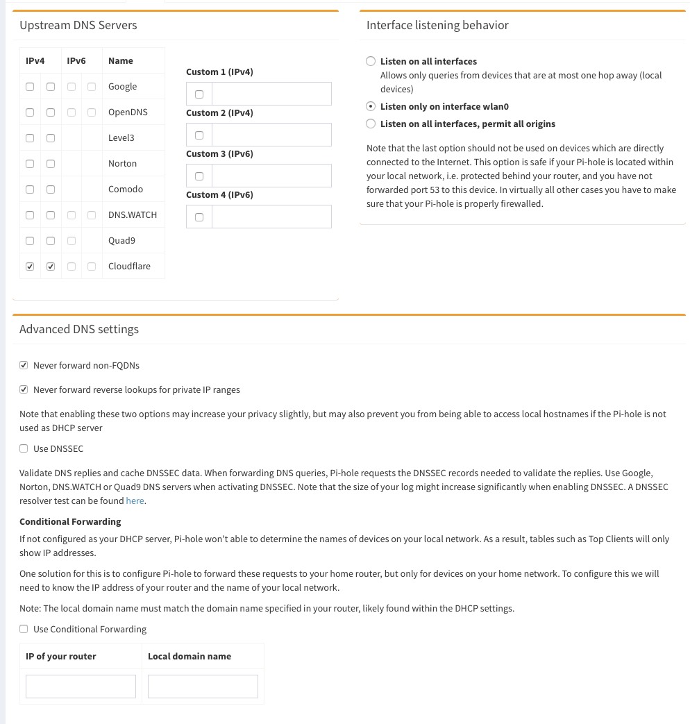

What does your similar admin page screen look like?

I still can't visit websites if 127. 0. 0. 1 is set in resolv. conf. Then my Internet won't work anymore.
