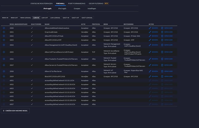

Firewall rules:

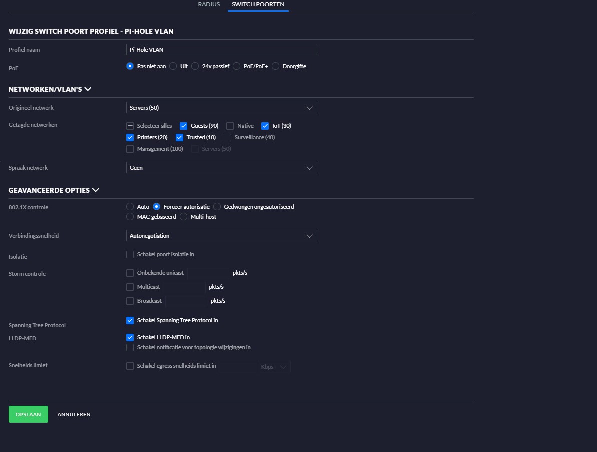

VLAN profile set for the Pi-hole (before it was just attached to Server VLAN):
If for example trusted to servers was blocked I woudln't be able to reach the other pihole or my nas.
So inter VLAN routings seems to be working just not when alias Ip's are added to it... weird...
