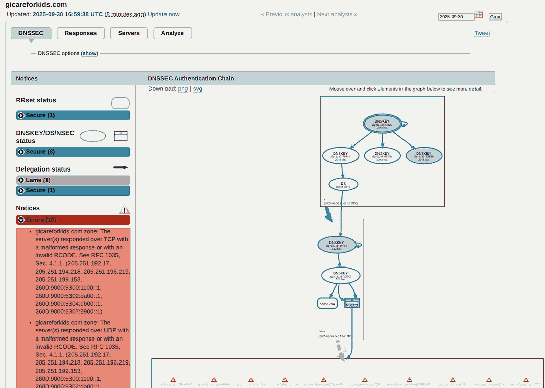

I gave all these to ChatGPT, and it said the error appeared to be with the gicareforkids website and not my setup. However, if I turn off WiFi and connect with my phone, I’m able to reach gicareforkids.com without issue. Is there anything else I can try, or is this error truly outside my control?
Since public DNS resolvers also fail to resolve gicareforkids.com, the issue is indeed with public DNS rather than a specific DNS software.
DNSSEC validation confirms that DNS records for gicareforkids.com are malconfigured:
Only the maintainers for the gicareforkids.com can address this, by fixing their misconfigured DNS records.
Thanks for the quick and detailed reply. I’m curious why my T-mobile based cell service is able to connect, but perhaps they have cached DNS records that mask the misconfiguration.
And just like that, the site is back up after being unreachable for 2 days. I found the dnsviz tool you used above, and the re-analysis found no errors.
