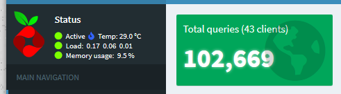

Added localhost to that config file I mentioned earlier, restarted pihole-FTL and everything comes up green now. Still strikes me as odd that this worked previously in v4 but not now in v5, and I haven't changed any settings - just ran the pihole -up command. Thanks folks!
root@lurker:/etc/dnsmasq.d# cat 02-pihole-enp0s31f6-only.conf
listen-address=192.168.1.4,127.0.0.1
bind-interfaces
