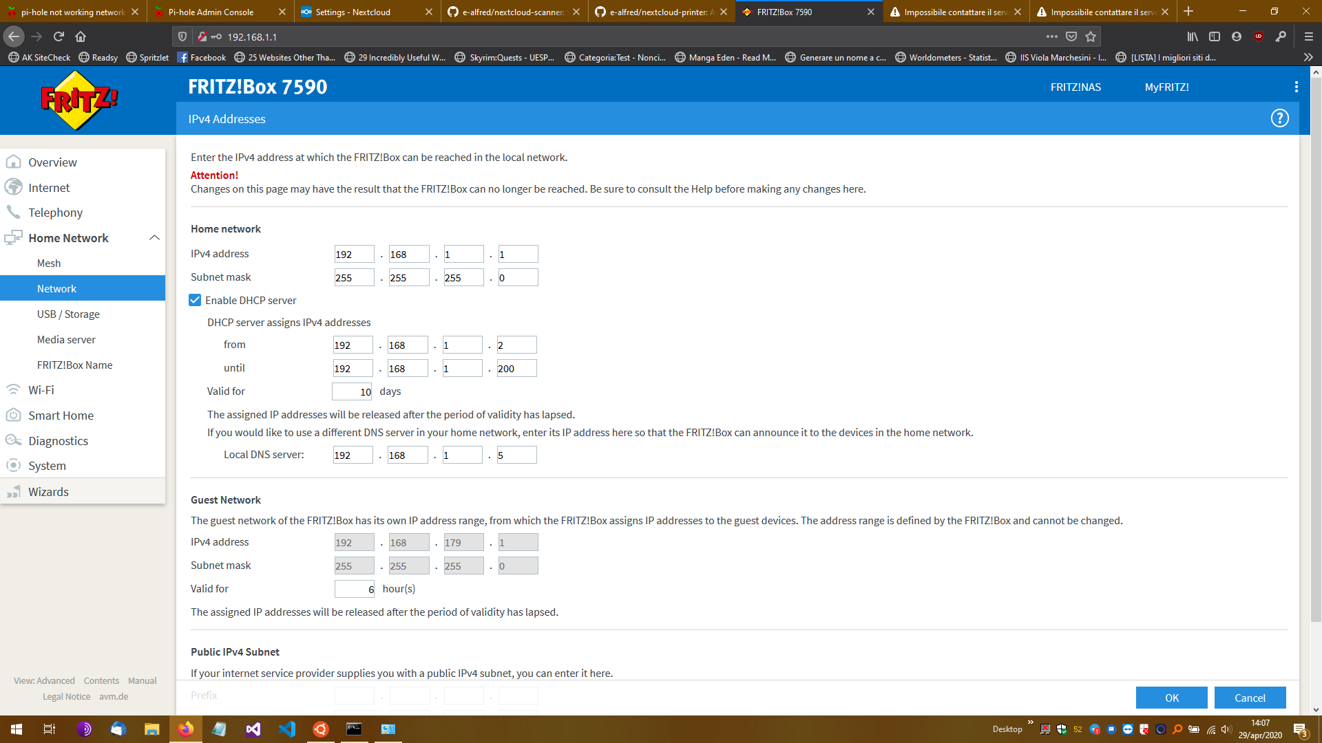

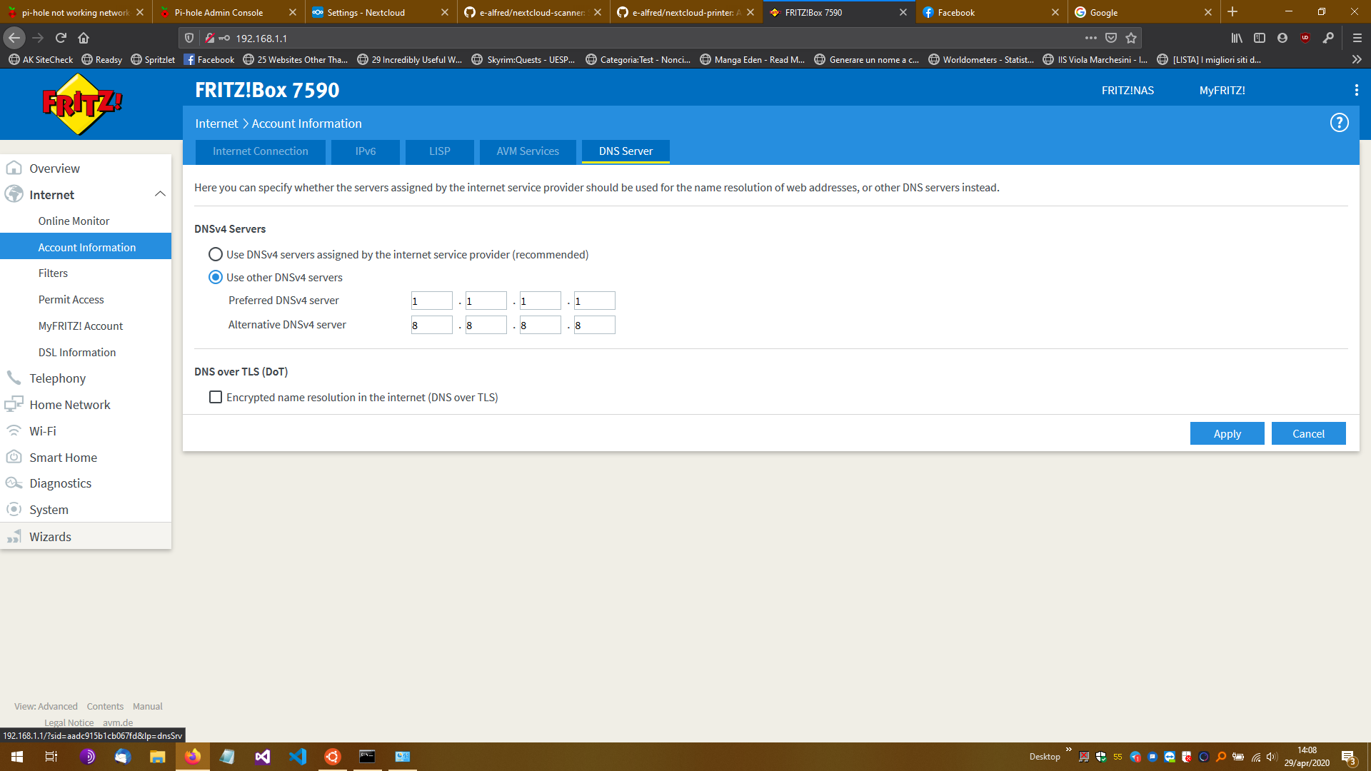

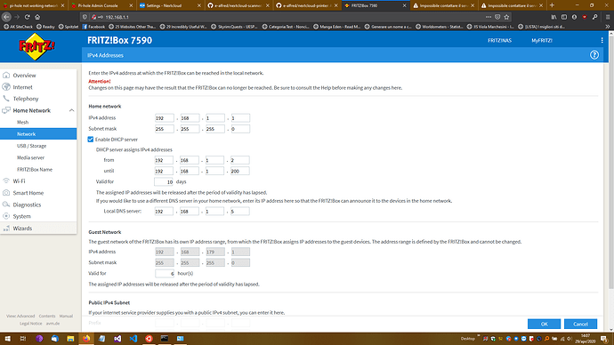

How did you configure your router to make use of Pi-hole?
a) upstream DNS server ( Internet | Zugangsdaten | DNS-Server in a German FritzBox),
b) local DNS server ( Heimnetz| Netzwerk | Netzwerkeinstellungen | IPv4-Adressen )
c) both?
only the first one was configured, but even after configuring the "local DNS server" to 192.168.1.5 it doesn't change anything, there's no connection to any site and also the results of the previous commands are the same

If you have successfully configured Pi-hole as local DNS (option b), there is no immediate need for employing option a) also.
Your timeouts could suggest that you somehow configured a DNS loop, which would be the case if your router ask Pi-hole for upstream DNS resolution, while Pi-hole is configured to use your router as usptream at the same time.
Try switching your router's upstream DNS back to ISP default or any other public DNS sefrver, if you prefer.
Your local clients will start using Pi-hole as distribituted by DHCP only once their DHCP lease renews (FB defaults to 10 days here) or when they disconnect and reconnect to your network (e.g. by switching off WiFi or by power-cycling each device, or rebooting your FB ( System | Sicherung | Neustart - sorry for German, can't find an English translation for this).

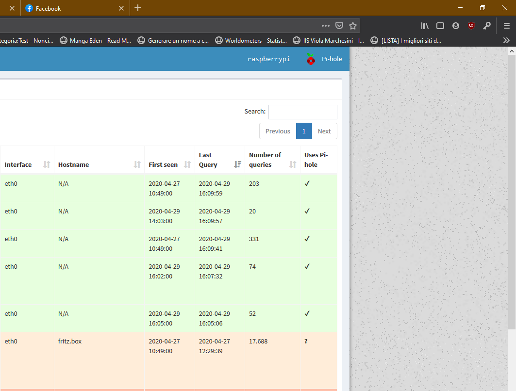

You can verify that Pi-hole is used for DNS:
A plain nslookup flurry.com should return your Pi-hole's Server name and IP Address in its first two lines.

Your screenshots look ok, and nslookup shows your client is now using Pi-hole's intended IP address.
Let's check whether Pi-hole has actually established hold of that 192.168.1.5 address correctly.
