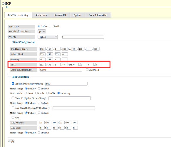

  • Router: Movistar RTF8115VW
    • LAN IP: 192.168.1.1
    • DHCP enabled
    • Primary DNS: 192.168.1.88 (Pi-hole)
    • Secondary DNS: 0.0.0.0
    • DNS Relay: Disabled

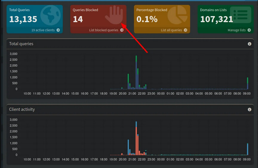

Pi-hole works, but barely blocks anything. The dashboard shows only a few queries.
Previously (in a simpler setup) every new webpage increased the query counter immediately, but now it increases very slowly β€” like if most DNS requests are bypassing Pi-hole.

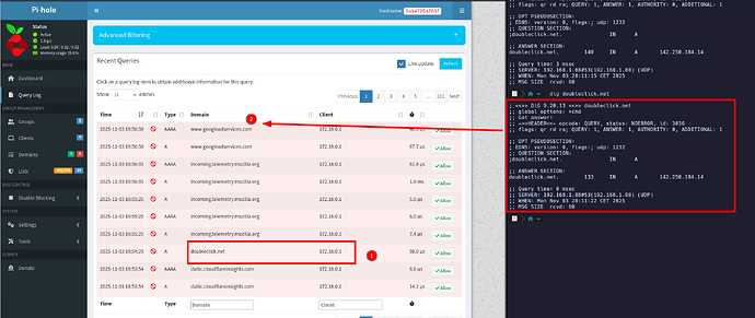

:white_check_mark: Confirmed Pi-hole is working locally:
dig @192.168.1.88 google.com
dig @192.168.1.88 google.com                                                                                                                    ξ‚² βœ” ξ‚³ 5s ο‰’
; <<>> DiG 9.20.13 <<>> @192.168.1.88 google.com
; (1 server found)
;; ->>HEADER<<- opcode: QUERY, status: REFUSED, id: 15595
;google.com.			IN	A
;; Query time: 0 msec
;; SERVER: 192.168.1.88#53(192.168.1.88) (UDP)
;; WHEN: Sun Nov 02 15:55:34 CET 2025
;; MSG SIZE  rcvd: 39

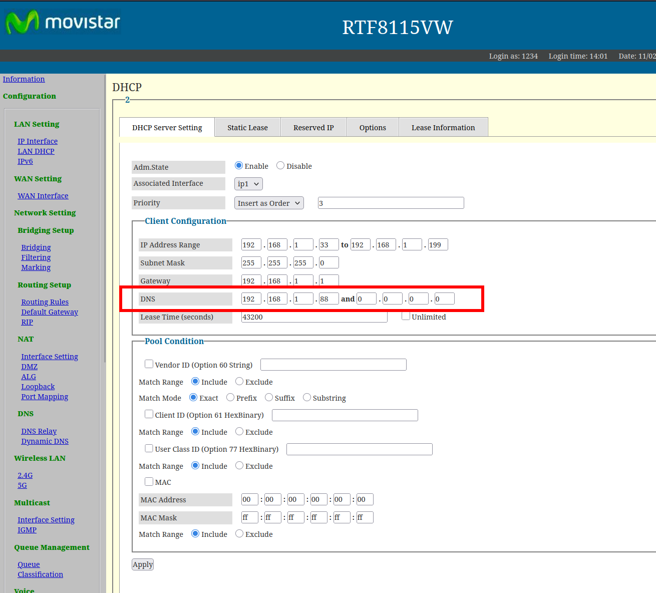

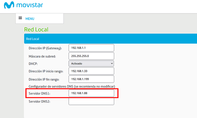

:white_check_mark: Router DHCP DNS set to only 192.168.1.88, no fallback DNS.

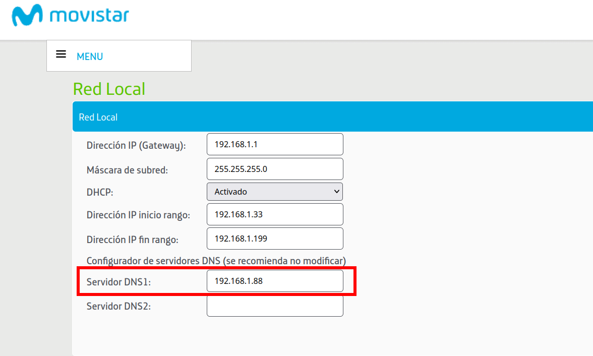

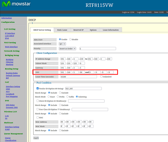

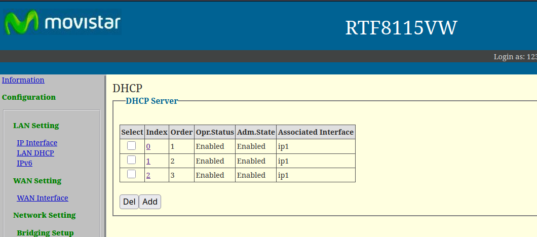

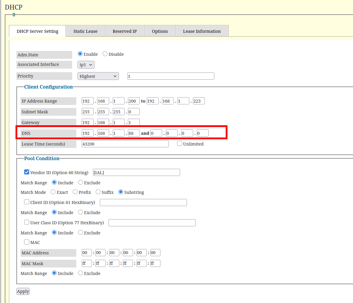

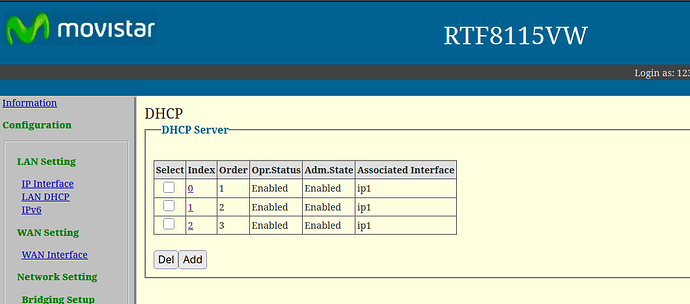

In the BASIC configuration of my router I have:
In the Advanced configuration of my router I have:
and inside of each one I have:
0
1
2
Still, Pi-hole only logs a few requests.
I want all DNS traffic in my network (wired and wireless through Deco AP) to go through Pi-hole for proper filtering.
What should I check or disable on the Movistar router to ensure DNS requests go directly to Pi-hole and not through the router itself?

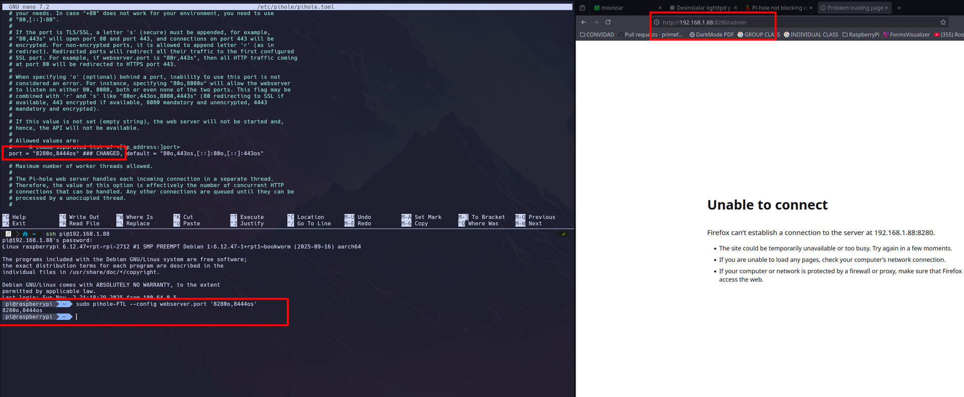

Also I tried to use the auto installer (not docker) but I had the port 80 in use by nginx via docker, I changed the port in lightpd file but when I'm trying to go to /admin I receive a 403 forbidden.
Sorry if I'm mixing topics but I'm trying a lot of ways to use pihole and I couldn’t yet :pensive_face:
Thanks for your time
Pi-hole v6 doesn't use lighttpd.
If you want to use Pi-hole without docker, you need to change Pi-hole port in pihole.toml, or simply use this command to change ports to 8080 and 8443 (change ports if desired):
sudo pihole-FTL --config webserver.port '8080o,8443so'

I wrote your command and also I tried changing manually the port in the file but doesn’t work.
Now I don’t receive the 403 Forbidden.
If you have more things to try, let me know here and tomorrow I will do it and update the post :slight_smile:
Thanks again @rdwebdesign
The message "Firefox can't establish a connection to the server" indicates a network issue.
Is there a firewall blocking these ports?

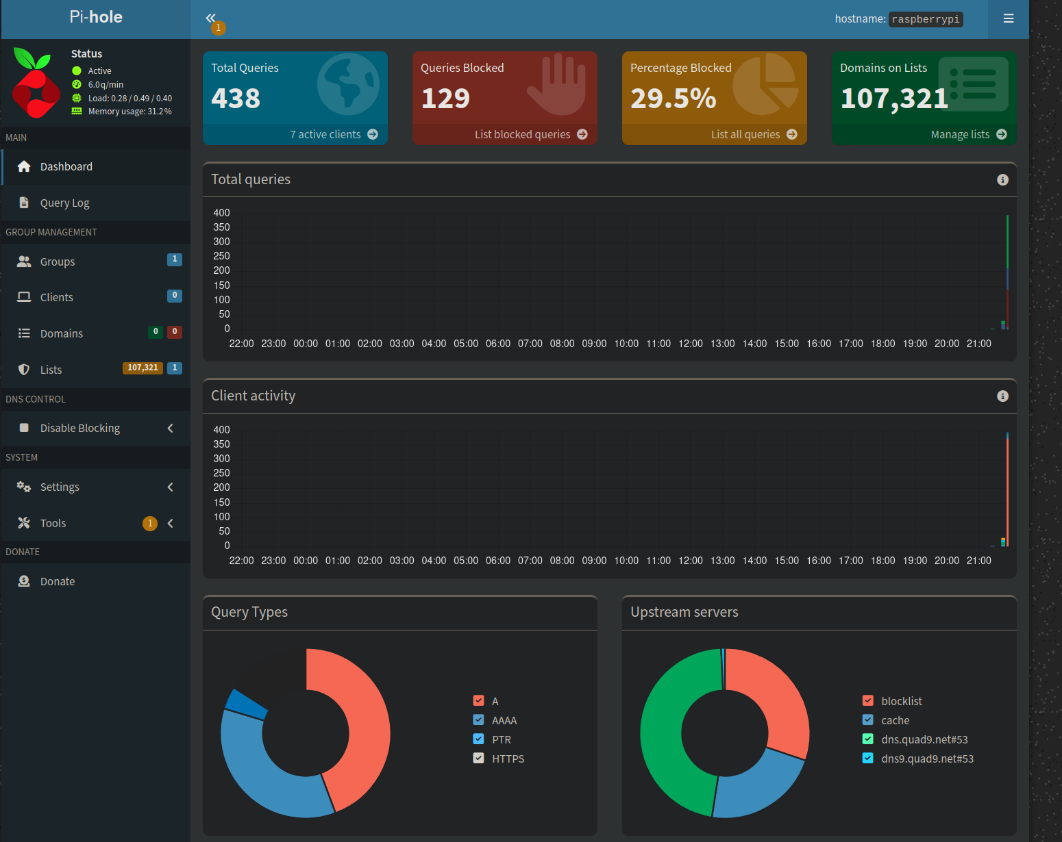

I tried 10 times doing the same and in one moment works. Now It’s working and it’s blocking

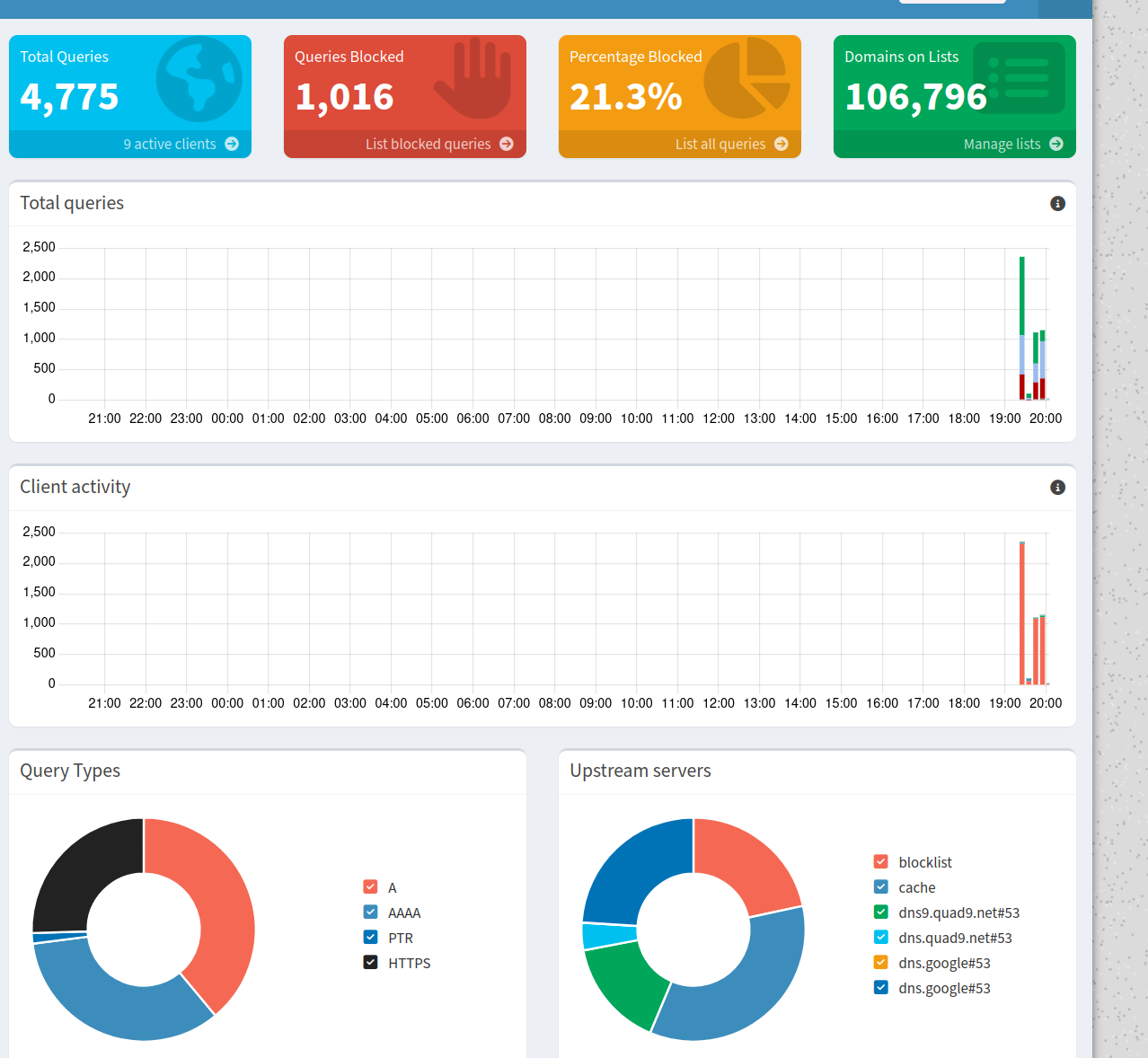

Here you have the debug: https://tricorder.pi-hole.net/yjDqPHbF/
I don’t know why, but now it’s working better and it’s blocking things but If i’m with my mobile it’s not working the ads, with the laptop yes.

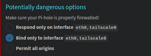

Also I realized the DNS options are readonly mode. I tried to change to β€œbind” in the docker-compose variables but when I putted eth0,tailscale0 like the autoinstaller version for my VPN, was not working correctly.

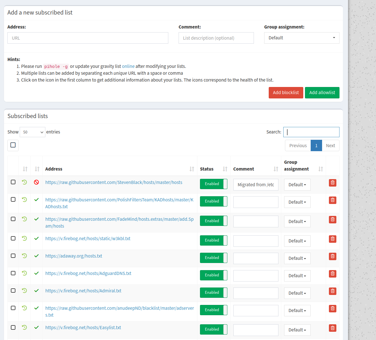

I have checked when I’m adding more lists from firebog (green links) and update the gravity, always I have the same number of lists. I don’t know why.
Let me know if you need something more.

eth0,tailscale0 is not a valid interface name. The interface can't be a list of interfaces.
You need to select one interface, or use "Permit all origins".
If ads are blocked on your laptop, but not on your phone, it means Pi-hole is working and your phone is probably not using Pi-hole as DNS server. You need to check the DNS settings on your phone.

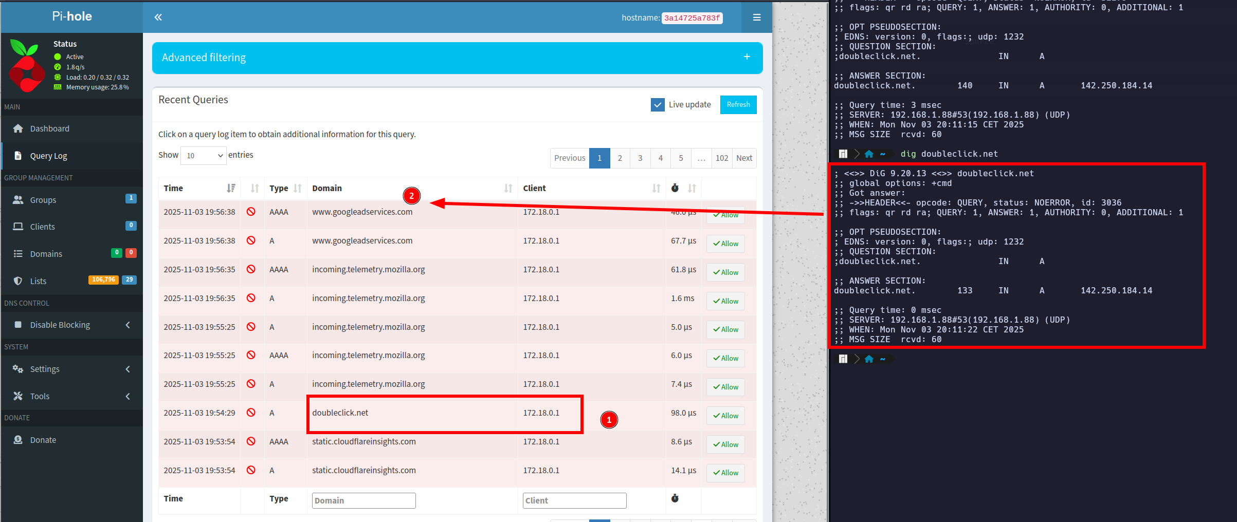

Now it’s weird. I didn’t change absolutely nothing and it’s not working.
In the beginning I did the command dig and was blocked perfectly (point 1). Now i’m doing the same and it’s not blocking (point 2, doesn’t appear).

This is normal when you set options via environment variables.
The interface name is invalid. I can't saying anything else because you never posted your complete compose file.
I can't say what is happening with your lists, because the debug log doesn't match the container used on the image above.
The log contains just one list.
