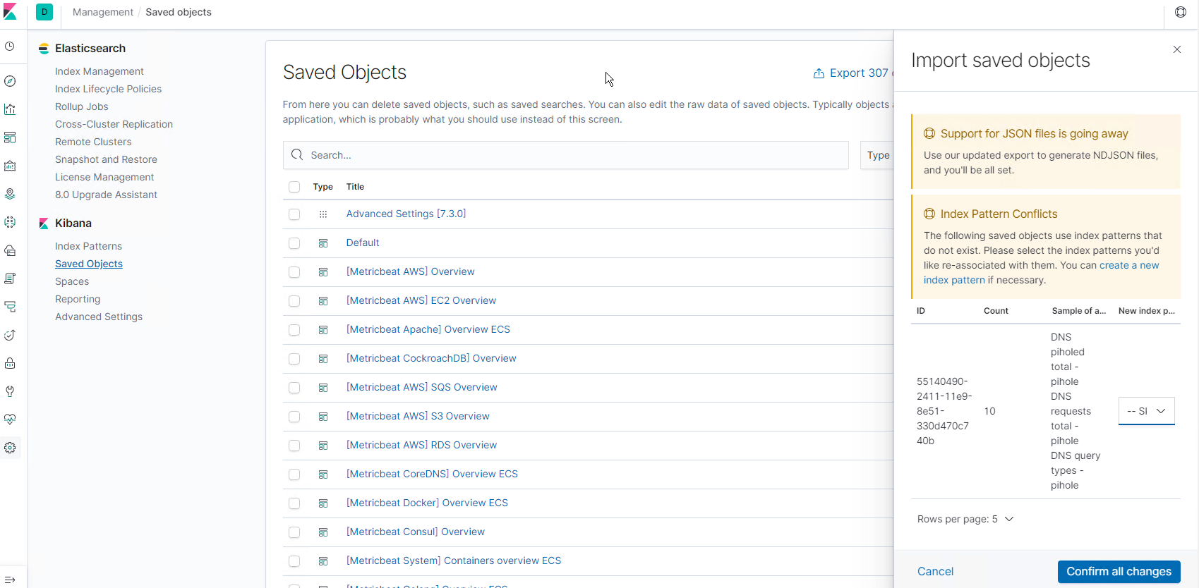

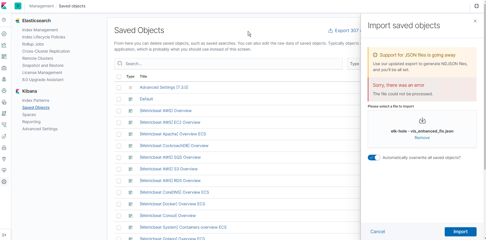

I've tried importing the json files but keep getting the error below:
File could not be read
[illegal_argument_exception] Could not find a timestamp in the sample provided
I'm trying to get elk-hole working on version 7.3. I imported all of the visualizations and dashboards but I'm getting "Could not locate that index-pattern-field ".

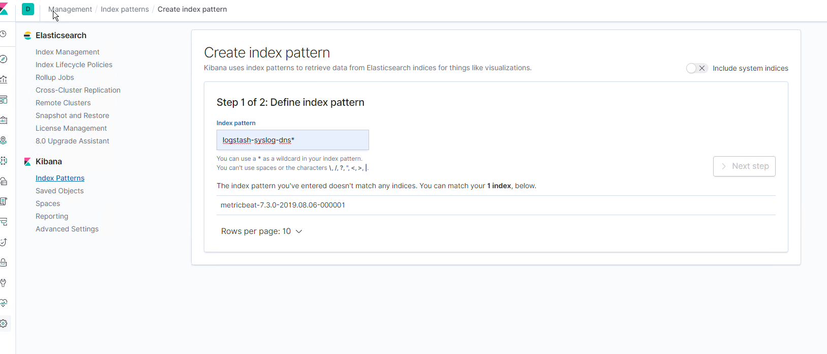

I'm not sure how to create an index manually. If I click on create index pattern from the management -> index patterns screen I get an error:
"The index pattern you've entered doesn't match any indices. "

logstash-syslog-dns* is the index pattern I use in kibana. Try create it please. If the index already exists it will show up (but it has to be this exact phrase)
You cant really create the actual index manually, it gets created via the very last line in the output section of 20-dns-syslog-conf

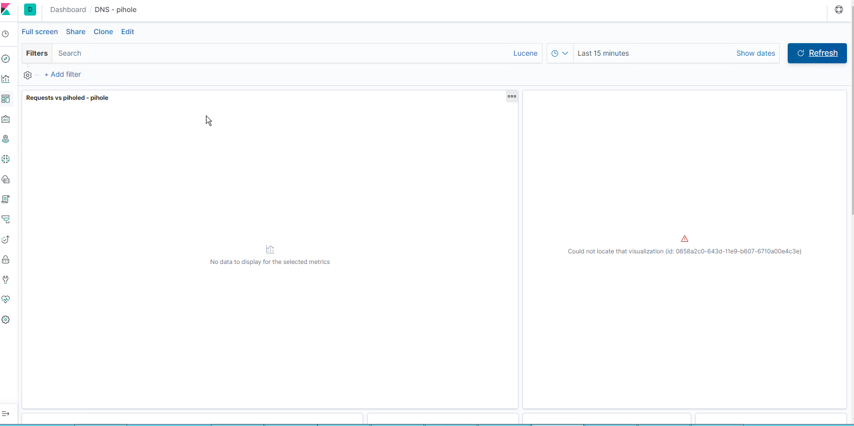

Got past the import problem and I'm so close I think, but after completing all the steps, when I click on the pihole dashboard in Kibana, I get this:
@tep1997 try this please
elk-hole/json/v7.x vis/filebeat v7.1/elk-hole - vis_enhanced_fix.json at master · nin9s/elk-hole · GitHub
retry please, typo ...
That worked. Closer, but now have the index problem:
the error sources from the missing index pattern "logstash-syslog-dns*" so we have to figure out why it wasnt created. Can you paste the content of the output section of 20-dns-syslog.conf please
