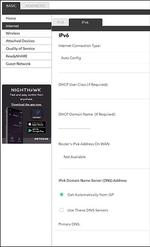

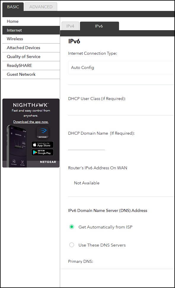

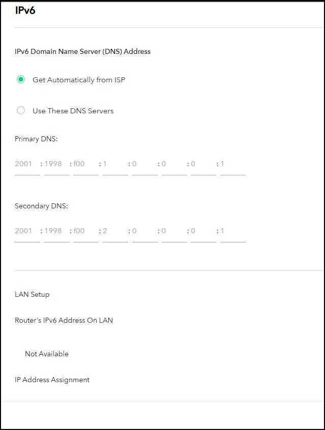

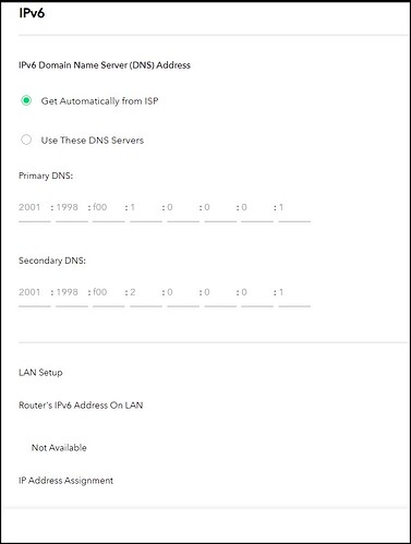

There is only one router device, the RAX70. I’ll attach these pictures because when I look at the IPV6 tab in the router settings, it asks about a IPV6 DNS but I do not know how to find or create the dns addresses for IPV6. I have looked on the pihole help help pages but have not found anything so far.
I feel like I need to swap to “Use these DNS Servers” rather than “Get automatically from ISP” and fill in the Primary and Secondary DNS lines but what and where do I get the numbers because the numbering scheme is different than IPV4

I'm not familiar with Netgear routers at all, but your screenshots look like configuring the DNS servers your router itself would use, i.e. your router's upstream DNS servers.
That'll catch any by-passes, but as explained, you won't be able to attribute DNS requests to original individual IPv6 clients in such a configuration.
It would be preferred if you could instead configure your router to not advertise any IPv6 addresses for DNS at all, or one of your Pi-hole machine's IPv6.

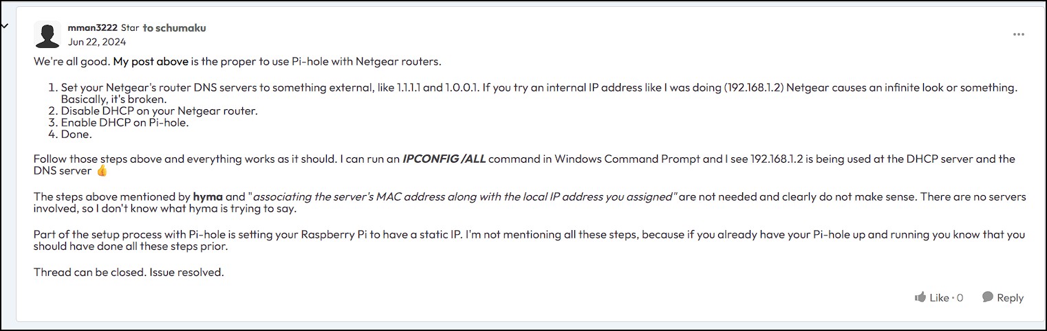

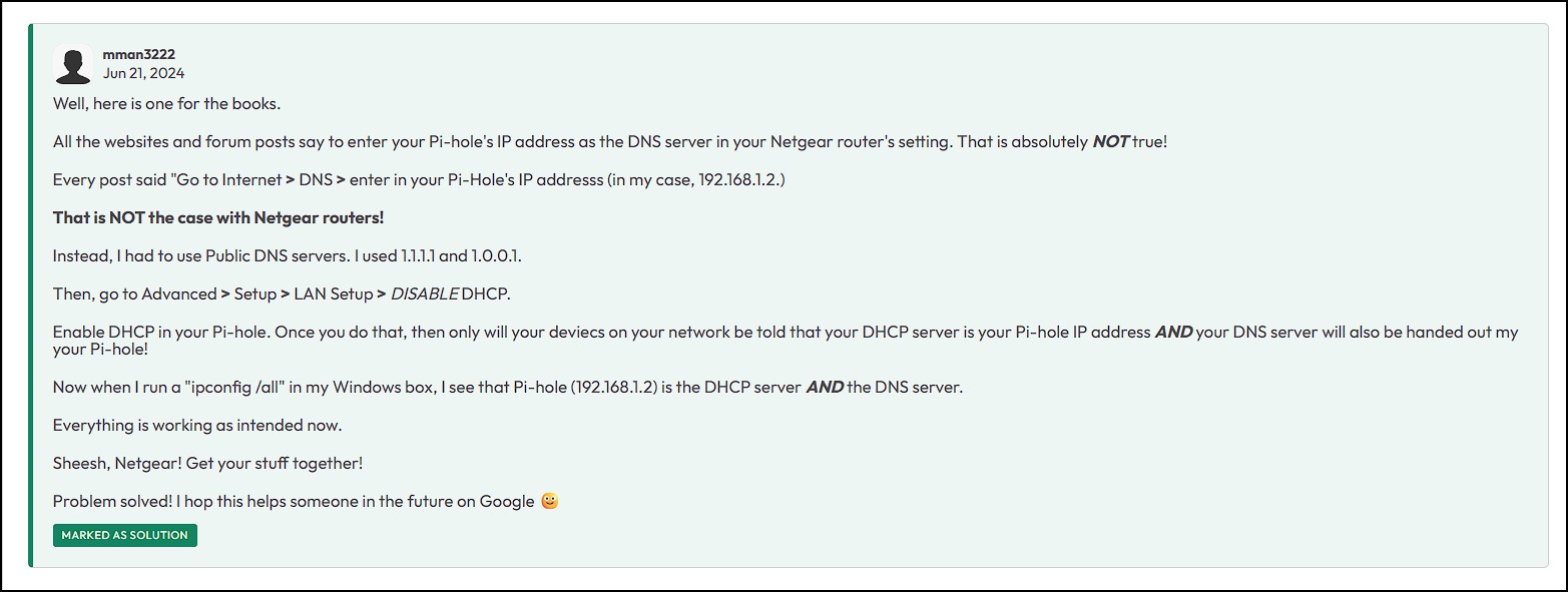

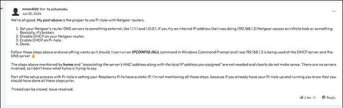

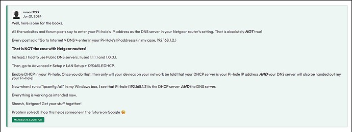

I came across this in the Netgear community forum and wanted to ask if you are familiar with this issue. My Netgear router DNS is set to the Pi-Hole which this says is wrong. The bottom picture seems like a less wordy explanation of the top picture.
It's not really wrong, but if you set Pi-hole on the Internet > DNS option, only your router will be seeing on Pi-hole web interface.
All devices will use the router as DNS server and only the router will use Pi-hole.
As far as I know, most Netgear routers only allow to set the DNS server on the Internet > DNS option. You probably will need to use Pi-hole as DHCP server.
