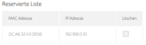

First, I think the router does not keep the raspberry's IP static with DHCP set off. Once I disable its DHCP the whole menu gets greyed out including the list with reserved IPs.
So i think, that after my router's pre set lease time of an hour, it assigns another IP to the raspberry which causes it do not be accessible anymore from any device in the network (no matter if it appeared with a DHCPACK message in the log before or not). This would explain why it never works longer than an hour. I also am not able to access the router config page from the raspberry after it disconnected. If I try to reconnect a device it says "IP address could not be retrieved".

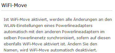

Another thing regarding the TP Link DLAN:
if I have to reset the router I always have to disconenct the DLAN, otherwise it will keep the SSID and DHCP settings as before and will still be not accessible.
it has this WiFi Move option which could be responsible for that:
So the adapters seem in fact to have some influence in the network which takes time to figure out someone without IT knowledge...

I have allways accessed the UI via pihole's IP directly (as I also did with the router and DLAN config pages), so I am pretty sure that "nslookup pi.hole" would not give any results. Also from my understanding, this shows that not only my device is disconnected from the pihole but also from the router after "breakdown".
Except from the DLAN I cannot imagine that any other connected device would have DHCP funcionality (PCs, smartphones, TV, LED controller, smartwatch, robot cleaner)
Your recent findings would contradict some of your previous observations, but that may be attributed to swapping your DLAN access points in and out for testing. (Makes it harder for me to follow, but I understand you are doing so to pinpoint your issue :wink: ).
Let's stick with the current facts, bringing us closer to a solution:
Lack of static definitions would indeed have your Pi-hole request a new DHCP lease after its router-sourced lease expires, and it would be your Pi-hole's DHCP server answering it.
Since its DHCP pool is ranging from .50 to .251, your RPi wouldn't be able to acquire its old .10 (unless you've setup a corresponding lease reservation in Pi-hole's DHCP).
All devices having requested a DHCP lease before that IP switch-over would now continue to talk to the retired .10 address until the lease expires.
Yet all devices requesting a DHCP lease from Pi-hole's DHCP server after that IP switch-over would receive the correct new DNS server IP.
Still, you don't want Pi-hole to switch IP addresses in general.
I am confident that your static definitions in /etc/dhcpcd.conf will bring you back to normal, at least as long as you leave out your DLAN access points. Bring them back in once you've verified it's working as expected without them. That way, we'd know that any remaining issues had to be caused by them.
