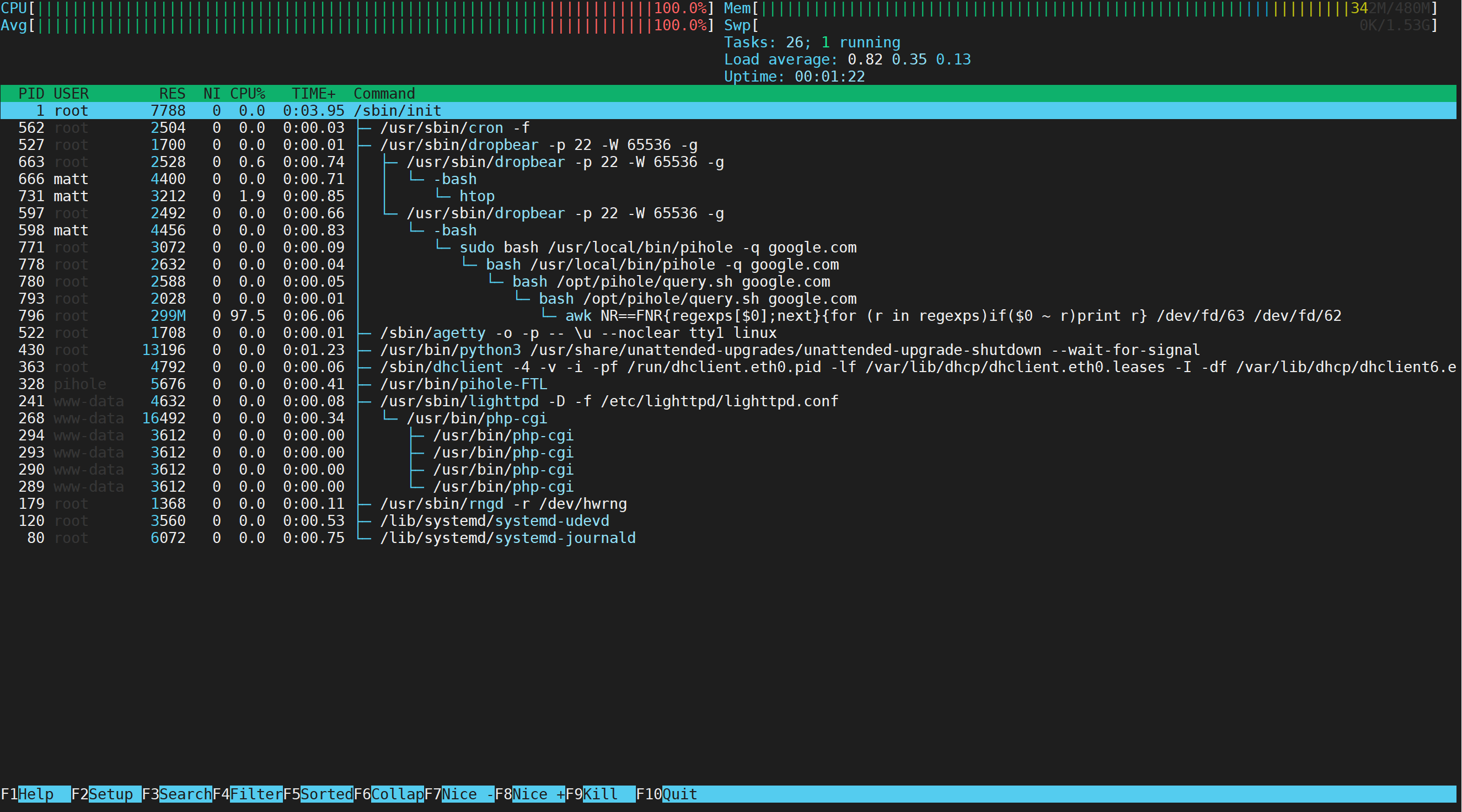

Rather than do a full pihole -d (takes about 30 minutes), I ran time pihole -q google.com (only takes 11 minutes) after disabling conditional forwarding. It has not improved performance, and I'm still having the same issue. Here's a screenshot:
https://imgur.com/YljqUnE
The CPU usage fluctuates during the process, but RAM stays completely throttled the entire time.

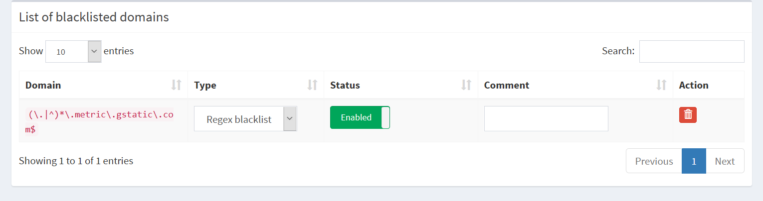

Found the culprit:
(\.|^)*\.metric\.gstatic\.com$
The * appears to break -q.
This is not a valid regular expression. The interpretation of (\.|^)* is:
An arbitrary number of dots or line starts
Does "an arbitrary number of line starts" make sense? I guess not and awk might die while trying to reference to the same anchor multiple times. This may very well end up in an infinite loop.

I went with the more aggressive approach. The only reason the * slipped in there is because I was totally spaced out when entering it and was just thinking I wanted to block *.metric.gstatic.com with * as the wildcard, then just clicked wild card and moved on with my day.
Thanks for the help sorting this one out! Apologies for my poor regex experience.
