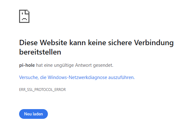

I tried to use it with my own certificate, regarding to the logfile the certificate was loaded correctly
2025-02-22 16:04:22.268 CET [320946M] INFO: Reading certificate from /etc/pihole/pi-hole_key-cert.pem ...
2025-02-22 16:04:22.268 CET [320946M] INFO: Using SSL/TLS certificate file /etc/pihole/pi-hole_key-cert.pem
2025-02-22 16:04:22.269 CET [320946M] INFO: Web server ports:
2025-02-22 16:04:22.269 CET [320946M] INFO:   - 80 (HTTP, IPv4, optional)
2025-02-22 16:04:22.269 CET [320946M] INFO:   - 443 (HTTPS, IPv4, optional)
2025-02-22 16:04:22.269 CET [320946M] INFO:   - 80 (HTTP, IPv6, optional)
2025-02-22 16:04:22.269 CET [320946M] INFO:   - 443 (HTTPS, IPv6, optional)
But with my certficate https isn't working anymore
Ever since NIST accepted that random number generator that is supposed to have an NSA backdoor (or weak spot), people tend to tread carefully with NIST. Therefore the brainpool curves seem to come from academia and more scrutinized. Even your BSI recommends a brainpool curve in one of their tech advisories.
Did you check the certificate entries?
Try openssl x509 -in </path/tp/certfile> -text. Check if there is something off with the algorithms, dates etc. New browser versions tend to be picky there.
But given the error message it looks like there is no valid reply from port 443 via TLS. Although the log file states otherwise. Strange.
Did you accept the CA certificate in your Windows cert store as trused?
I guess that post was for me?
Yes i have, i use several certificates that are signed by my CA
For mee it looks correct

I guees that it is an problem of the webserver that is not supporting the needed chiphers
# Fehler: Gesicherte Verbindung fehlgeschlagen
Beim Verbinden mit pi-hole trat ein Fehler auf. Die SSL-Gegenstelle konnte keinen akzeptablen Satz an Sicherheitsparametern aushandeln.
