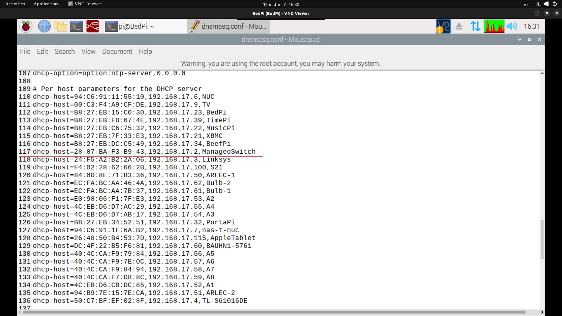

DHCP host has multiple names at line 117 of /etc/pihole/dnsmasq.conf
So.....
That file:
There aren't any MULTIPLE NAMES I am can see.

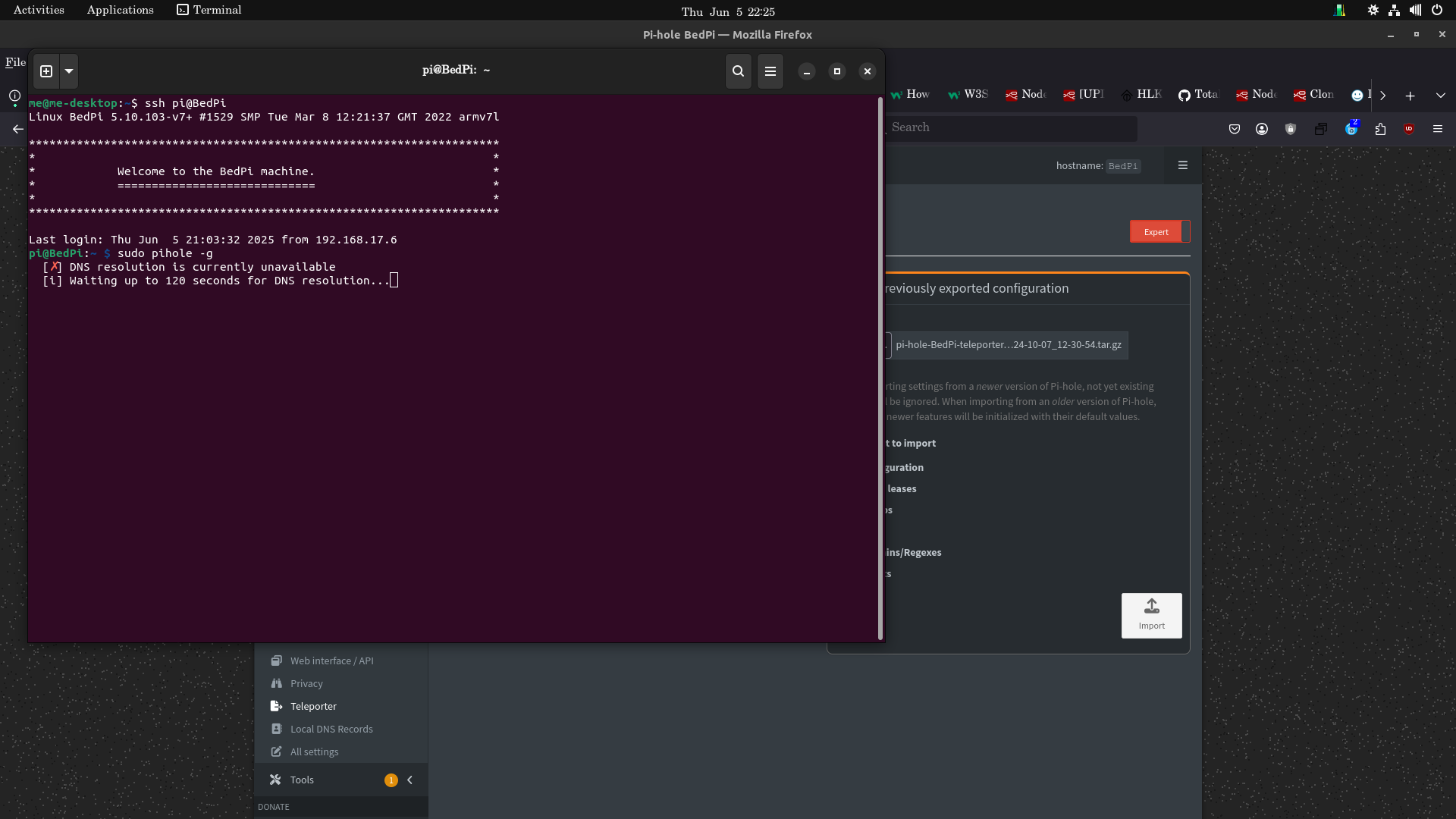

It went through and SUPPOSEDLY updated, though it did tell me to update something else like pihole -g.... I didn't document it.
Typed it and it just fell over.

The DNS won't run as long as the configuration is invalid.
Is there a reason that line 117 is using hyphens rather than colons in the MAC?
The other thing to check would be that you don't have any of these hosts duplicated in other files in /etc/dnsmasq.d.

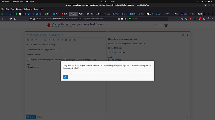

First off the files.
FTL.log.txt (6.7 KB)
And...
(It says 6 meg)
And it is... So why am I seeing this?
A cut down version.
1.7 meg rejected now too.

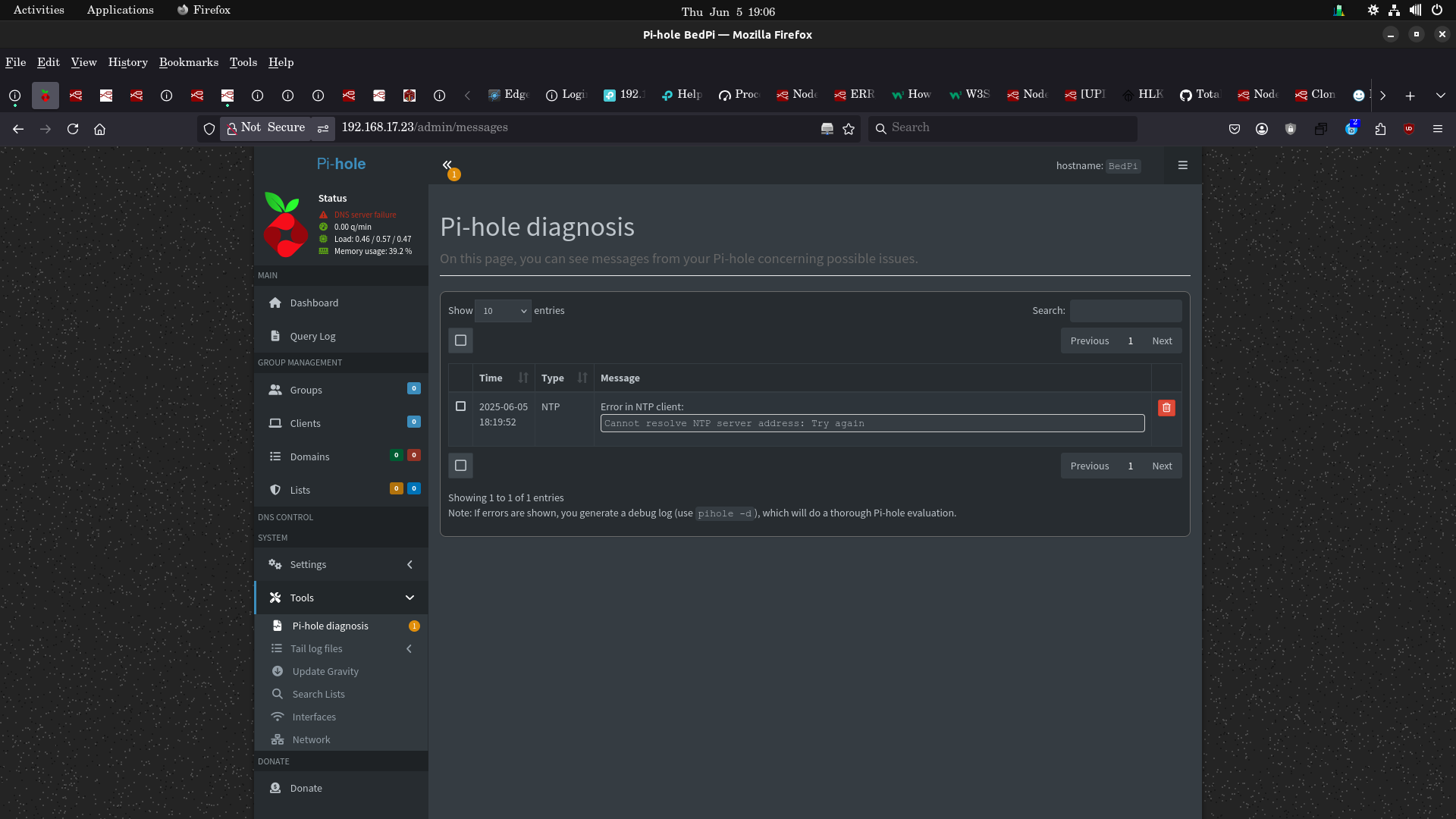

UPDATE:
Ok, brain kinda let a bit of information out just now.

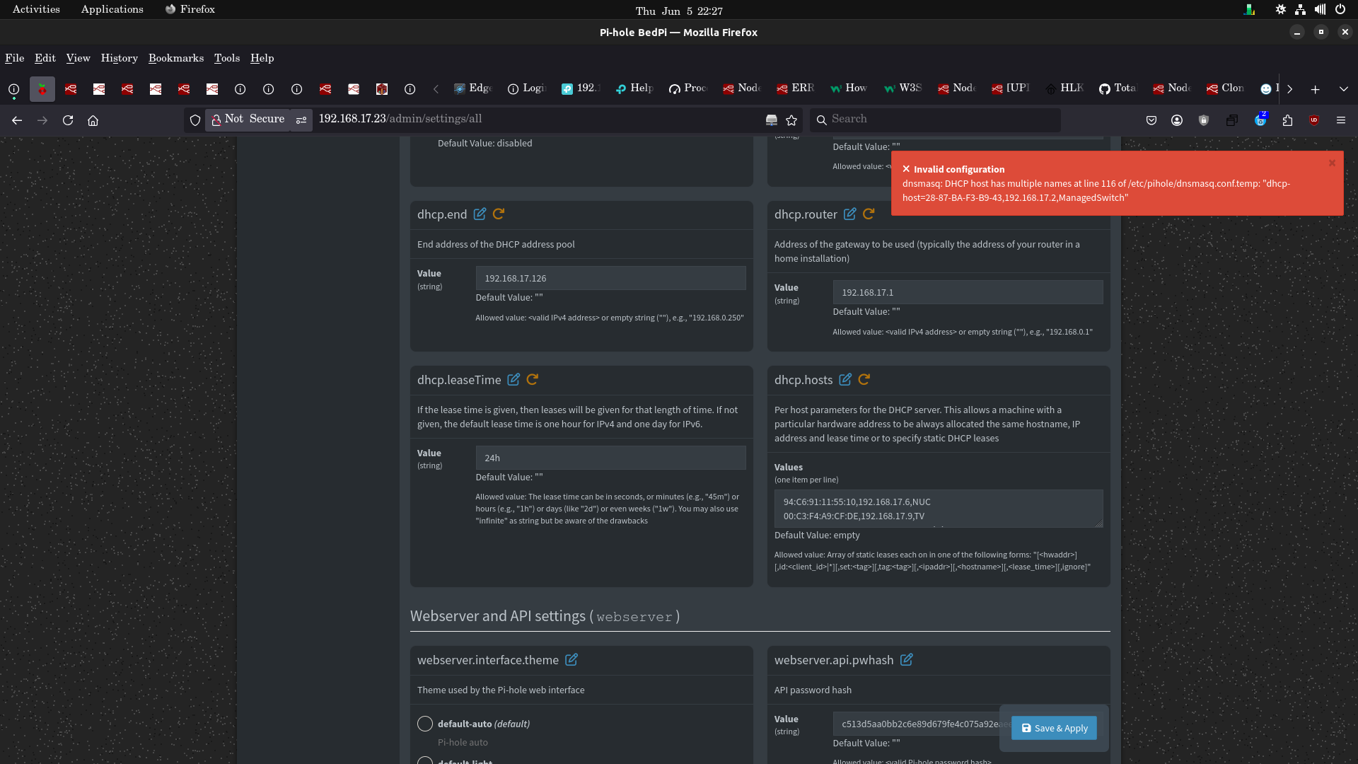

I went to the Pihole page and saw the "warning" and looked at it and saw the error/message about the "duplicate entry in line 117..."
Enter pihole -d to upload report
Did that, and it just died on me and that's kinda where it all started.

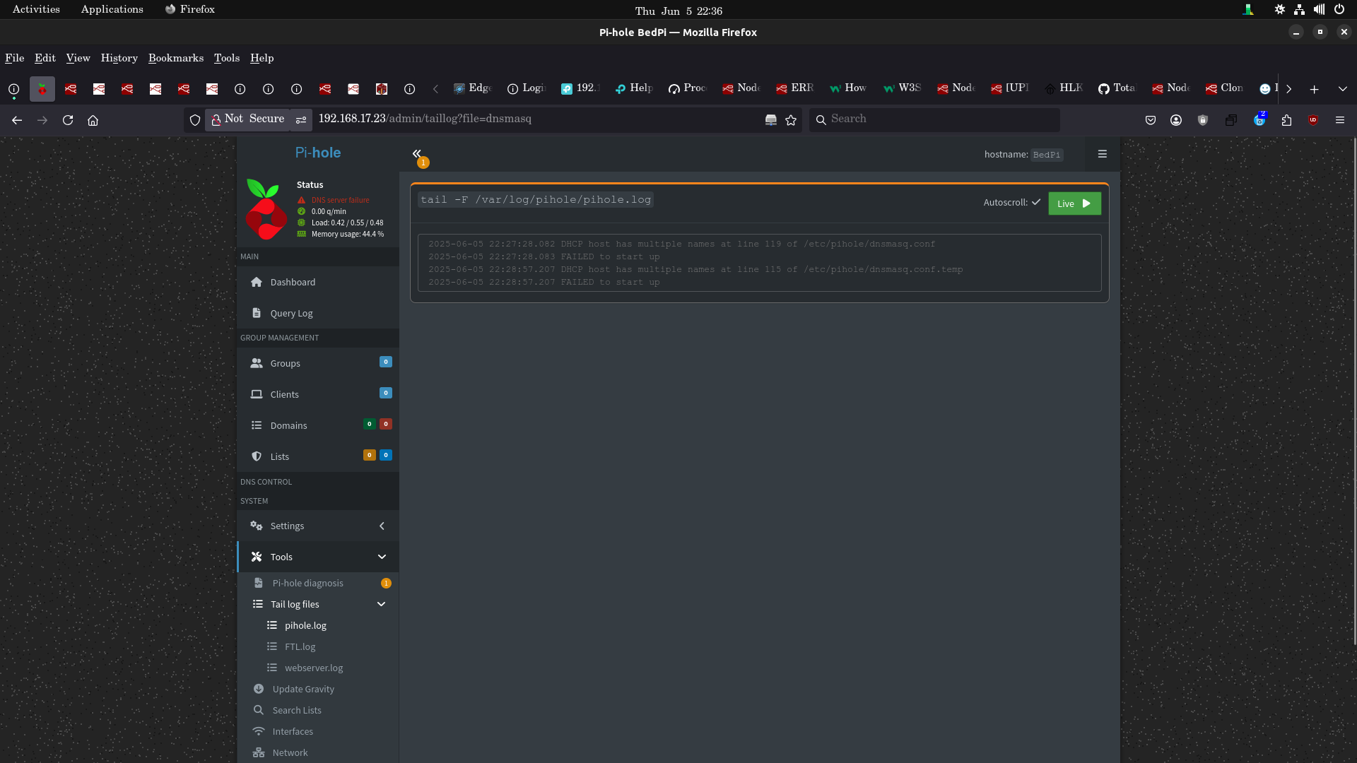

Ok, something else is happening.
Still not working.
I keep getting/seeing this "problem" in the tools/pihole diagnostics part:
But - adding insult to injury - there is a second file mentioned as well.
The temp file.
So I ssh to the machine and sudo nano /etc/pihole/dnsmasq.conf file.
Edit it, change the - for : in said line.
But the program seems STUCK at this point.

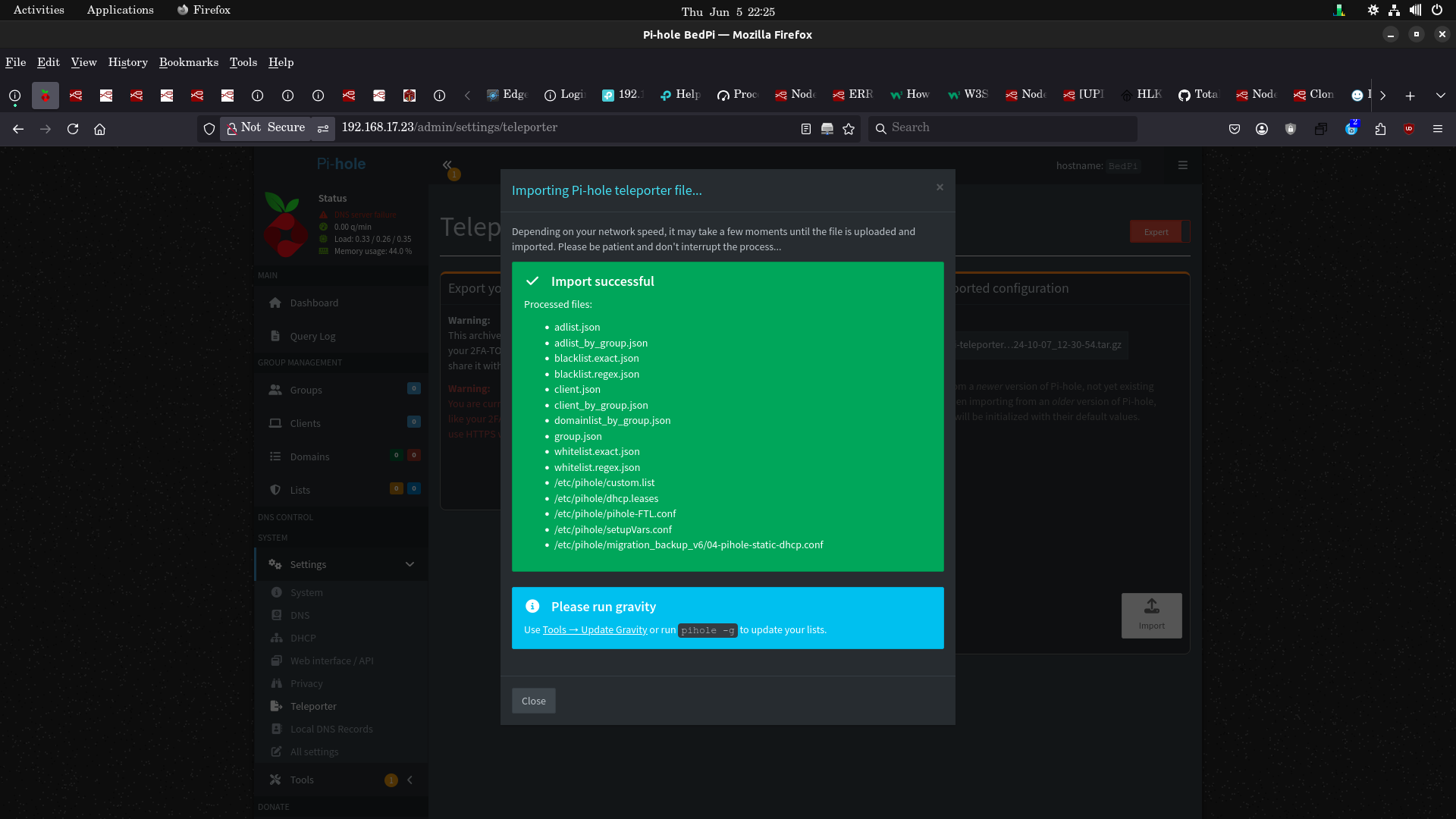

I also realise I need to import my "old" settings to get back the block list.
Import and...
I try that and....
Then I'm back to:
Sorry if there is repeats in there.
I feel I am so close.
Ok, so next question: (Should I be this far ahead of myself?)
As importing the "old" file/profile/what ever has the wrongly formatted mac address.....
Can I edit that file before I import it?
That way getting around that problem?

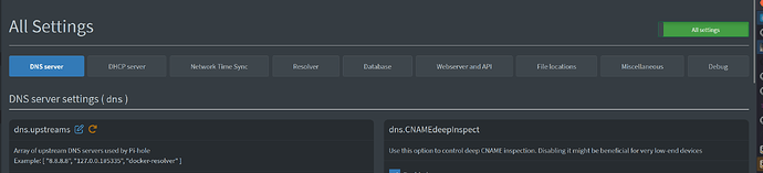

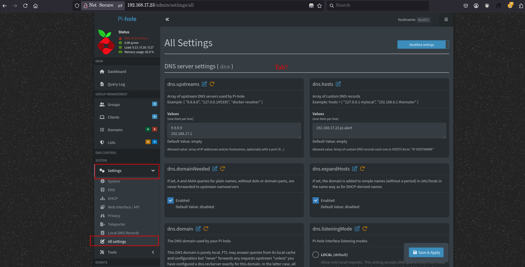

You didn't post a debug token, so we can only guess, but you probably have conflicting settings in your dnsmasq files.
Go to Settings > All settings page, Miscellaneous tab and disable misc.etc_dnsmasq_d.
This will restart Pi-hole without the extra config files.

Click on the blue "Modified Settings" button. You're only showing the modified settings, you'll see the tabs when that button is a green "All settings"
Your log shows the option is already disabled.
It means the issue in /etc/pihole/dnsmasq.conf file. Apparently you manually changed something directly on this file and broke Pi-hole.
You should never change /etc/pihole/dnsmasq.conf.
The file has a big text explicitly saying:
#                     FILE AUTOMATICALLY POPULATED BY PI-HOLE                    #
#    ANY CHANGES MADE TO THIS FILE WILL BE LOST WHEN THE CONFIGURATION CHANGES   #
#            IF YOU WISH TO CHANGE ANY OF THESE VALUES, CHANGE THEM IN           #
#                             /etc/pihole/pihole.toml                            #
#                             and restart pihole-FTL                             #
#           ANY OTHER CHANGES SHOULD BE MADE IN A SEPARATE CONFIG FILE           #
#                       WITHIN /etc/dnsmasq.d/yourname.conf                      #
#    (make sure misc.etc_dnsmasq_d is set to true in /etc/pihole/pihole.toml)    #
#                      Last updated: 2025-06-05 16:19:34 -03                     #
#                               by FTL version v6.2                              #
Changing the values on this file won't work. The file will be recreated when FTL is restarted. You need to change the values via web interface or editing /etc/pihole/pihole.toml.
I guess your issue is ManagedSwitch MAC Address was set using dashes instead of colons. Edit the entry using the web interface or editing /etc/pihole/pihole.toml.

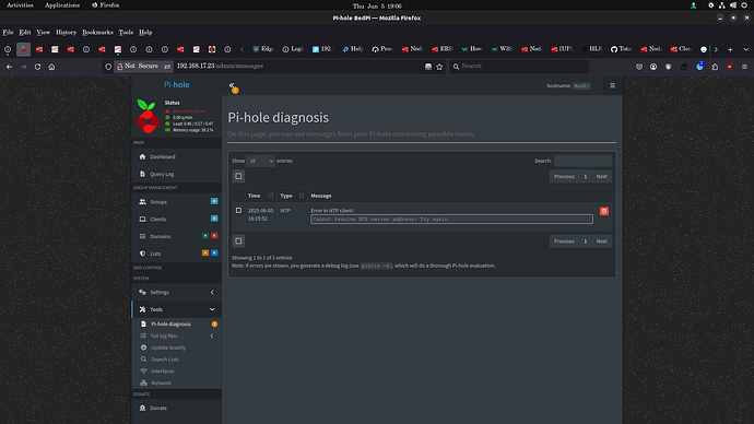

What about this message:
NTP...

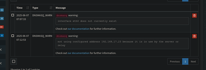

Now I'm seeing
interface eth0 does not currently exist
Yeah, there is a link, but to cover all bases.
As the warning says. Likely caused by an interface=NAME option where the interface NAME does not exist. Check if your operating system may have changed from simple (like eth0) to predictable (like enp2s0) interface names. Update your configuration accordingly.

slight update - though in the wrong direction:
Now I'm seeing:
Though I suspect there may be a problem somewhere, as the network PiHole is on has it's own DHCP server, and DNS server.
Digging into the second problem:
Handing out addresses used by known critical infrastructure (like the DHCP server or a relay) is prevented to avoid IP address duplication issues.
This can happen when you have configured a static address assignment for the IP address of your Pi-hole. As this could result in an IP address conflict, Pi-hole offers a different free address from your configured DHCP pool. As this means Pi-hole behaves differently than you configured it to, it issues a warning.
The solution would be to either remove the static reservation for the Pi-hole itself (see ADDRESS in the warning) or simply accept this warning as it should only happen during debug log generation. When this warning appears outside of a running DHCP test, check that your Pi-hole is indeed using a static address.
