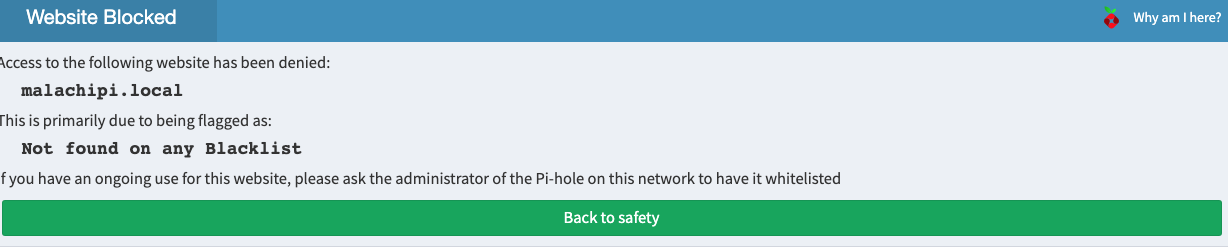

I'm having a similar problem - I added *.local to the white list in the browers and I'm getting - the following screen shot (which makes no sense whatsoever.
What should I be doing to whitelist sites?

That "Not found on any Blacklist" is a 404 error. http://malachipi.local
is 404.
I know that a 404 is page not found but I don't know how that relates to what I need to do. malachipi.local is the host name of that has the pihole server. I can connect to it if I use the ip and I can ping malachipi.local and get the ip resolved. I've white listed malachi.local - what do I need to do?
As an aside would it be possible to say page not found 404 rather than Not found on any Blacklist?

The domain malachipi.local
resolves to the right IP address. What ever web page you intended to see at http://malachipi.local
is broken and the web server at that address is returning a 404 error.

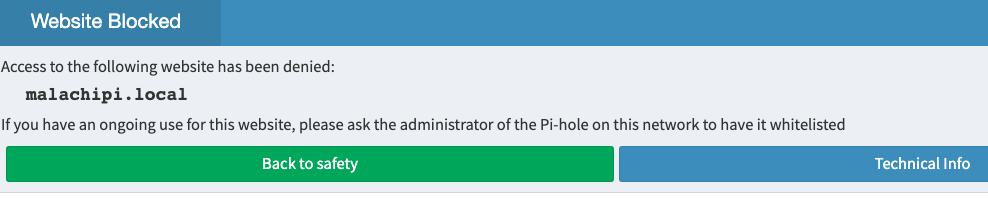

So I set BLOCKING_MODE=NULL
but the address malachipi.local now results in a page that says:
malachipi.local been whitelisted, and points to the pihole web server.
What should I try next?

Not quite - malachipi is the host name of the raspberry pi that is running pihole, malachipi.local is it FQDM. There are no other webservers on the raspberry pi. I am trying to connect to the pihole webserver that is running on the raspberry pi. I can successfully ping malachipi.local
and also successfully ping 192.168.1.27
, I can connect to the pihole webserver via http://192.168.1.27/
in the browser but if i cannot connect to the pihole webserver using http://malachipi.local/
in the browser instead I get the page from pihole saying malachipi.local needs whitelisting.
I'm trying to connect to the pihole webserver via http://malachipi.local/
- I thought that would be a simple straight forward test that everything is working correctly.
Given that pihole is serving the page I posted above surely it must just be a bug in the pihole webserver and not in the FTLDNS - else I wouldn't get the notice page.
Unless you put something there, there isn't anything to display at http://malachipi.local
. That's why you're seeing what you are seeing. The only domain that works for automatic redirection is http://pi.hole
. That will redirect you to http://pi.hole/admin/
. So if you are trying to get to the admin page then you'll need to go directly to it: http://malachipi.local/admin/
(with the trailing slash). The reason for that is to prevent a blocked domain from getting to the admin page.
