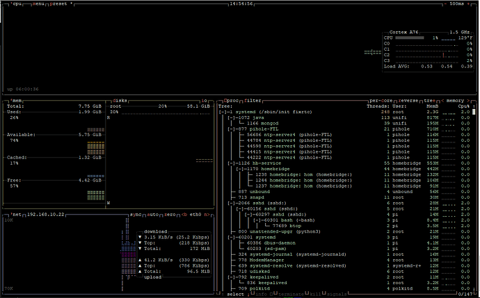

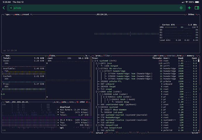

I don't think so. Here's the view from btop showing Pi-hole at 3.9 GB:

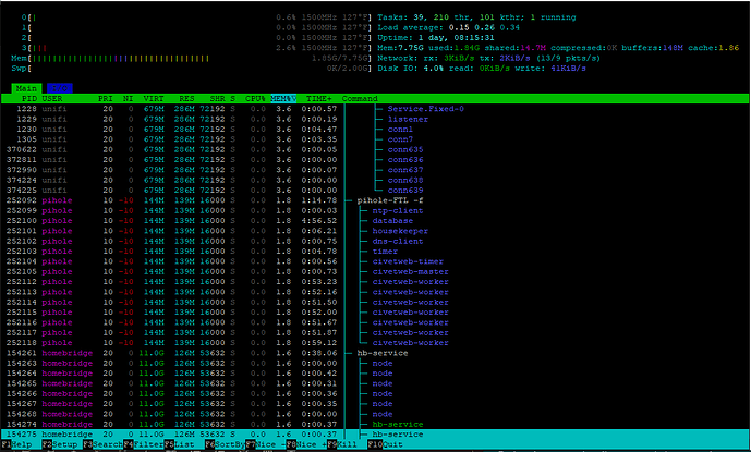

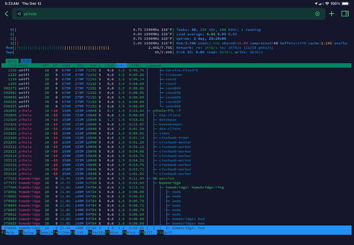

The extra processes are probably dedidcated TCP workers, please run something like
grep 2076641 /var/log/pihole/pihole.log

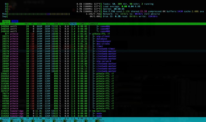

to see if there is anything related in the log file. They should terminate themselves after a short timeout, I will try to reproduce why they don't. The memory htop claims they are using isn't actually used. Linux uses a method called copy-on-write (COW) which ensures that additional processes (that are copies of another) do not need to duplicate the memory when splitting out.
Your htop and btop screenshots are in conflict with each other, have they been done at the same time?

I checked the related code changes again and found nothing that would justify any difference with regard to development. Could you create two new screenshots at (roughly) the same time from htop and btop so I can compare them?

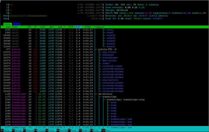

FTL uptime= 1 hour
Thanks. Noteworthy right now: we do not see any extra pihole-FTL -f processes in htop (and we don't see any threads in btop).

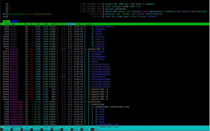

After 5 hours:
When we look now at htop, we see 1.7% for the entire FTL process which is about 1.7% * 7.75 GB = 131 MB. This agrees well with the memory btop claims each of the pihole-FTL processes is using. This suggests btop is incorrectly handling the COW principle I have talked about above. Seems have found a btop bug.
Also, have a look at the sum of used memory at the systemd process (2.3G) and then at the total used memory which is more than 10% less. Another indication that something isn't right here. Yes, I know, you may say btop's MemB is RSS and - as such - inaccurate, however, "used" memory also includes memory used by the kernel, modules and, e.g. shared memory. Hence, the real difference between the shown 1.99 GB and the sum of the memory used by all the processes under systemd will in reality be even larger.
Just out of curiosity: Which version of btop are you running? My local version is v1.2.13 and I do not seem affected by this at first glance (compare 1 and 2, especially the total sum of systemd at the top of 2):

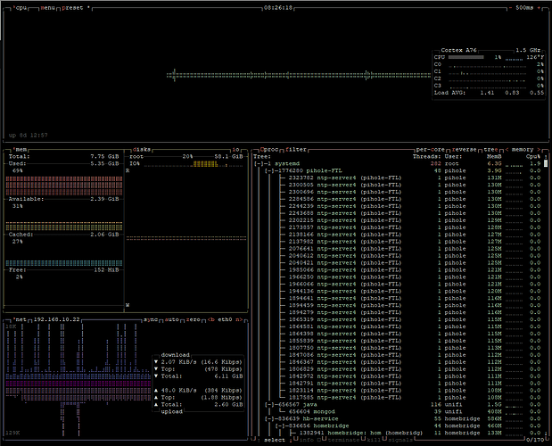

Total used: 3.38GB and systemd: 3.9GB
The processes are starting to increase, along with system memory consumption.

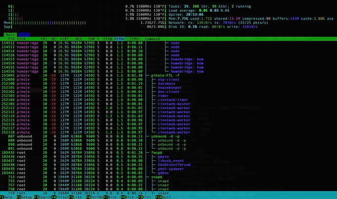

11 hours into disabling the FTL's NTP server and no 'stray' processes have appeared. Memory consumption has been normal as well.
pi@pi5:~$ free -h
               total        used        free      shared  buff/cache   available
Mem:           7.8Gi       2.0Gi       3.9Gi        14Mi       2.0Gi       5.7Gi
