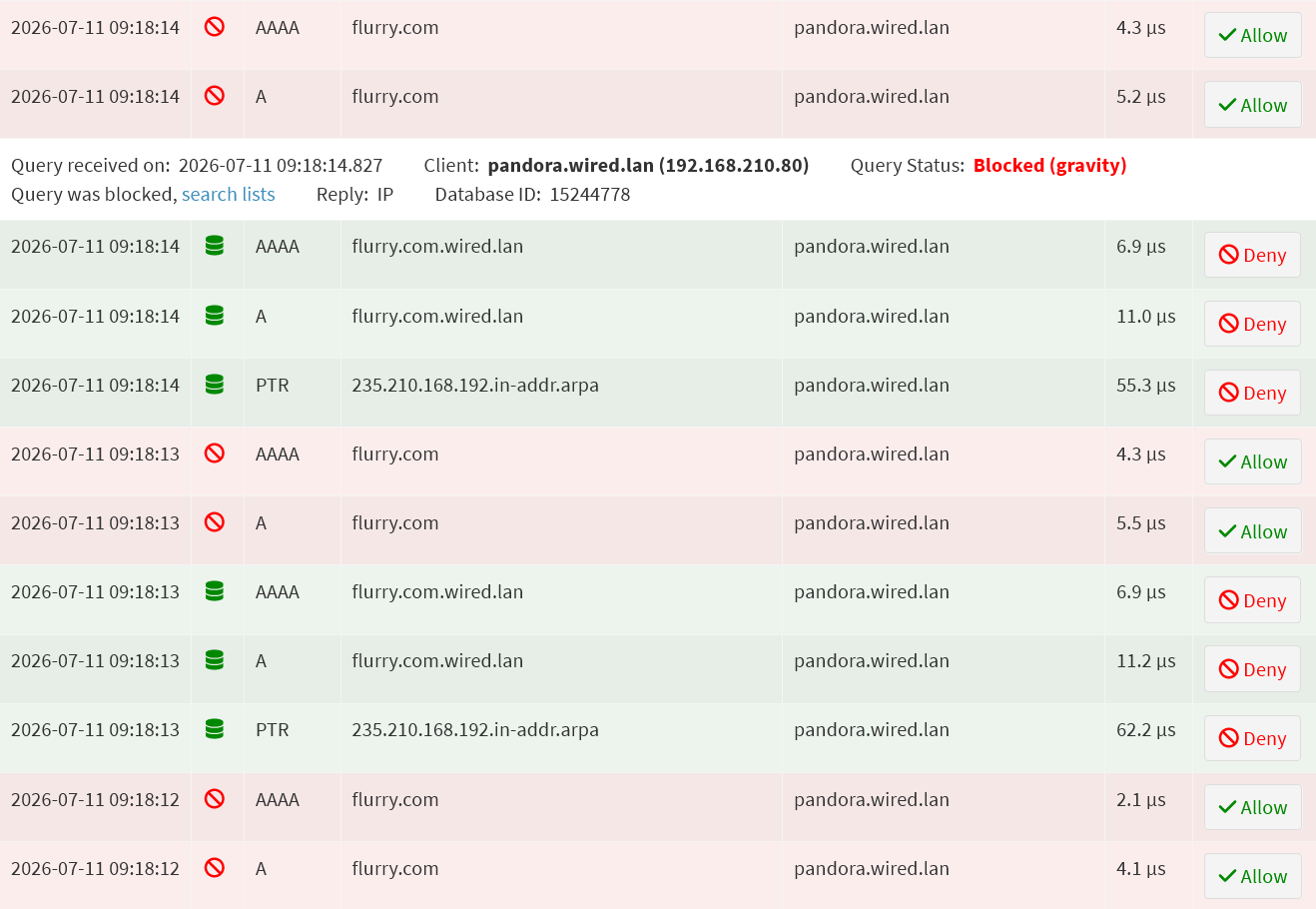

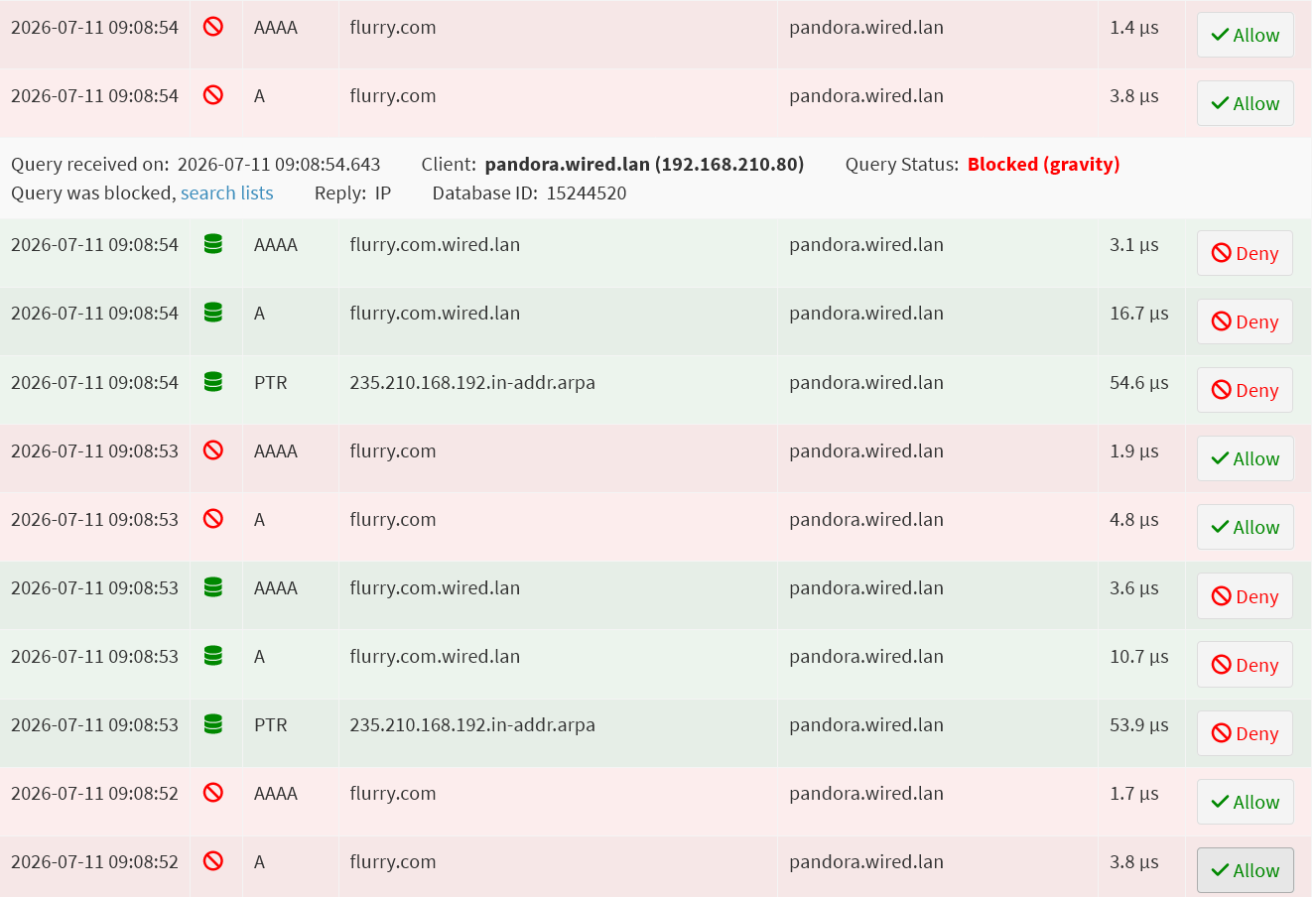

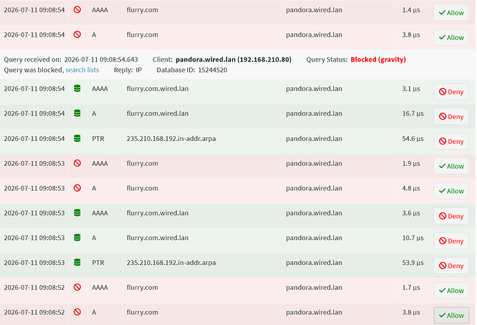

The image below shows how this looks like in the query log.

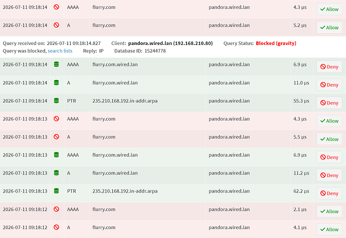

Below how it then shows up in the query log.

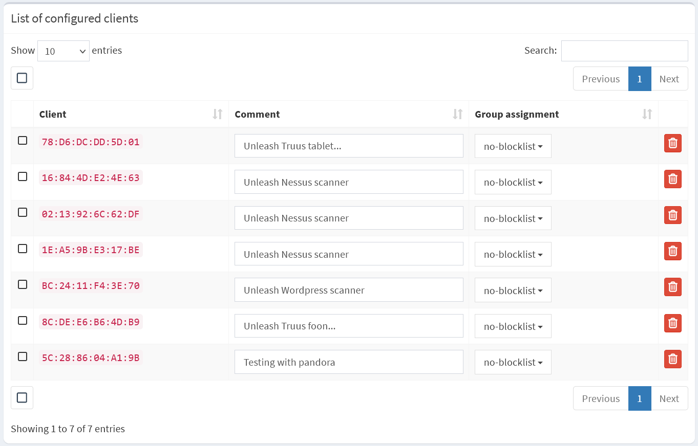

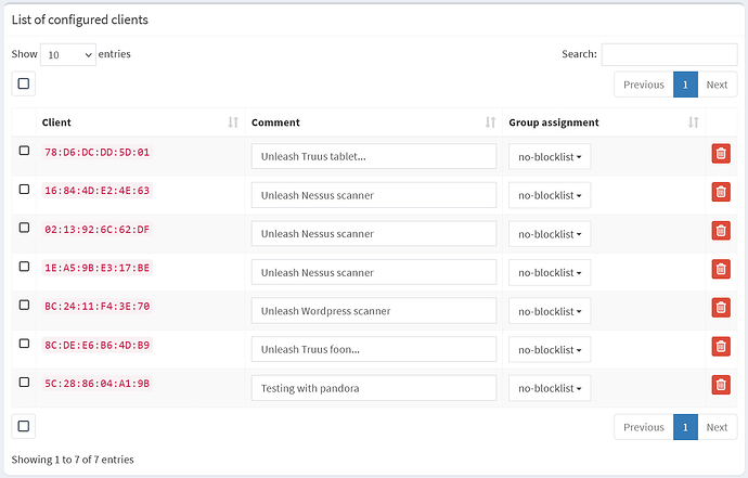

Below the list of configured clients - part of which is Pandora - the one I tested with.
