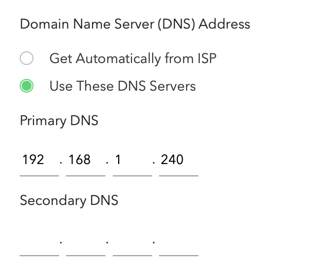

DNS is setup on a Netgear Nighthawk RS700S router. Everything appears to be working as expected. The IP in the error above is the router address. The pi-hole is set to a static address of 192.168.1.240:

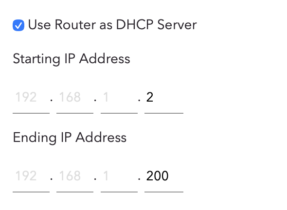

This address is outside of the addresses automatically assigned by the router:

I never had a netgear router, but apparently this model advertises itself as DNS server and you can't assign a custom DNS server on the DHCP settings page.
As a result, all your devices will query the router and the router will query Pi-hole.
This causes a bigger amount of queries coming from one single device (the router) and it triggers the rate limit.
You have 2 options:
  1. increase the rate limits values a bit.
  2. you will need to disable the router's DHCP server and Pi-hole as your DHCP server.
