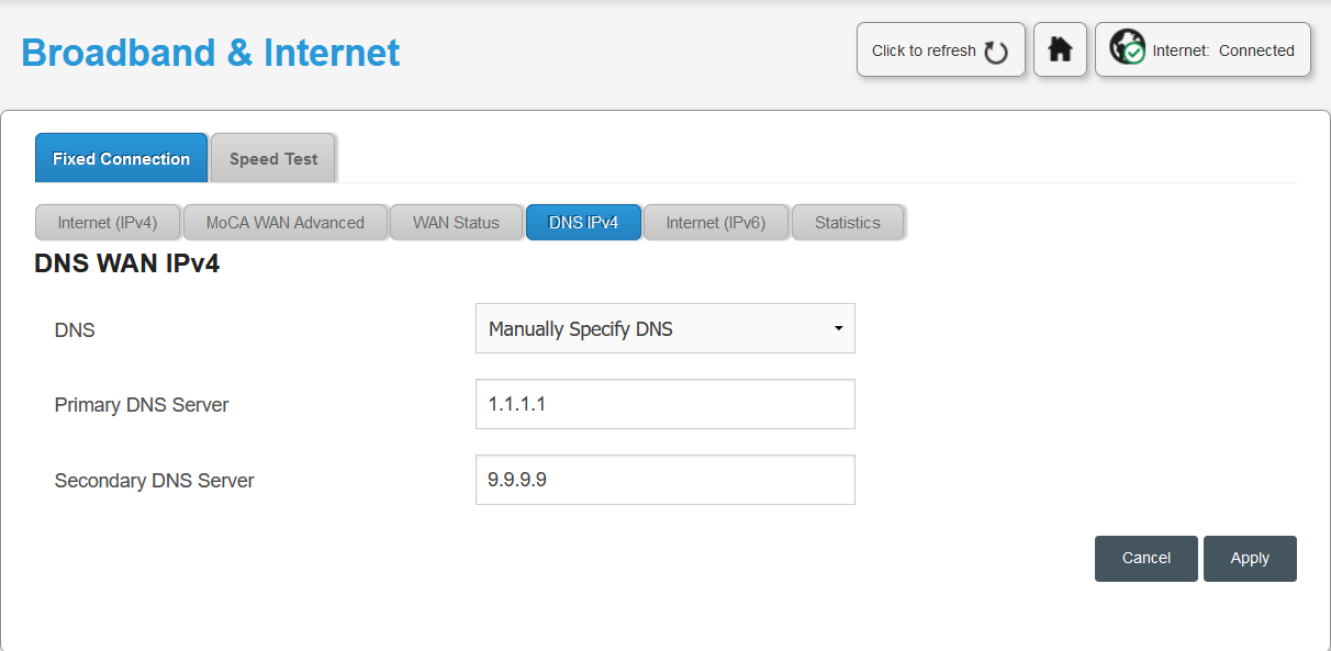

As soon as I point my router to use my pi hole it disconnects the internet. I restart the router and same thing again, no internet.
I put the DNS addresses back to 1.1.1.1 and 9.9.9.9 and it reconnects.
Ok so we know its something router related. Can you share a screen shot of the page where the changes are being made in the router?
Scratch that for a moment. I just noticed that your changing this on the WAN setting page. What does the DHCP tab show?
Note that the WAN setting is for your router itself. It is the address it uses to resolve things like NTP clocks. It can be what you currently have it set as. Your looking for LAN setting or DHCP settings.

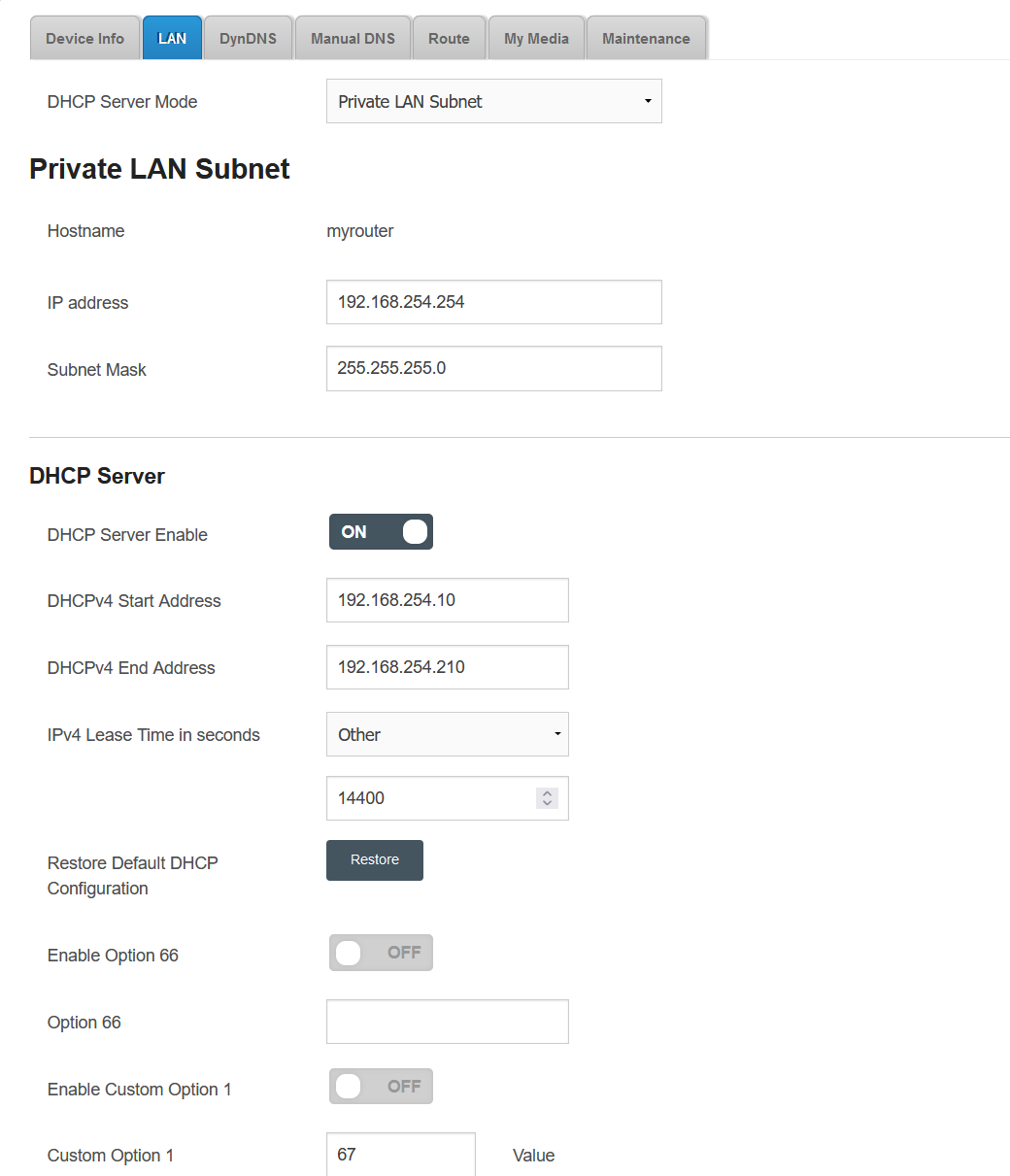

No worries. Under the DHCP tab that you showed is there anything below that area that says "customer option 1" looking for anything dns related.

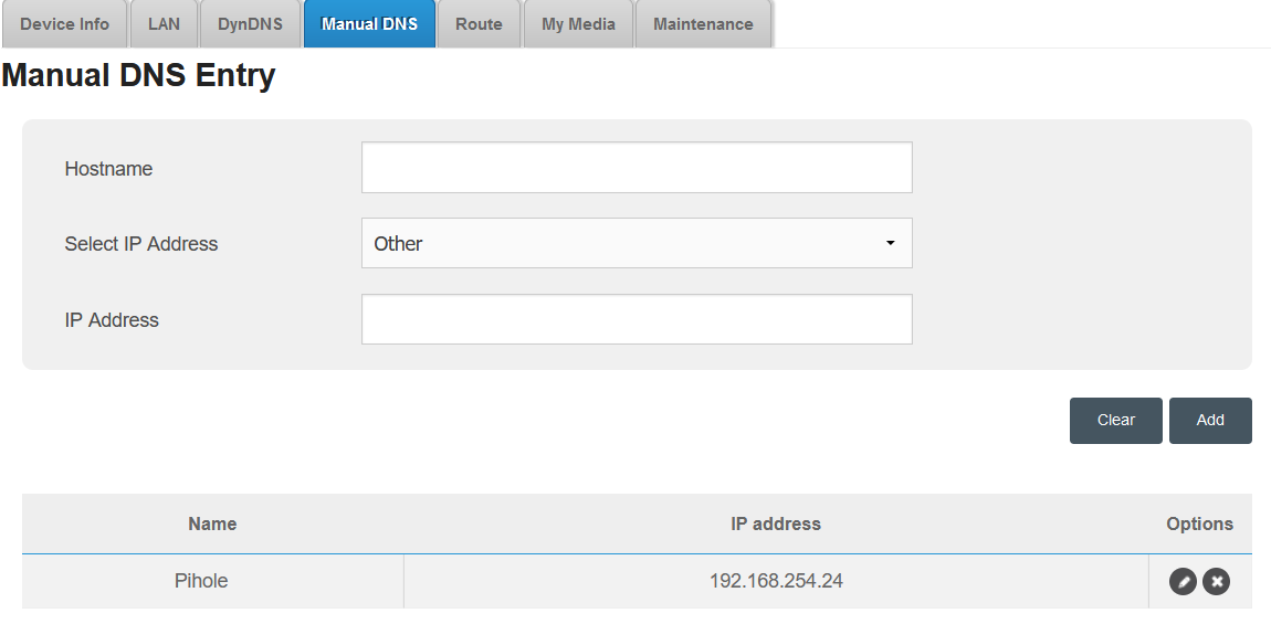

Also, a few tabs over from the "LAN" tab there is a Manual DNS tab. Is that the same tab as the WAN tab you first posted?

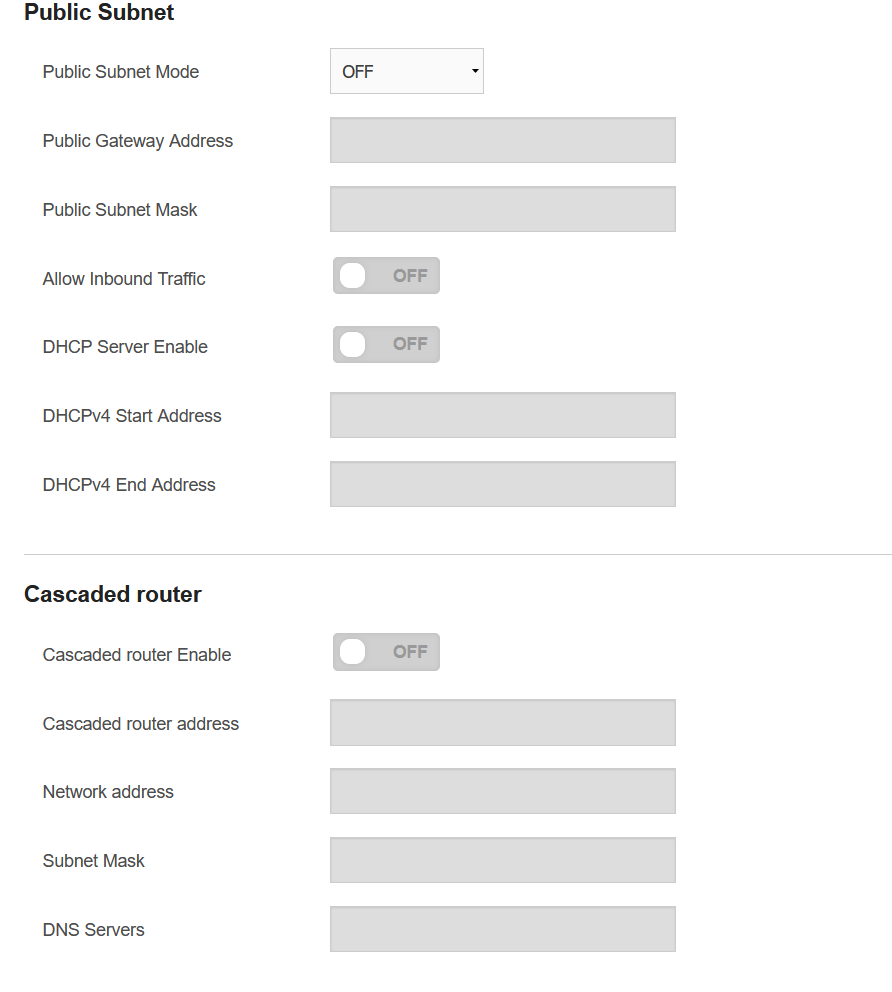

For your question under the DHCP tab those two pictures are what I get only unfortunately. The only thing I left out was a section for reserving IP addresses.
This is what is under the Manual DNS tab:
As you can see I already put the pi hole's ip address there but it does nothing.
