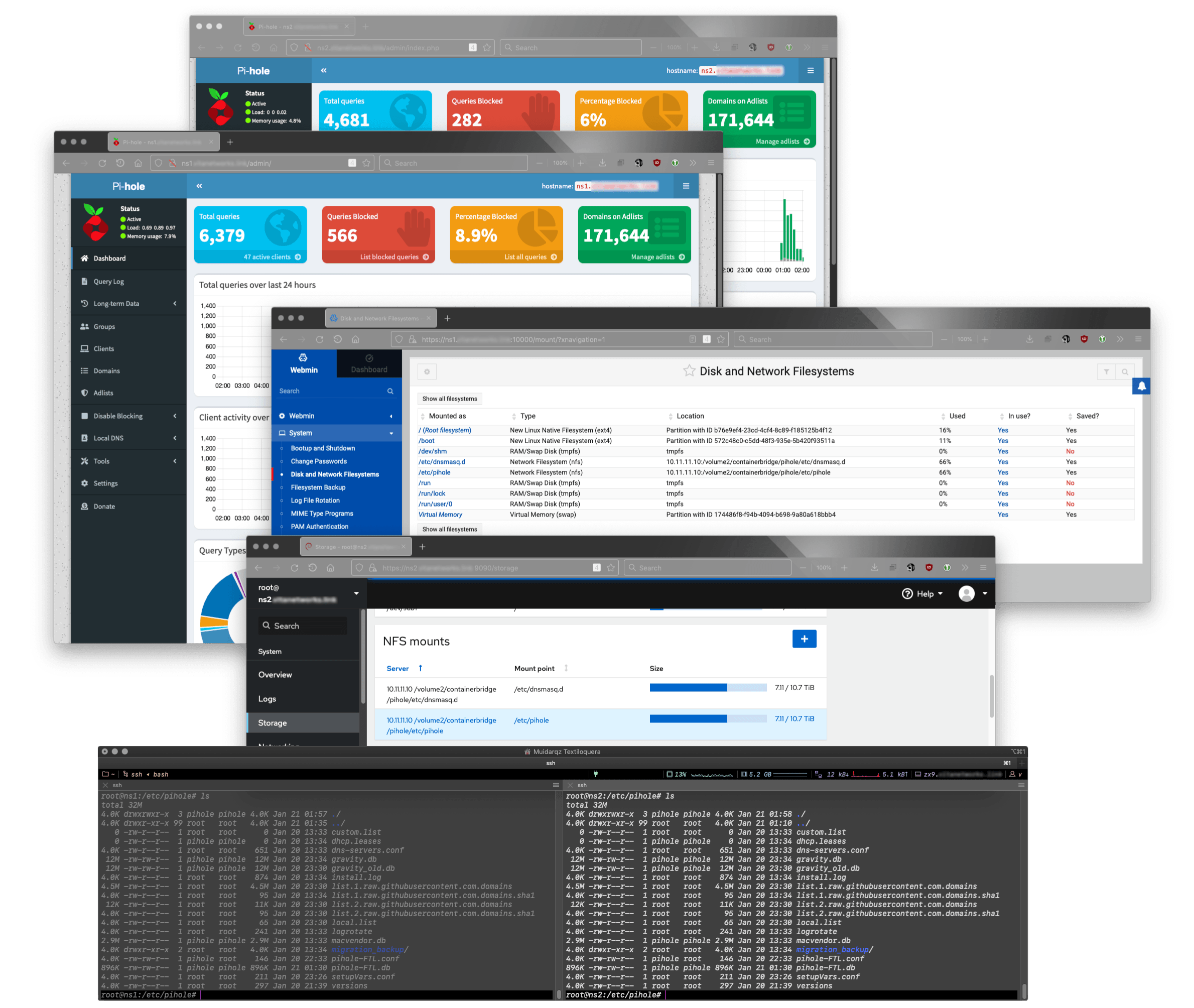

Why don't you just share the storage?
A while back I was doing this with Pi-hole on Docker, I just mounted the whole /etc directory to the containers. Data was identical on both yet they load was still shared between them.
This could be done easily mounting the appropriate /etc subdirectories on an NFS share; /etc/dnsmasq.d and /etc/pihole I believe. Then match user/groups IDs. If they are already created with different IDs, you could just uninstall Pi-hole, create the user/group manually with the IDs from another instance and reinstall Pi-hole, maybe double-check for lingering files before reinstalling. I probably would just go with it instead of recreating the user/group.
I do this for a ton of servers and it works quite alright, some of which are very picky in regards to permissions, httpd, nginx, Nextcloud and their PHP processes. Funkwhale or containers with special permissions such as Postgress'… you name it. No need for syncing hosts.

That occurred to me just now when I was inspecting the files, but I'll still keep it because it's not like it's mission critical information. I think these are workable caveats, for instance; whenever lists are modified, the config can be exported so if things get corrupted, you just restore it and it downloads back its data in a few seconds. Other settings appear to be in .conf files, so they should be safe.
And, depending what the goals are, you could work with some settings, for instance, set one server to mount NFS with sync on while the others with buffers, or read only. I just needed to distribute the load on some old very low power i586 thin clients, they're sol old and they had some ancient IDE SSD that NFS was actually a huge upgrade…plus some memory modules I scavenged from an iMac, they can even use all of it nor nowhere near the full module speed, but, if you add enough of them DNS resolution and filtering becomes insanely fast! :grin:
I didn't even had to sync user IDs!
