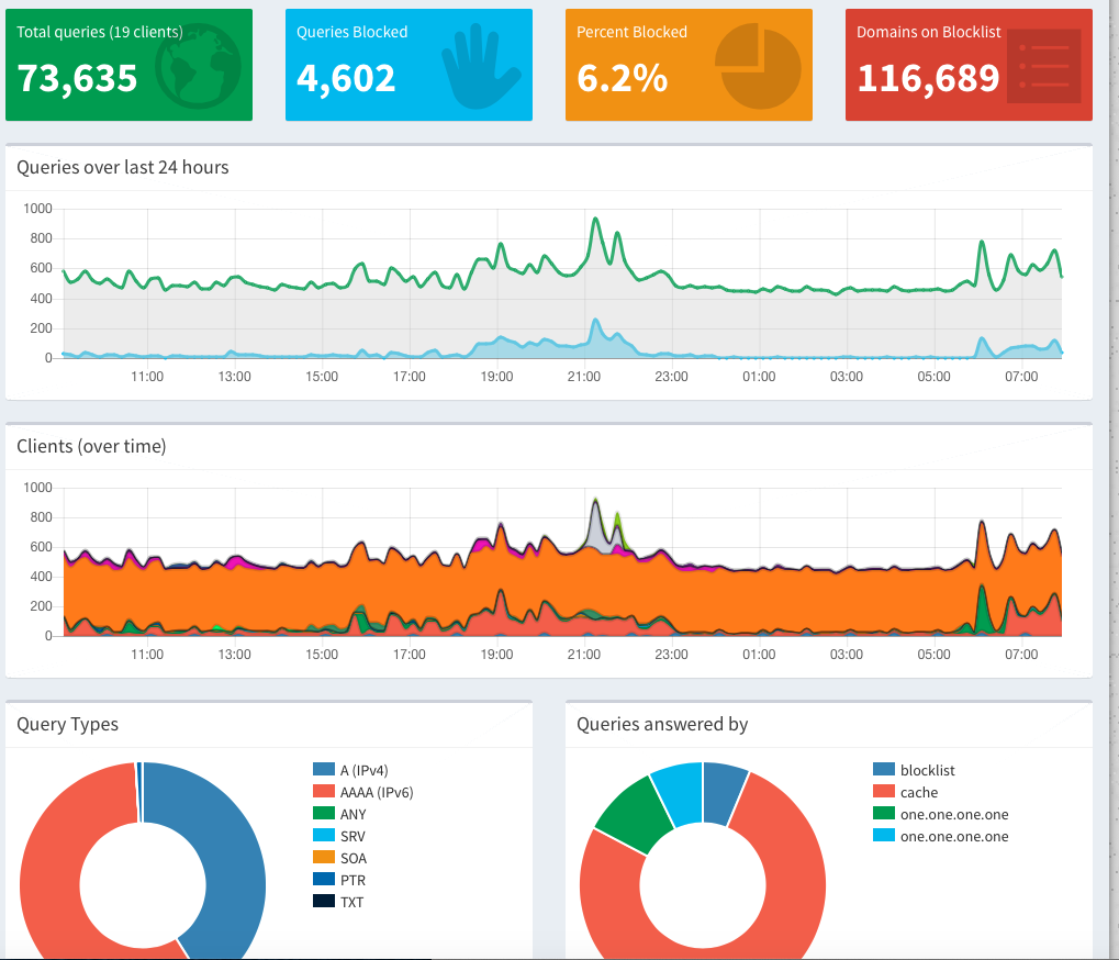

This screen shot is telling you that Pi-Hole has forwarded the queries to 1.1.1.1 for resolution after checking its blocklist to see if the domain should be blocked. This is a normal indication for Pi-Hole.
Hi Pi Hole community,
I am wondering if you guys know how to run an analysis of what devices are actually querying IPv6. I suspect that's why the percentage block dropped from 44% to a mere, now, 6%.

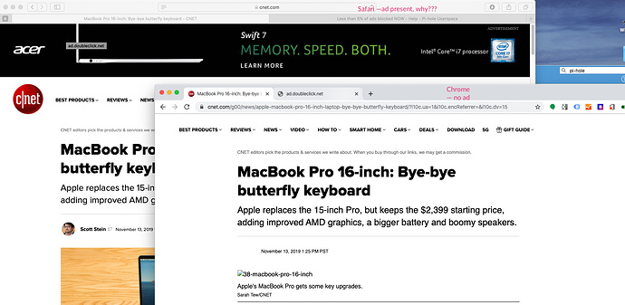

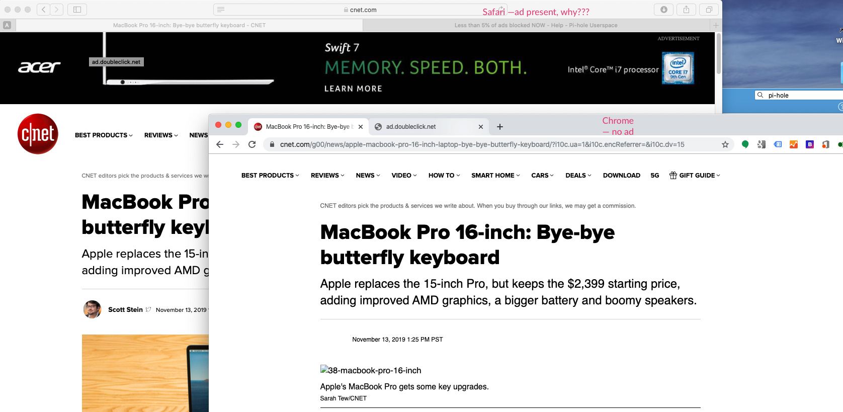

In the attached screenshot, Safari shows ads while chrome doesn't.
I cleared the cache in Safari thinking that it was a cache issue with the ad. No.
It seems to suggest that Safari has an ability to bypass and it's likely using IPv6???
I don't believe Safari has this ability. I use Safari as my regular daily browser and don't find any setting for this in the preferences.
The URL shown in Safari is showing the g00 domain, which is an ad-serving method run by InStart Logic. They serve the ads from the same domains (or randomly changing subdomains) as the content. In Pi-Hole you can try to block them with one of these regex (I don't recall which one works better):
* .+(g00).+
* (^|\.)g00$
It appears that you may have an extension installed in Chrome that is blocking these ads - perhaps uBlock Origin, uBlock Origin Extra, adBlock, etc.
