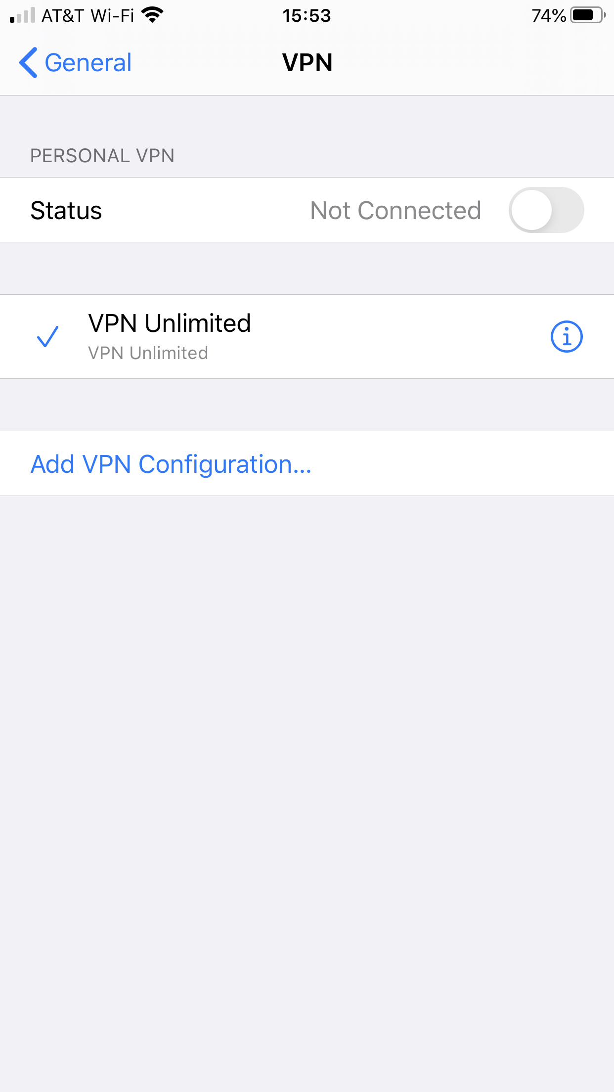

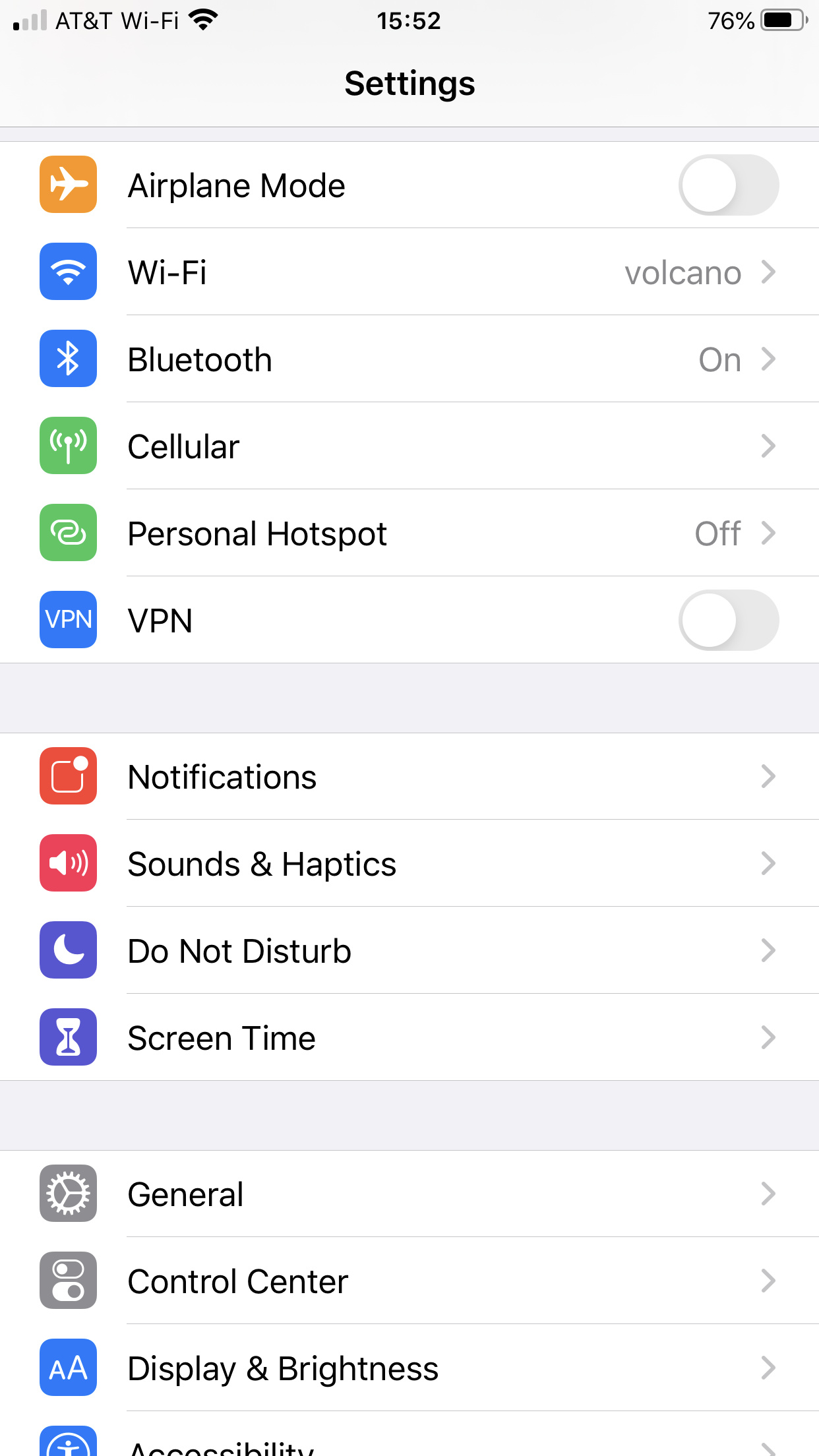

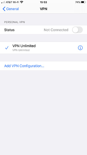

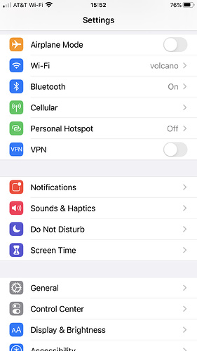

Have you verified that there are no VPN services on the iPhone?
There is no VPN on my phone at all.
