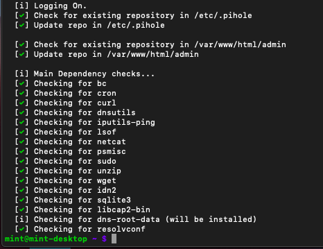

Install quits/crashes after "Checking for resolvconf" - failed to install dns-root-data in Linux Mint 17.2 Rafaela
That's what I've been trying to do, like having PHP installed ahead of time, along with other tools that were listed as "will be installed".
It looks like it checks off resolvconf, I get the "Installing packages" screen with the progressbar at 0% and than just land back on prompt like attached.
Does the installer create any logs I could dig into? (/etc/pihole/ doesn't have any, just the adslist.list file)
