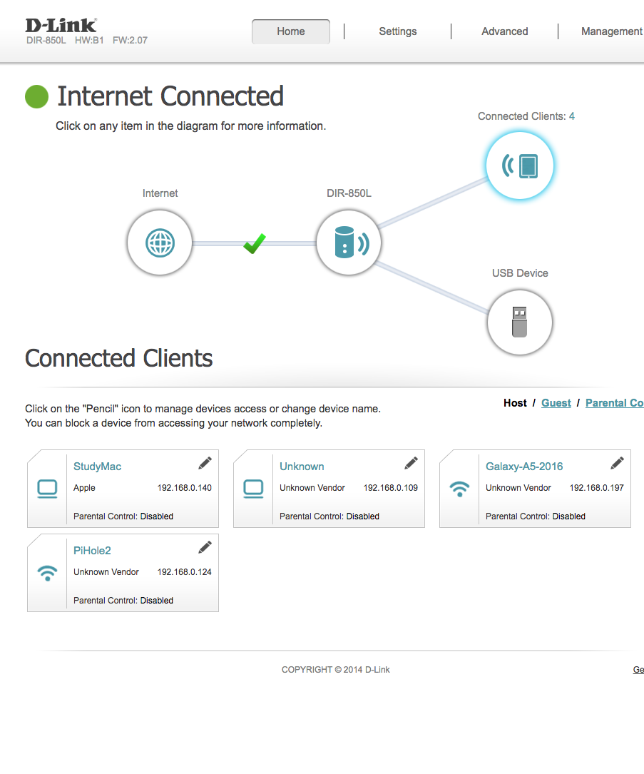

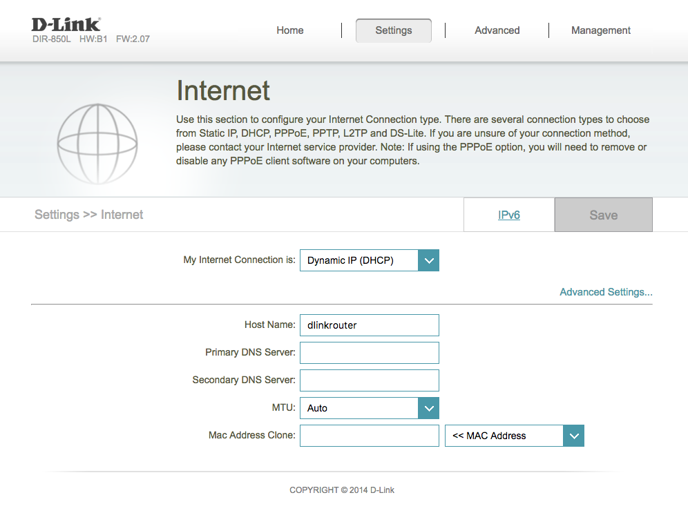

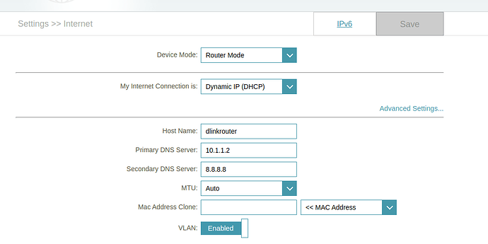

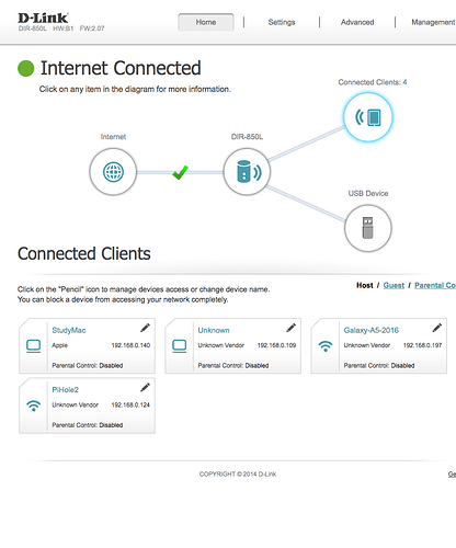

I have have made two instals of PiHole on two raspberrypi's - the first one is set up on an Airport Express router and I have changed the router's DNS to the PiHole and it works just fine. The second one is on a DLink 850 router and it does not work. I read many reports about the inablility to change DNS settings for LAN on DLink so I am just changing the DNS settings on my Macbook that's linked to the router through LAN
Can you post screenshots of the D-link "DHCP server" options ?
If it lacks the options to assign DNS servers to the clients through DHCP, alternatives are to configure all your clients DNS settings manually or ...

I've tried to activate the Pi-Hole DHCP server but then the Pi-Hole cannot access the internet due to the inability to set LAN DNS on the D-Link router. Now I have set the client DNS to the Pi-Hole server but ads are still not blocked alas!
I cant see the settings that are required to push a DNS server to the clients through DHCP.
Best is to use Pi-hole's DHCP service.
If you configure Pi-hole's "Upstream DNS Servers" to that of for example Google's, you circumvent DNS resolution via your router (take it out of the loop).

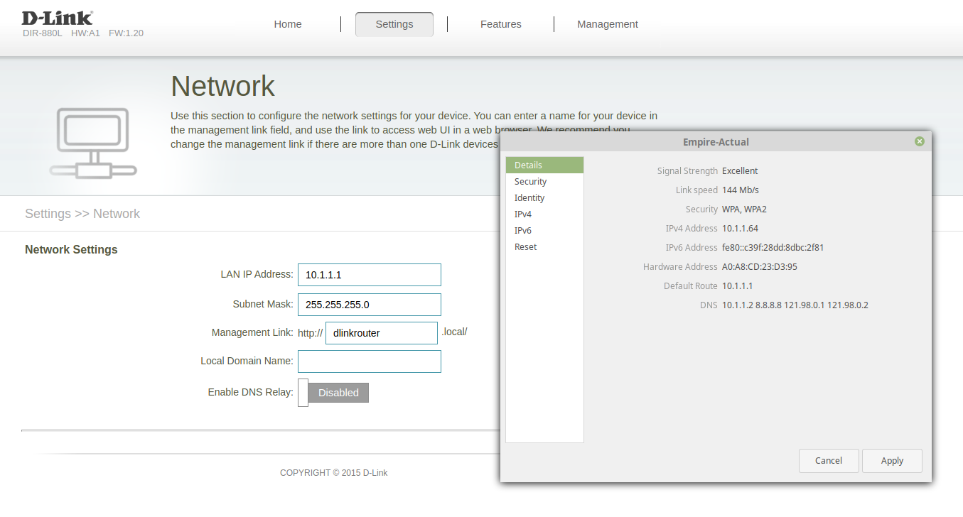

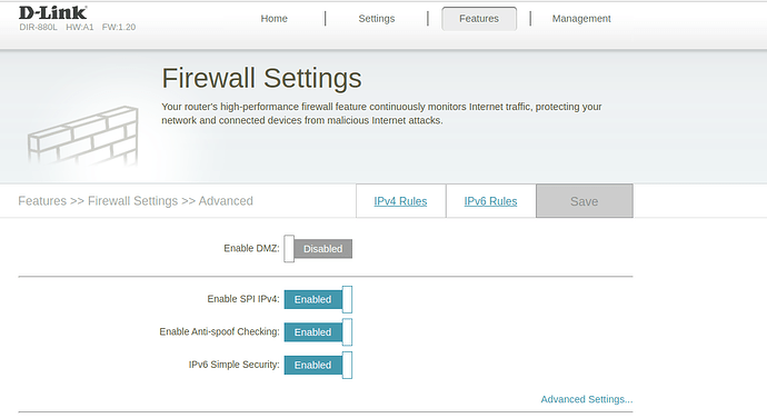

I can see this settings in your router "Enable DNS relay", not sure what that one does but you could try disabling it (for diagnosing) ?

Rebind protection - I guess that's what my router is doing - I don't know how to turn it off though, its a D-Link DIR850 router and I've seen many issues that people have logged with this router on pi-hole
Tried - with no luck
